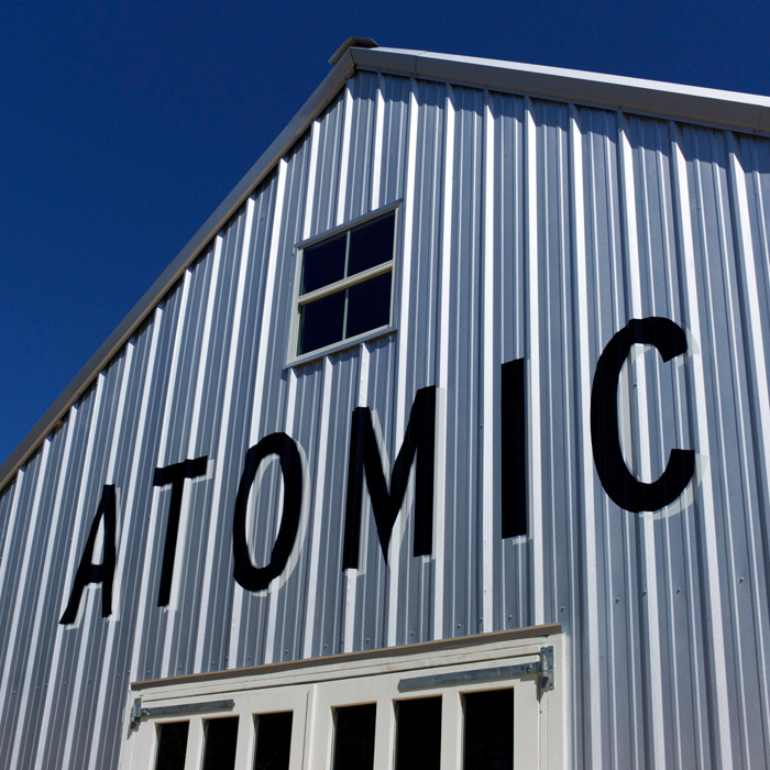

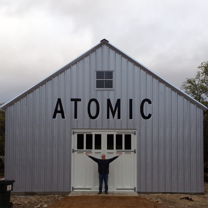

My good pal, business partner, and long time sign painter (Mr. John Mearns of Sign Source) was in town last weekend for the Lonestar Round Up car show. Despite the unseasonably cloudy and cold weather we had here in Austin, we decided to tackle my building with some brushes and 1 Shot.

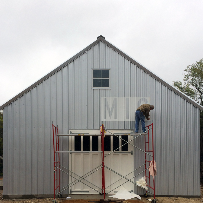

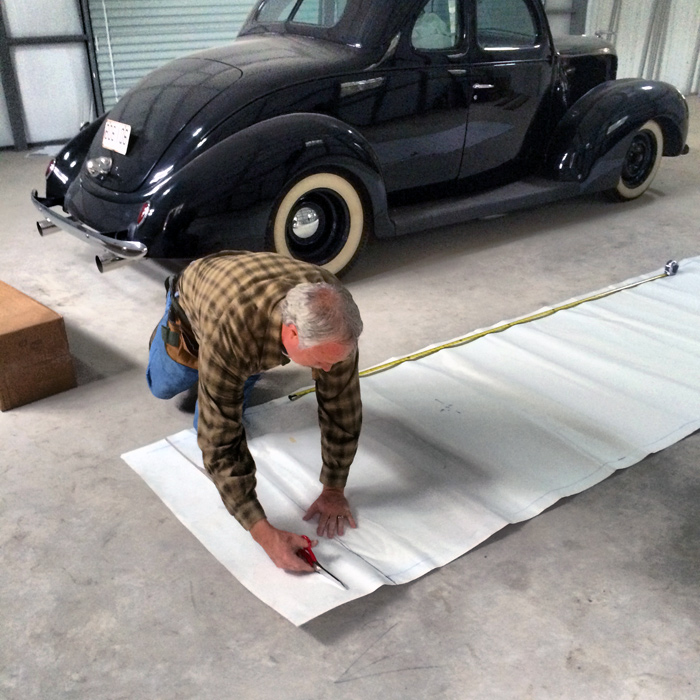

Sign painting is something I have zero experience with, but John is a 30 year vet and came equipped with everything we needed to get the job done. A week prior, I sent him a photo of my building, dimensions of the corrugation, and a vector file of the letters I wanted painted. From that, he was able to calculate the shrink of the letters caused by the surface area of the corrugation and create a vinyl mask.

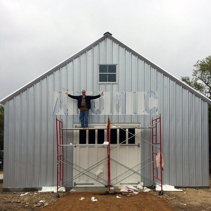

So, our first job was actually the toughest of the day – applying the vinyl mask to the building some 12′ up in the air while fighting a cold wind, legs that had walked the Round Up all weekend, and corrugation that made a smooth application damn near impossible. It took a few hours and a lot of patience, but after cutting the sign into two centered sides we were able to get it down and on the building. We did have a few wrinkles and a bubble or two (or 1000), but all was easily fixed with a little painter’s tape.

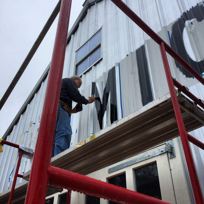

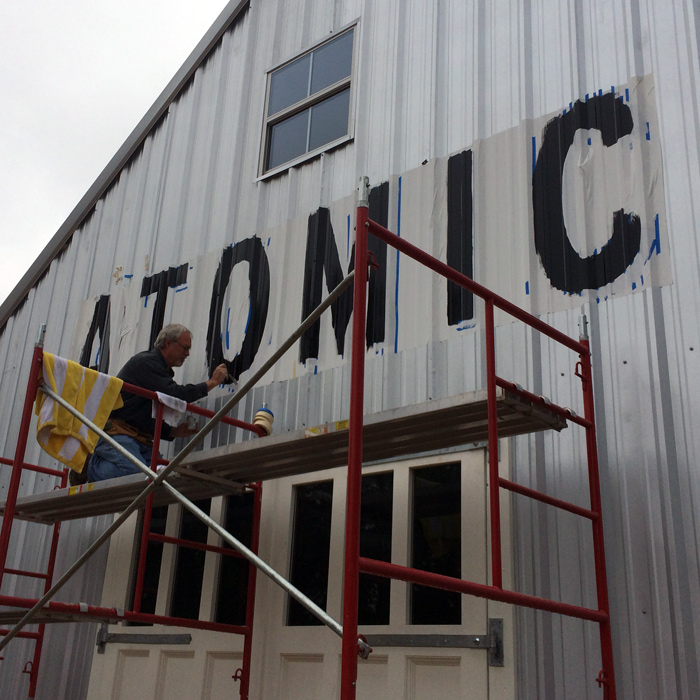

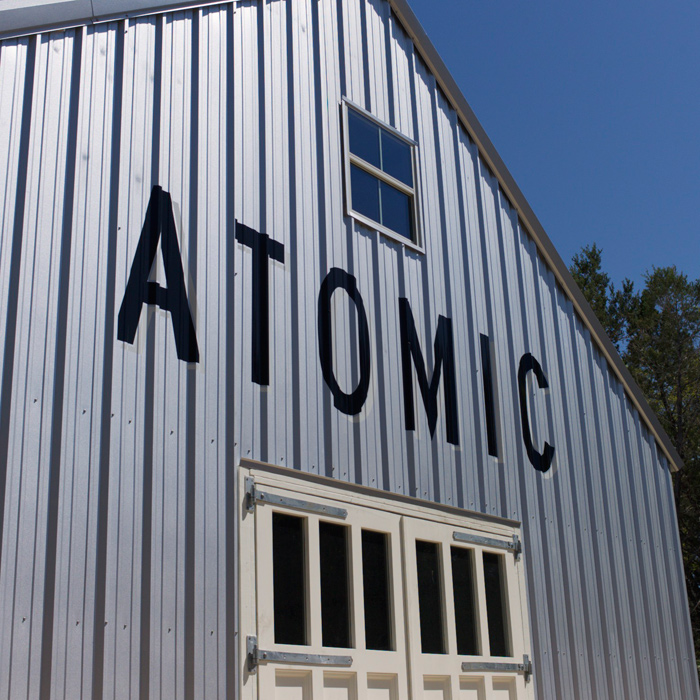

Once the mask was up, it was just a matter of mixing up some 1 Shot and brushing on the paint. Admittedly, we were freezing our asses off… But we had a ball anyway.

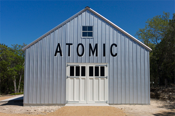

And the results? My brand spanking new building now has a little soul and feels as though it’s been here forever. In certain light, the white “drop shadow” disappears and in others it pops. I’ve been thinking about striping the white with a bright red pinstripe, but have decided to live with it for a while and see how it does.

Looks great especially considering the weather you had to work in :thumbup: I think I see where the car came from that's in your avatar.

Love it! I saw it on IG and was impressed but those angled shots really show the detail of the work - impressive.

I really like how the lettering turned out. Also like how you had to "calculate the shrink of the letters caused by the surface area of the corrugation". What exactly does 'Atomic' represent? I did some Googling but didn't find too much.

Very nice job. One thing though............as a sign guy myself, I would NOT stripe, or outline the white with any color. The dropshade that you have should be left on its own. I would bet that your sign painter would agree.
Just my thoughts. It looks perfect the way it is.

I learned something new. 1shot is not just pin stripping paint but sign paint. Also how to layout letters on a corrugated surface. Project letters on corrugated surface, measure side distance (stretch), layout on flat surface. Great work.
