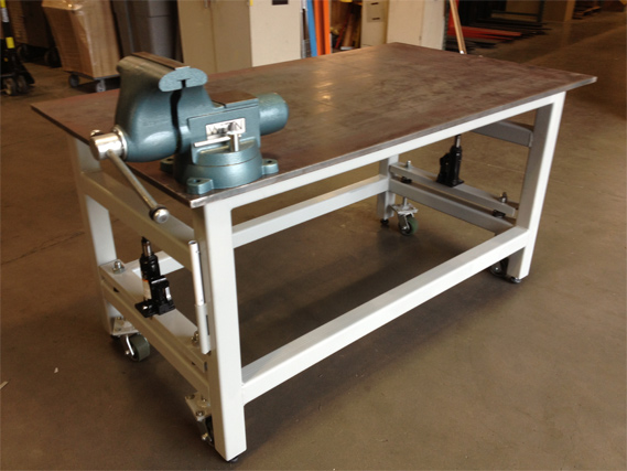

I love the idea of having a mobile, but very heavy bench for vise work and other activities that require a substantial work surface. And since I’ve been planning a new shop, I’ve been looking around at what others have come up with and stumbled upon the bench above. Genius.

I assume that the jacks are to lift onto the casters for moving under a heavy load?

Really cool idea! I'm thinking it could be "improved" to only use one jack, but might be difficult if it was loaded really unevenly for some reason.

Maybe I am missing something here. Care to elaborate?
The bench has adjustable feet to accommodate the uneven floor.
And for a 2 car, you could pull a car out and use it in the middle of the garage when doing projects...put the casters down and push against a wall when not in use. Thats exactly how i am going to use mine once i build it :bounce:

The wheels are not going anywhere when retracted. The jack is there to lower the wheels when you want to move the table.

No locking casters?
My luck I would be unknowingly working on an unlevel floor, give the jack the last crank to lift, and have a 4,000lbs table roll into the freshly restored corvette with me holding the jack handle! :)
Great job on the build, looks very professional.

Sorry but I don't see the need for locking casters since they are only going to be in contact with the floor when you're moving the bench. If your garage floor is that out of level you have other issues. I like it. It's a very creative design. :thumbup:

I like the idea of the jacks with casters and a heavy duty design. All nice and strong looking but the adjustable feet that they put on it look really small.
The design is incredible, really ingenious, nicely done. This will be perfect for a massively built table that requires frequent moving. I suspect that a great set of dollies and a floor jack would suffice if the table doesn't need to move that often. But there is no doubt that I will be building one (or 3) stealing this brilliant design in the very near future. Small bottle jacks are so inexpensive that to incorporate them permanently in each table is very easy. I suspect that the more you use this table that it's usefulness will only increase. It in itself it can be used as a giant table height dolly
I also questioned the strength and stability of the adjustable feet. If the objective is to be able to beat on whatever this table can hold, the adjustable feet may prove to be the Achilles Heel of this otherwise inspiring design.
To incorporate adjustable feet suggest that there must have been a requirement to level the table on uneven floors. In recognition of that a suggestion to improve the stability would be to manufacture your own adjustable feet. I have done so many times using 3/4" bolts and hockey pucks for feet. Leave it to the Canuck to recommend hockey pucks in the garage, but they work exceptionally well. They are incredibly stable and provide great vibration and sound dampening. My compressors and a variety of other machines have had their adjustable feet replaced with hockey pucks.
Counterbore a hole in the hockey puck to accept the 3/4" bolt, and finish off the opposite side with a fender washer and nut. The design is extremely durable and will withstand huge loads, but it will add significant height to whatever it is supporting (approx 2") which should be considered in the table height.
Again wonderful design and certainly no disrespect intended with the suggestion for beefier feet. You had me at "heavy". Thanks for sharing.

What wall thickness is the movable horizontal piece? I imagine it'd have to be at least 3/16" to prevent it from bending out of shape.
Are the bottle jacks permanently fastened or just put in as-needed?
I am planning on stealing Steveo's bench design but with 2 HF 44's, now I am going to add the jacks and castors. What a cool idea for a sturdy but still mobile bench.
Aren't you concerned that the unsupported middle section may break when jacked up?
