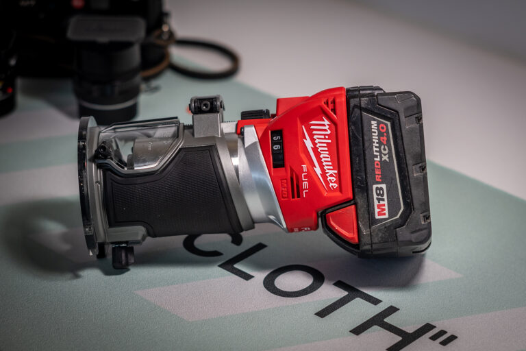

I’ve always used the classic Bosch Colt as my palm router of choice. I like it because of its power to weight ratio as well its user interface. It’s a simple motor with a collet and a platform that is easy to build jigs for. However, I left my Colt at the APO and needed a new palm router for the Atomic Lab. Why not try something different?
Enter the M18 Milwaukee router… I bought this after my less than glowing experience with the M18 palm sander thinking that I owe Milwaukee a chance to redeem itself in my shop. They did… this thing rules.
I don’t want to get into a full review as there are plenty of those out there, but from my experience what makes this thing great is really, really simple – It’s just the perfect application of the cordless format. I don’t run a palm router for more than a few seconds at a time and rarely do I use it for more than 15 minutes or so total in a day. Battery capacity just isn’t an issue in my use case.
What is important to me, however, is usability and removing the cord from a palm router just makes things that much more convenient. I feel like I can get into far more tighter circumstances with this Milwaukee than I can with my Colt.
It’s just a bonus that this thing also seems to be really powerful. I’m impressed… and if you’re on the fence, I suggest you jump off.
You can get these things anywhere really, but the best price I found was eBay… Not sure if this is some grey market deal or not, but the price is hard to beat.

How do you like the base plate of the M18 vs the colt. I like my colt but not overly found the the baseplate shape??
How much free play in the adjuster, my colt is terrible in that regard. I guess its not really that bad if you remember to go back one way and then advance it the other just a pain where my big milwaukee router has very little.
Also does it come with an edge guide and is of decent quality?

I'm not picky about baseplate shapes... My colt was fine... and this one seems fine as well.
Free play. Far less than the Colt... I haven't used any other modern palm routers, but this one seems to have tight tolerances.
It comes with an edge guide... It's the expected stamped steel one that most routers seem to come with. Not special at all...

So, how is the base? For adjustments? They easily stay 'locked' in, and easily changed? Seems my old colt, the base/ adjustments is kinda cheezy, really have to tighten the snot out of it, and remeasure, as it could/ does shift.
On the other hand, my big p/c whatever model it is (690?) big bosch, big milwaukee, all corded, easily lock and stay in position
IMO as a casual wood butcher the adjustment is 400% better than the colt. Solid as a rock and easier to dial up.

Nice to see a trim router with a dust shield/cover. I recently used a Ryobi cordless trim router at a shop I work on and off in, the balance wasn't great(not only top heavy,but tippy as well), so I used my left hand on the base as I do quite often with a corded trim router. I was quite surprised at just how close my fingers got in relation to the bit. For the record ,no skin/blood loss as I did NOT harm myself. It just made me take notice, and probably made me dislike the router very quickly. The really bad part was I had a chamfer bit in the router and immediately changed to a different router after installing the bit. I asked a few guys at the shop if there was a plastic guard/shield that just didn't get installed but no-one had knowledge of such. Looking at the pictures on line I did not see anything included by the mfg.

I have many, many routers, and the M18 is what I actually use most often, because so much of what I do is extreme light duty, short duration work. For example, I used it yesterday to cut a kerf in the bottom of a door for a door sweep.
Before that it was routing out hinge recesses, or putting a quick round-over or chamfer on something.
It’s pretty bomb, agree with Ryan, get one if you are already in the M18 ecosystem… I just wits they made an M12 version - I could use something even more light-duty.

I'll be replacing 15 doors in my house next year and I want a palm router to cut the hinge and latch mortices in. The 1¼HP Bosch GFK125 has been my front runner. It's $10 more than the Rigid.
This M18 Router is the only tool I've seen that has really tempted me to add a second battery platform to my arsenal. Reading these positive reviews is only making it more difficult to stay the course. As you mention the Colt is 20 years old, I assume you're referring to the 1HP and not the 1¼ , correct?
