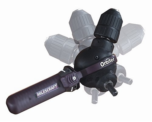

I had this hole that I needed drilled in a spot that I simply couldn’t reach with my drill. The answer was to either completely disassemble some framing or look for one of those gadgets that gets you where you need to be. I decided to give this Orbiter gizmo a try… and it worked. I wouldn’t say it’s built all that well, but I will say that it gets you and your drill bit into some extreme angles with relative ease. And it’s only $28… Case is still out if it’s a good value (long term) or not and I’m not at all a “gizmo” guy, but figured I would feature it anyhow.

Those work well for low-torque applications, but the entire housing will crack if subjected to too much force...

I always found these things a poor substitute for a right angle drill.
I think these types of adapters are kinda dangerous. You have this on a pretty strong drill, it can be a wrist breaker.

The vintage jobs are nice... and probably built way better than this Orbiter deal... but the Orbiter gives you any angle you want - not just a 90-degree or a 45-degree...
It works really well... until the cheap Chinese gears strip and the thing becomes a paper weight!

I have one of these, same one in the photo, it works ok if you stay within the stated diameter limits in the directions, which isn't very big. If you try and use spade bits or hole saws, it's a wrist wrangler like stated above, and the gears strip. I learned that the hard way, stripping mine on the first job after not reading the directions. A homeowner quality tool, if that.
