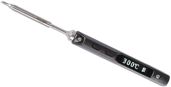

This is not a paid endorsement. I don’t know anyone involved with this thing and paid for it my damned self… But man, is this thing great.
A few months ago, I was building a keyboard and a friend suggested that I pick up one of these tiny little soldering irons. I looked at it on Amazon, thought it looked like a toy and moved on. Then, I started noticing a lot of people recommending them. Finally, I succumbed to the peer pressure.
This is the best soldering iron I’ve ever used. It feels like a pen in the hand, gets to temperature quickly, and gets to temperature accurately. It’s literally the best soldering iron I’ve ever used.
Check it out.
See Comments on the forum.

Interesting. It's the right voltage range to work with ~18 volt cordless batteries, laptop power supplies, and 24 VDC. Looks like it'll even do light work at 12 V.
Looks like a good option for mobile work. Especially if flying where butane is a PITA to deal with.

yours appears to be a 'rebrand' of the TS100: https://hackaday.com/2017/07/24/review-ts100-soldering-iron/
fyi, it's designed by mini
note that there is a newer version called TS80 that is powered via USB-C (QC3). it's also lower wattage, but it seems to perform similarly surprisingly (though warmup time is slower). they each have their pros and cons.
the firmware's open source which is kind of cool
nice iron, i agree. i've wanted one for a while.
You are 100% correct about it working with the 18V level batteries. Tested released a video on Youtube making a portable solder station using this iron and a Dewalt 20/60V flex volt battery. I believe the larger battery was used for runtime.
He did say that the connection to the adapter block drains the battery constantly even when the tool is not in use.
Looks like he's using the 12v heated jacket port which will run the iron at reduced wattage according to the specs. And by the looks of it yeah it will have some standby power draw. Being off brand it's possible it'd draw a battery low enough to kill it if you left it attached long enough.
What I had in mind was gutting one of those adapters to use it to connect the iron directly to ~18V battery voltage. That should run the iron at a decent wattage. Shouldn't have any standby losses with the iron unplugged but you would have to keep an eye on the battery gauge during use.
