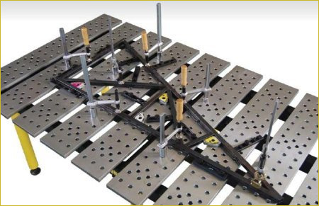

I’ve always wanted one of those bad *** welding tables you see in super high-end fabrication shops. I figured they were… well, fabricated by the folks that use them. Apparently, that’s not always the case. The above is Strong Hand Tool’s BuildPro Welding table. It features a top of  ground-steel 5/8″-thick plates that feature CNC-machined 5/8″ through-holes spaced in a grid every 2″ apart.   The table is flat to within 0.004” per foot and the hole spacing is accurate to ±0.0015″. The whole damn thing weighs close to 600 pounds and will set ya back over $2000.

That is only a welding table of my dreams. I wish I could afford one of those.
Looks like you could clamp just about anything to it to jig up,.

Man, I think you'd have to run a tap down those threaded (they are threaded, aren't they?) holes a lot. Plus knocking off all the dingleberrys on the surface, I don't know.

You can get a 5x5 platen with stand new from Acorn for about $4,200 to your door. The 5x5 platen is right at a ton, so bring friends or a forklift.
But the clamps are $50 to $100 EACH, so it does add up fast! :shocking:

Not sure about the table pictured but on the high-end tables the holes are not threaded. When you turn the lock screw on the tooling, balls push out the bottom and lock it in from underneath. They also have blank plugs to pop in the open holes once you're setup. The different shops I've worked at have always had spray cans of anti-splater, spray down your platen and fixtures before starting and you're good to go. Stuff works great.
