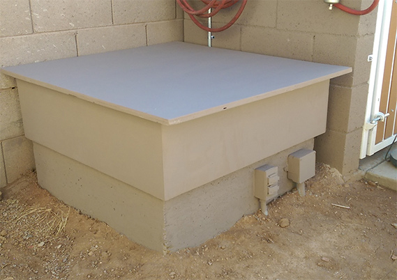

I was farting around on the internet the other day and ran into a pretty smart outdoor compressor enclosure that utilizes a smart muffler of sorts.
You can see the details here.
It’s a hell of a lot of work for a cheap pancake compressor, but the idea seems pretty sound to me.
See Comments on the forum.

That's a pretty elaborate set up for that baby compressor. Nice though. Hopefully no water ever gets in there and he drains it frequently.

That is what I was thinking too. Would not work for me for sure with our humidity. I don't think that is a pancake. Seeing how deep he dug it it is probably a vertical 30 gallon or so. Makes more sense about the size and noise he described. I would hate to lift that in and out, especially with about 10 gallons of water in the tank.

That oiless compressor is doomed to death by overheating. That is if the light switch he's feeding it from doesn't burn the house down first. If he lives in a climate that has winter, the filter dehydrator will burst the bowl the frost time it freezes, too. I also can't believe he spent all that money and time for that little compressor.

Overheating may be a problem, he's in Arizona, Freezing not so much I would think.

For the amount spent on that hole, he could have bought a 2 stage with a low RPM pump that puuuurs.

Pretty neat.
Compressor is under ground
Ground cools the block
Block cools the air
Air cools the compressor
It says in the article its been running that way for 12 yrs, that's pretty good.

I worked in a shop that had a compressor in an un-ventilated closet! I mean 4 by 4 closet! Took about ten yrs for it to finally have an issue. And it could have more from neglected oil changes than heat.

Did you look at your compressor? On my antique craftsman the main sheave has a fan built into the spokes. I don't think you'll have a problem, plenty of air circulating around it.
The top to my enclosure is open. Given my low duty cycle, the thing barely gets warm, so I think I am OK. I could always install an aux fan somehow.

Love the concept. As mentioned there is definitely room for improvement. I'd also be concerned with ground water issues with drainage. But overall I think it was a great idea and it hides the size of the compressor well. Looks to be about a 30 gallon compressor.

I saw a similar concept at a family friend's shop. They used a large pre-cast septic tank and put their compressor, h2o booster pump and h2o pressure tanks (house & shop) in it. Definitely cut down on mechanical room space in both their house and shop.
I would definitely have some concerns regarding condensate draining and overheating with this particular build, especially in Arizona, but the concept is pretty cool.

While all concerns about heat and tank drain are certainly valid, in Arizona, away from bodies of water the humidity averages what, 12% ?
I'm not justifying his not addressing a remote drain in the article, but a simple auto drain, plumbed out of the box would cure one of these concerns.
While I fully agree with the idea of buying a better compressor, I can't fault his idea of improving what he had.

At least one cinderblock compressor room was seen slowly imploding due to the vacuum the vane compressor inside it was producing. Customer was complaining of low air production.

Probably not a huge issue in AZ, but I know if I dug a hole in the ground that deep with no drainage it would end up with water in it before long, and it would be a ***** to get out. All other issues with this install aside, I think I would have formed a sump area somewhere in the bottom with an automatic sump pump, then coated the interior with Drylok or other waterproof coating. Like I said though, that may not be a problem in AZ, but I know there would be multiple issues here in the Northeast.

Not to bring back an older thread, but an associate called me yesterday. He said the State Inspector failed one of his compressors for having an "inaccessible drain line". Apparently the OEM condensate line comes down the side of the receiver to an autodrain his people installed. The inspector failed it because that line is facing the back wall of the boiler room which is only 2" away. This made mee look up the OSHA regs for pressure vessel installation and I found this:
"1910.169(b)(1)
Installation. Air receivers shall be so installed that all drains, handholes, and manholes therein are easily accessible. Under no circumstances shall an air receiver be buried underground or located in an inaccessible place."
I know this guy isn't overseen by OSHA at his house, but I wonder if this enclosure would be considered "buried". It's definitely inaccessible without removal form the pit.
