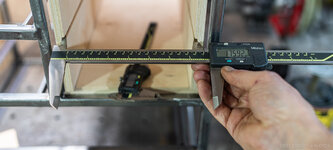

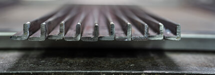

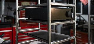

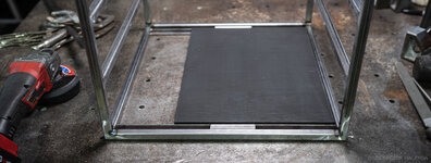

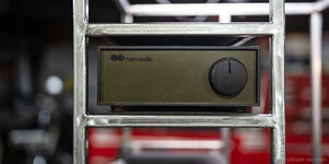

Shelves. Suspending the gear inside the frame and leaving space for airflow.
1/8" wall 1/2" angle iron. I generally hate working with hot rolled steel anymore. Feels so... dirty. The saw still had the stop set from the fore/aft bars so I just went for it. After measuring three times and test fitting one cut of course.
I was trying to center up the bracket and got lucky that it was exactly 5/8" spacing from side to side so I just tossed in the two off cuts I used to size the front openings - I wasn't trying to be perfect here but close. The amps will be able to move slightly to center up and the feet should have a few mm either way. I've tried to give spacing to everything so that there's enough gap to absorb any errors... while trying to prevent any errors.
I tacked in the tops and because the first shelf was on the table it was already flush.
It worked out to 38.7mm for the first shelf and so I used that measurement as I went up the rack and of course test fit each shelf to be sure it was snug and could slide front to back. The actual MDF shelf was my square.
That's one of my garage sale clamps from earlier this summer - a whole box of them for $5 or $10.
The shelves are ever so slightly higher than the main frame but I think that's the veneer thickness - so maybe 1-1.5mm which isn't a big deal.
So the shelf brackets are all welded in now. You can see how the shelves don't extend to the back and that space is for the copious amount of interconnects involved in an active system. Honestly with most hifi's actually. At this point I realize I have not yet pulled an amp or pre to test fit - it would be heart breaking to have made some dumb error so I'm really hoping that all my measuring and remeasuring and triple measuring is correct...
Typing that sentence makes me realize I need to pull a HiCap and test fit it.
Now.
Hang tight...
Phew!
Some of the amps feet have been squished from being stacked so I've ordered two different durometer replacement feet from McMaster and will test fit and shim or skim them so that I get consistent height on all the boxes.
But this is a huge relief - it fits!
I love the way there's all this space for interconnects - it's something that has bothered me about hifi gear forever. Once the outer panels are in place all wiring will be contained within the frame. It makes me wonder if I should do a simple mesh frame for the back but that part will always be against a wall. No need.
Seeing that amp in there makes it feel real all of a sudden - this is exciting! I'm so glad I picked this project.
Next: outside panel fitting.

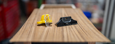

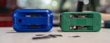

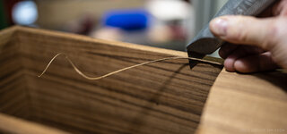

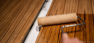

As far as I can tell there's only two trimmers. The green one I got 10 or more years ago from Woodcraft and looking online it's available from multiple sources in different colors. It has four blades - or six actually - two for trimming the excess and two for beveling the edge. It's worked... okay. Considering the age I wanted to change the blades and found a set in a drawer - but they were the wrong type.
This is why I wanted to change the blade. When I went to the store to get the correct blade I realized that the extra's I already had were for the Fastcap trimmer (the blue one) so I bought that too so I could see which worked better.

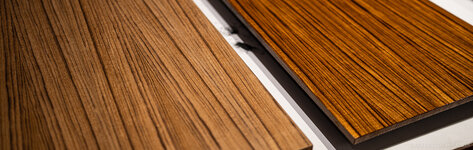

Maybe it's my edge banding - adhesive backed birch - but the answer was neither. The Fastcap has only two blades so it doesn't attempt to bevel the corners. It's marginally better than the green one. I tried the router table and it got gummed up by the adhesive so there's no good solution.
I've conclude that all of those edge trimmers ****. I have the Fastcap one and at some point I found some carbide replacement blades for it that worked marginally better, especially if it I kept it clean with Acetone, but it still wasn't very good. I've found a small router with the smallest 45* chamfer bit works the best. Festool even makes a router specifically for this. I have a tiny rigid that I got from my dad. It's my only non-festool router, so the trim bit lives on it and its dedicated to that task.
I don't know if you can get them over there but the ceramic bladed STAR-M cutters are the best I've ever used. They just peel off a perfect edge like a dream (used them today!) They are small and double sided to fit into small corners and they have different chamfer sizes too.

If you went to art school you know the RotoTrim. A staple of every art room and graphic design studio. They were expensive back in the day $3-400 and no one ever sold one so the only option was to buy new. I've owned this for almost 30 years? It cuts paper and veneer as well now as it did then. Nadia uses it all time. I love perfect tools.
I love my RotoTrim. I lucked out back 40 years ago. My girlfriend worked in an art store. They were upgrading the RotoTrim for a guillotine style. The store owner sold me the RotoTrim for I think $20 and threw in a new cutting wheel. I've never had to replace the wheel.
I cut styrene all the time. Didn't think of cutting veneer with it. Great idea.
Yes, you *******, you can get them on Amazon (of course) and I'll have it by Wednesday. I'll hold off edging the outer panels until then. I also found a strange rotary trimmer to try. And I do have the Festool OF700 which is what I generally use but it's a whole deal to take out and set up. But in the name of finding the best edging tool... we will try them all Wednesday.

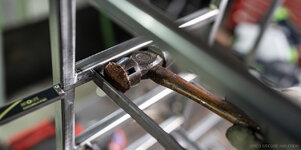

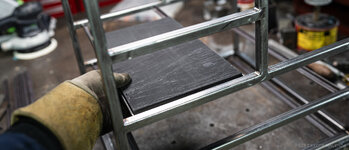

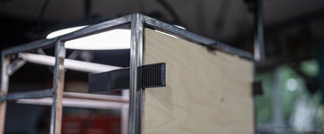

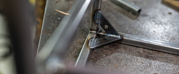

Corner brackets.

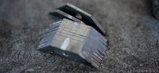

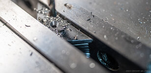

I bought some 1/8 steel bar that is 1" wide and then set up a stop in the cold saw and cut a bunch of brackets. I tried just clamping them as a stack to drill them and of course that didn't work (variation in size so the vise didn't hold) so I had to weld them all together.
And then drill them and then grind them. I went with a 7mm drill bit so that it was a little oversize for the 1/4-20 threaded inserts so I have some wiggle room. The feet were going to be 8mm and I hate mixing formats... maybe I'll change them. Not sure.
I ground off the welds and beveled the edges.
In order to make sure the panels stay flush with the frame I slapped some edge banding onto a scrap of the 1/2" MDF and then rested the bracket on that and tacked that in. This ensures that the stack is correct and the panels will be flush and even.
Then I'd remove it (I might have forgotten once or twice) and weld in the inside edges so that the outside had no bead... which, now that I think about, is probably not really a worry given the gap.
Considering where my welds were when I started this project I'm please with my welds now. Back in the groove! I have better control of heat and my beads are consistent. I should have started this project in the middle.

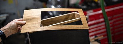

Next up I test fit the panel and used door jam shims (so glad I kept those extras!) to get the spacing as close to even as I could. I'll get that even and then mark centers on the holes and drill for the inserts.
Overall it's pretty even. One edge is slightly less square - either the stand or the panel. Less than 1mm on the long edge so not bad. Once the frame is painted black the gap should help absorb any errors. Next is the threaded inserts and get the panels set. I might need to make them directional as I didn't try to flip the panel to see if that would cancel any errors.
I'm pretty pleased so far. This is fun and I'm happy to be back in the shop.
The pressure is on! 😅 I hope they work as well for you, I started to worry that Japanese edge banding is pretty weak sauce. The Amazon price looks quite reasonable at least, what chamfer size did you get?
I think I went with the .6mm one which seemed most reasonable and shipped quickest. If the edge banding is 1-1.5mm then that should be a generous bevel.

I've really enjoyed this thread...thank you @sakurama for documenting and sharing so much!
A tip that might help in the future with gang drilling that might save you some welding: put a couple short pieces of aluminum welding rod between the moving jaw of your vise and your stack of parts. The aluminum will compress enough to make up the small differences in part width to hold everything securely. I forget where I saw this one, but I have used it several times and it works well.
S
sakurama
Oct 10, 2010
1,458
Portland - the cool one.
Holy cow… you’re totally right and i forgot that trick. Damn it. Not enough time in the shop. Thanks for the reminder.

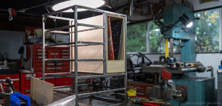

So I thought I'd be able to do this in a week or so and we're clearly into the "so" part of it. But it's put me in a much better mood so that's good. This was my week with the kids and so my shop time was limited and I lost two days mounting fenders to my gravel bike...
So we left off preparing to mount the panels.

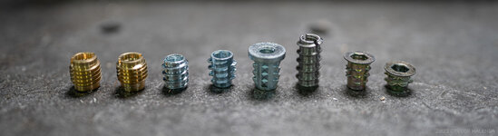

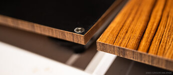

Threaded inserts...
I'm asking you to remind me to never use MDF again. If I start a project that in any way uses MDF stage an intervention. For the shelves, which have no mechanical aspect other than transferring force into the steel, it's fine. That's what the turntable shelf did too. And acoustically MDF was great for the turntable. For these outside panels... not so much.
I have a collection of these threaded inserts and don't really like any of them. Because the panels are 1/2" I'm limited. The far right is the only one that is the correct length but I could grind or machine the others. I tested several and in MDF none worked. They all either pulled out or chewed the material.
Before I gave up I drilled a couple 1" holes and glued in some softwood dowels to see if I could make that work. It didn't fare any better but I tried the inserts into some baltic birch scraps and of course that held.
I had a half sheet of 1/2" baltic birch in the cottage and planned to use it for the box inside the stand but decided to go ahead and use it for the panels. It's got a bit of a warp in it from being in the cottage but not bad. Hopefully the mechanical attachment will hold it and it will relax over time.
I cut the panels 1mm wider this time and I'm using the shims to gauge the size - I'm looking for about 50-60mm of shim equally exposed around the panel.
And I found that two panels were about 1mm short so I used some spare walnut edge band to essentially shim the panel. And I have some interesting news on the edge banding front - that's coming up.
Each panel is marked for orientation and position. There is a 1mm error in the stand from top to bottom so I may try to sand that panel before I finish it.
These are transfer punches. They're a set of incrementally sized rods with small points that can perfectly mark the center of any hole. It's key to making sure things stay aligned. We're trying really hard to minimize error stacking.
And since I've decided to use the low profile shouldered inserts I used a small Forstner bit to drill a flat bottomed hole in the marked panel. Before installing them I got new black stain and stained the backs.
The tenterhooks that have been suspending me have become tender...

There are two things I need to do to finish this project: the outside panels and the interior box. I'm getting nervous with the veneer in the house (kids kicking it, cats sitting on it) and wanted to get those panels done.
I've never used sheets of veneer that are peel and stick but it was a nice treat - no mess. It was 3M adhesive so I'm pretty confident.
The edges are mostly hidden and so I thought I'd get away with using some other type of edge band: sapelle, walnut, anything that was a close color match. I couldn't find any and was running low on veneer so I bought another quarter sheet and cut some strips. I don't know why I insist on end grain but I cut some because I had it.
Hopefully this level of tweak makes up for the cranks - I only have so much tweak to give so I'm using it here.
So I bought the Star-M ceramic trimmer that Bakafish recommended and while searching for that came across this little Edge Supply yellow one. It was expensive at $60 but...
After the talk about how great the Roto-Trim was I thought this was worth a try. The reviews seemed positive and this sort of cutter would actually cut and not sheer so should, theoretically, cut irrespective of grain orientation - the thing that was messing up my other efforts.
The M-Star has a 1mm bevel and that was probably too much. The veneer is slightly less thick and so on the back side the cutter just touched the black stained birch. Also, it worked great on edge banding that was linear but less great on the end grain which is sort of a strange thing to do anyway so no fault there.
Definitely better than the FastCap option. If I were to buy it again I might do the non bevel version as I like to knock the edges down with a sanding block.
This weird little cutter did phenomenal with the grain and and fine on the end grain. It made flawless 90 degree cuts and there was no tear out at all - just a neat and tidy cut. It's not easy to hold, it would be better if it was a bit larger and you could do more than pinch it between two fingers but it's really good. I hate to say it's worth $60 because it's physically cheap and toy like. The idea is great but the execution is pretty weak. But the cuts are the best option short of a router.
Neither was great at the end grain so I switched to the Fastcap which doesn't bevel like the green one and because you're squeezing this cutter with your whole hand it could more aggressively cut the end grain veneer.
I wanted to get at least one coat of poly on them so that they were protected. I've got stain out and there always seems to be some that hasn't dried on a glove or on the foam board. The poly is insurance. It still needs to be sanded and given a second coat but one locks it in.
And it also reminds me why I chose teak. Dang that looks nice.

Hello Gregor,
Excellent post!
Questions:
1. Are you using water or oil based?
2. How do you feel about brush vs. roller? To load the question, I am a brush guy who is slowly converting to roller.
3. What nap?
4. Cats and kids? You should work in a garage. Silly.
Keep on,
Ed
Yeah, I was worried when you told me which one you got, the bevel versions are really for plastic edge bands where you want that chamfered look. I use the square edge one most as I've been doing Melamine which uses very thin banding.

Hello Gregor,
Excellent post!
Questions:
3. What nap?
Keep on,
Ed
1. Varathane Oil based poly in satin. I did a bunch of tests and this was the one I liked most when I started the house project.
2. Roller and foam pads. I almost never use brushes. Mostly because I'm doing larger surfaces like cabinets and panels but also I like that it's quicker and flats out evenly.
3. 1/4" nap - the larger nap holds too much poly and then, when you go over edges, it will load and drip. That's still a problem on the short nap so when I roll a panel I'll also use a disposable foam brush to quickly run around the outside.
4. Yeah, this project has taken all the room. The welding table has the stand and I've already moved one motorcycle outside so I can use the Festool table for cutting and banding. That leaves the dining table as the only space left.

The box seemed like it would be just a box. My first sketches included a steel frame like the amps for the turntable power supply but that's a different brand, size, look etc and so I decided I didn't want to interrupt the clean look. I should hide that.
So I turned a page and started to sketch in earnest. This time really measuring everything and I soon discovered that I didn't have much room. Especially if I was going to use 1/2" baltic birch. I think initially I was thinking of the MDF but my experience with the panels reminded me that baltic birch is my happy place.
I bought a quarter sheet and started to rip the basic shapes...
And found that things weren't lining up.
I've had this Woodpecker giant square for a long time but only just realized that the edge fits into the Festool table tightly. It's not designed to do that but it does make squaring it up easier. It's a drawback of the design that you need to double check square if you break it apart or change the set up.
So the basic box. There's barely room with the 1/2" material but it should work. I need to divide it for records on the top and room for the power supply below but hidden.

I sometimes forget I own these giant 300mm calipers which are so nice when I remember.
The box is now Domino'd together. I'm leaving the same 6mm gap but the opening isn't perfectly square. I'm really sort of making this up as I go. I cut the base back so I'd have a reveal or gap. I had to use the 1/4" for the divider because I'd run out of room - I'm only going to have 3mm for the power supply.

Once glued up I test fit the box in the frame. It was a tiny bit low and a small amount out of square so I used strips of walnut veneer and got it reasonably squared. It looks like intentional slides. Yeah, intentional. That's the ticket.

Since I've decided to make this more "furniture" I cut 1/2" strips of veneer to "edge" the box so it would look like the outer panels.
Buying that extra veneer allowed me to hold back a single piece that could be a face to the box. I cut it oversize and put it on without much of an idea of how I was going to trim it.
I couldn't use any tool inside so I was just careful with a fresh blade and trimmed up the edges by hand.
And hopefully this will look good with the sides. This has turned into such a massive amount of work and I'm plowing forward with only cursory test fits. But I'm into the home stretch.
I'm very pleased with the decision to veneer it. I had some LED's and I was thinking of running a strip inside but in the end the records fit so tightly I don't think there's a way to make it work. Also, I've needlessly complicated this enough. I always have Ben in the back of my mind - just finish it.

The other problem is that while I have a fence for 1/2" ply the Domino is really made for metric and my birch isn't. Also the small size can't be centered via the fence. It was a hot mess of trial and error.
Sorry to side track you on details, it's my nature.
I think you are referring to the little stepped presetting adjuster which is graduated in a number of metric values, am I right? If so, it isn't great for metric either as it misses some rather standard values (at least of what I can get over here) so I ended up making my own replacement part with the material thicknesses I use, (yes 3D printer again.) If you have some values you typically need, let me know, I can find the file and model you a part with some imperial ( :sick: gack) step values matching your common stock.
The other option is they left a pair of machined surfaces at the front that accept a gauge block stack, (half the material thickness - 3mm) that's how I used to set it before I decided to 'fix' it with my custom slider. The stepped stop isn't really what holds the moving fence in place, the lock mechanism does that, so once to have the centering offset set, the lock generally suffices.
