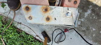

I have an old 8 ft fiberglass ladder, which had the rivets for the thinner legs at the top plate pull-out/rust-out. I used my old HFT side grinder (an orange case, probably 25 years old) to remove all the rivets holding all the fasteners for the fat (front) legs as well as the skinny (rear) legs to the top plate. A BFH and a center punch was helpful in punching out all those failing/failed rivets. The rivets were replaced with 5/16" X 1" SS hex head screws, flat washers, and nylok nuts. It's much stronger now.
I also replaced the folding A-arms holding the front/rear ladder legs together, using the same procedure and fasteners.
The ladder was a 'found on the side of the road' item, years ago. Still functional, after a bit of work.
The bad, rusted-out fasteners:
One SS hex head screw already in-place.
Seeing how-bad the rivets were, I wasn't going to use it without replacing them.

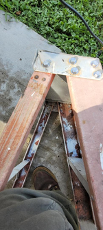

The SS hex head screws/nylok nuts are seen here.

As much of a safety nut as you are, I can’t even believe you were using that ladder.lol

I think those bolts are worth more than the rest of the ladder.

Philip, I'm the likely the least qualified safety adviser on the GJ but I'd shorten that ladder to something like four feet. A fall from 5 or 6 feet might leave a mark or put a body part in a cast. If that ladder was old when you got it, there's no way of knowing how much UV damage has been done to the fiberglass. The rivets you've replaced is a start but you don't put any weight on those. The rusty rivets that attach the steps to the rails look pretty rusted and those rivets hold your full weight. If a ladder step lets loose it will be a complete surprise and you'll be headed for the ground at a rapidly increasing rate.
Full Disclosure: I have made many mistakes when it comes to ladders. In 1968 (three years before OSHA was born) my tallest ladder was four feet high and had no safety warnings so I used all but the top step to paint our first house with a spray gun. The extension ladder would have been safer but holding a spray gun with a quart of latex paint with an outreached arm was too close to a torture technique my father used to prove how weak I was as a kid.
A decade later (47 years ago) I bought a super cheap 6-foot aluminum step ladder. The skinny leg eventually buckled on me and I landed on a sturdy hedge. No stitches or casts and using logic similar to yours I reinforced the part that buckled. As @niget2002 points out, stainless hardware would have exceeded the cost of the ladder.

I can appreciate being frugal and repairing rather than throwing something away, but one minor failure and the cost of a new ladder will be tiny in comparison. I’ve fallen off a few sketchy ladders in my time, but that was when I was younger and dumber. I’ve stopped doing a few things when the potential recovery from injury outweighs the pennies saved.
One of the maintenance mechanics at my former employer was a frugal guy that drove me crazy by insisting that **** ladders were “good enough”. I pissed him off a few times by running over a sh!t ladder with a 15,000# lift truck to render it garbage.
Next time, in made him use a demo saw to chop one up into little pieces. He was one thick-headed SOB.

Thank-you to all the members who commented upon the ladder 'fix.' To be truthful, I don't use it much, and I probably could use it for an example of 'when do you retire a ladder?' I have others, which get the call to work. I checked the other rivets, and the ones which were in-need of replacement were all steel ones, the aluminum ones seem to be not showing signs of looseness, deterioration or in-need of replacement. I do store it out of direct sunlight, and as-mentioned, I rarely have used it. Maybe I need to take a second look with respect to its overall condition, despite the valuable SS fasteners. :unsure:
