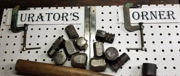

#11: Wheel Knockers
We had a total of two (2) of these forceful types of wheel removal tools in our collection prior to yesterday, when the Acquisitions Dept ran into this rusty box of miscellaneous brands.
Here they are cleaned up.
The top row are all Herbrand.
Left to right in the second row are K-D, NB (x2), and two unbranded/unknowns.
Bottom row is unbranded/unknown, PLVMB, and a brass hex nut or connector we are certain the PO was using as a wheel knockout.
We love the succinctness of the instructions on this SK box (that belongs to @Oldtuleguy ), which pretty much tells the whole story of how to use these tools, and the Curator can't and won't presume to do them more justice than that.
Look for more on the Herbrand, the NB, and the KD examples in their respective brand threads.

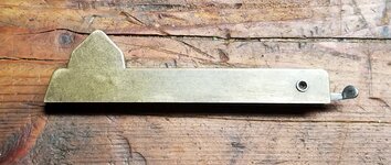

We present an item unique to the whole of the Lugzsonian..., the fleam.
Not to be mistaken with the angle of the cutting face of a tooth on a hand saw!
If we spelled it like phleam and said it was used for phlebotomy, would it begin to make more sense?
The various sized semi-circular shaped blades or lancets you see near the ends of the shanks on these ancient bloodletting "tools" (instruments would be more accurate) were designed to be placed over the jugular or saphenous vein - most likely of various-sized farm animals, but apparently sometimes humans (including as late as the Civil War) - and then struck with a sharp blow by a fleam stick or a wooden mallet.
Credit to one of our colleagues on the Left Coast, @RTM, for recognizing its shape. Admittedly, the Acquisitions Dept was thinking leatherworking or metalworking or even gages for something special when he plucked the curiosity out of a box of smalls at the flea market this morning, and the Curator could brook no argument nor offer any better alternatives. It was well-spotted, especially for a squeamish sawdust maker, and wethinks he is correct.
Here are a few legitimate models purloined from the web exemplifying its unmistakable design.
Late-1700s-brass-and-metal-_5-fingered_-fleam-redo.jpgFleam iron.jpgFleam pot metal.jpg
And, believe it or not, a few have shown up on GJ before, classically, as Whatzits - of course!
An example with an ornate ebony handle, linked here.
And a cruder, more modern example linker here.
P
30,656
What's odd about our fleam, which has obviously been home- or shop-made, is while the flechettes and the main blade may look sharp...
...they are in fact as dull as, um, er, a worn-out simile.
They would not penetrate a filet mignon or slice a loaf of bread, let alone pierce a subcutaneous vein.
We postulate that what we have here is either a practice piece, or perhaps unfinished.

Yes, but they could've been modified out of something made for some other purpose, no? Like wrenches. The grinding is crude. Granted, it's not finished, and maybe it would've been cleaned up and polished better. The case gives me some pause, because it's fairly sophisticated, but it, too, shows some seams and could've been put together in a shop. Maybe not. I'm not sold either way. It's ferrous with a brass finish, by the way, not brass.

Given that it appears to be a production piece - not a home-made affair - is it possible it was made as a sample? (e.g. "salesmans sample?)
There were (and are) all kinds of makers of medical tools and instruments that we very deliberately do not focus on. I would think they would be "marketed" not much differently than pliers and screwdrivers - the only difference being the client base.
Definitely an interesting and curious find. Didn't they stop doing that right about the same time as the Civil War?
