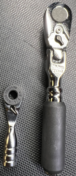

figure out where to buy it and what to order.
That particular ratchet combination is not sold directly by Snap On according to the website, but can be made by a dealer very easily.
RKRTM72A would be the guts to change any 1/4" 72 tooth ratchet into a 1/4" bit ratchet.
To make the pictured ratchet, buy a 1/4" ratchet with part number THLD72R and the conversion kit RKRTM72A.
Cost would be around $170 total if purchased new.

^ That's enough to buy TEN of those little Titan mini-bit ratchets! :lol:
I agree that there isn't much value especially in a bit ratchet where high torque is not required. I would think that something with a high tooth count but also VERY low back drag would be ideal. Buying from a dealer might save $20 or so, which still, doesn't matter much.
