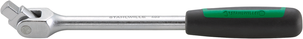

When I first bought metric sockets, I still had the (incorrect) mindset that 1/4” drive only really needed to be used on fasteners that were smaller than the sizes my 3/8” drive tools extended down to.
This is of course, totally wrong, and as I acquired more modern vehicles, I soon found this out. I needed some bigger sizes in 1/4” drive, and with Britool by then effectively gone, I opted for Stahlwille.
That turned out to be a good decision. Stahlwille may not be well known in the U.S. but they make a very comprehensive range of tools, and they do 1/4” drive very well.
They score quite highly on all the points I listed. The rigidity isn’t quite as good as some, but it’s acceptable. Here’s most of what I ended up with.
I really like the finish. It’s a genuine satin chrome, and it’s very durable. You can use these tools without any concerns about damaging the polish!
Owning tools in other drive sizes from Stahlwille, it’s obvious that they take more care with the finish in 1/4” drive.
Other things I like are the overall smooth shape of the parts - no corners to get caught up or cause injury - although this feature is not as noticeable as on the bigger drive sizes.
I also like the option of the all metal handles on the ratchets. There is a comfort grip option, but I prefer these.
Things I don’t like are that the fine tooth “N” series ratchets have plastic backplates. This is unacceptable I feel.
There is also a very limited range of (basically one) long handle ratchet. It’s not as long as some, it’s only available with a comfort grip, and there is no extra long option at all.
Having said all that, I use these tools extensively. If you think they are clean, you’re right. I‘m quite fastidious about cleaning tools after use, especially in 1/4” drive. The only tool I don’t use much is the spinner handle. It’s a hard (ish ) handle but I never really liked the shape or feel.

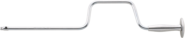

A few years back I was working away from base, and was asked to take on an extra task. I needed SAE tools but didn’t have any with me, so was allowed to make free with the company credit card.
As things turned out, the MAC truck was first on the scene and had all I needed. I bought these 1/4 drive tools, and only ended up using about two sizes, but I decided I quite like them.
I like the sets - comprehensive, and no skips. The overall quality, and particularly the fit, are very good. I like the metal socket trays, and I like the extensions (particularly the knurling).
I love the chroming. I know folks here rate the finish on Nepros tools highly, but MAC chrome is pretty decent too, and probably (controversially) better than most non Nepros Japanese tools.
I also love the spinner handle - so much so that I bought another for my everyday box. Sadly, I think these are discontinued now.
The only downside is that Mac were not able to match the handle styles on the ratchet, and the hinge handle. I assume the latter are bought in.
One thing for the U.K. readers - these MAC ratchets are very similar in size, shape, and style to the old (pre James Neill) Britool ratchets. If you have a worn one and no repair kit, these make a great substitute!

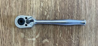

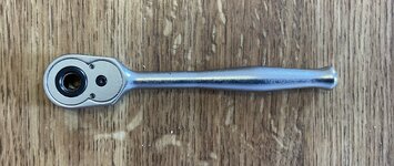

How have you found the durability of these? I’ve heard bad reports on Stahlwille 1/4” durability, used professionally they needed warranty every 1-2 months. Swapped out to SO and the failures stopped.
In honesty, when I first acquired the Stahlwille I had the older style ratchet with the coarse teeth, and the metal backplate. I had a fair amount of use out of that tool and it seemed to be fine.
Here’s the bit ratchet of the same style.
I have not had the “N” series ratchet’s that long, and for a variety of reasons (mainly having so many alternatives) have not used them so much, so only time will tell.
I do know of a few folks in the aviation world who have been “issued” Stahlwille ratchet’s, and they generally don’t like them.

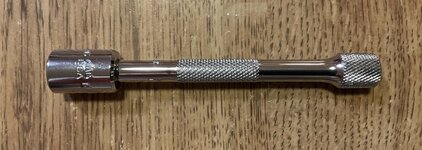

^ love the knurling at the top end of the extension.
Yes, that knurling at the top end really works in 1/4” drive. Mac (and KoKen now) both do this very well.
Note how the female end of the Mac extensions are actually slightly oversized, compared to say the Stahlwille, so you also have enough to grip.

Breaker bar
Usually 3-4cm longer than the ratchets. The sliding T-handles are so thin in 1/4" to be quite uncomfortable, so maybe nice to have. Or crack it free then use it inline as a screwdriver to spin out. Or get to things at an awkward angle.
Speed handle
The Stahlwille Breaker bars are nicely proportioned and sensibly designed. In fact, I find that in all the drive sizes, not just 1/4”.
The only thing I don’t like is that they are only available with the comfort grip. With 1/4” drive in particular, I often find that I’m close to whatever I’m working on (inside engine compartments etc) so for automotive work I like tools with metal handles that don’t get damaged if they get bashed, and I can easily wipe off dirt, grease, or brake fluid.
The 1/4” speeder was obviously designed for the aerospace world, and is a superb design, as well as being I think unique.
For those who haven’t seen these, the “pad” is removable, allowing you to use it as a conventional handled speeder, or click the pad in to lean on it (vital for screwdriving). And all steel as well. And locking…
