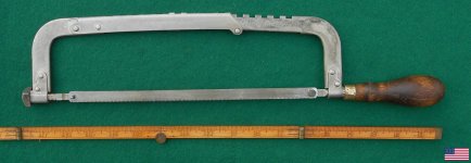

I need to get the blade off the frame in order to be able to take it down to the local saw shop and have it sharpened.
I've reworked and returned several of Joe's tools over the last few years. A couple below:
I have the same affinity; gives me a sense of something to find an abused vintage tool of quality - put it back in it's 'working clothes' and use it or find a place it will be appreciated.
The rivet is easy to take out; the delicacy of the restoration may effect how you do it.
To minimize damage:
Use and let soak the rivet with a rust remover; my go to is Kearney's Rust Cutter, Cat No. 19229-1. Can be hard to find; is for corroded power pole hardware; find a lineman, (my Dad was) he'll have it. Find a flex tube for the nozzle if you can; a tiny amount works.
File the peened end down flush with the surface & drive the rivet out with a drift punch; blade will drop out and adjustment bolt will follow; replace with new rivet when ready.
The process on a shovel, removes some base metal - who cares on a shovel - with your knowledge, suspect you can minimize or eliminate that.
Absolutely Fantastic Project; Enjoy !!!

Alternative to filing the peened end of the rivet is to drill into it with a bit somewhat larger in diameter. Be careful to center it, and not let it walk. Do a pilot hole if you don’t have a sharp brad-tipped larger bit. When the face of the drill reaches the plane of the hole in the frame, the peened edges of the rivet will ride up the drill bit like a collar. Don’t drill any deeper, or you’ll widen the hole. Stop and punch the rivet out.
To my aesthetics, I’d rather risk a slight bevel to the edge of the hole, which will probably be covered by the next rivet peening, than risk visible parallel abrasions from filing, because the peening can be depressed below the surface of the frame.

Same process, but your saw sharpener guy should be able hold the blade with the back pin in tack; if you haven't checked already, he may be able to sharped the blade left in the frame.

I don’t believe that split receiver is tapped. I think there is a missing wingnut. Once you get the rivet off the front end of the saw, give the threaded bolt a tap to break it free from rust and dried blood/fat, then pull the blade forward to extract the bolt from the receiver.
I think the pinned blade will be easier to remove from the bolt when the bolt is out of the frame.

Here are six butcher saws. ALL are pinned/riveted at the front end.
Four are also riveted at the rear end.
Two have a tensioning bolt with a nut.

Don't feel the rivets are difficult to remove, you'll find it easier than I think you imagine.
Is the back pin possibly a tapered pin?

I would bet that rear pin is tapered; same rust remover deal if corroded/stuck - should drift out.

Since I’ve dug out my butcher saws, I guess I’ll make two more restoration points.
This short-framed saw was among my grandmother’s kitchen gear. The blade is held by two peened pins. When I went to refinish it, I discovered the frame was broken under the handle, at the top screw hole. (I refinished the wood handle anyway.)
Reconstructing the crime, I think someone attempted to replace an original blade with one maybe an inch shorter, by bending the frame from a 90° angle to something more acute, and the steel tore. I’ve considered welding and grinding the break, but really, the angle of the wood handle as-is, is unergonomic.

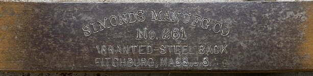

The highest-quality (and largest) of my butcher saws is this Simonds No261. It deserves a restoration.
I used my “careful” method to scrape off the rust (hematite) around the stamp with an old flat screwdriver (softer steel than modern ones), then brushed it by hand at four different angles with a stainless steel wire brush, leaving as much magnetite on the surface as possible.
IMG_7605.jpegIMO, this is the ideal, least destructive method of rust removal, and leaves a naturally passivated surface, not chemically different from what intentional blueing accomplishes.
I have read that boiling prior to scraping converts the hematite to magnetite, leaving a more evenly darkened surface. But boiling does not make loose hematite (or magnatite) stick to the unpassivated steel, so I don’t feel it worth the effort to boil something as cumbersome as a saw. The light spots will darken over time anyway.
Union Hardware Co., Torrington, Connecticut No. 10 hack saw
This one was a bit rough (top- last photo) so it got a bath in the evaporust for about a week, and then a going-over with brass brush and WD-40. Handle was kind of a mess so I cleaned it off and put some BLO on it. Original wing nut is missing, previous owner replaced it with a square nut.
