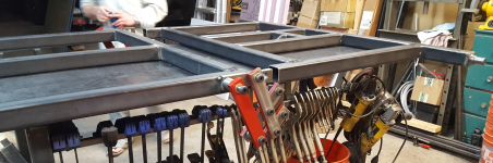

The short bar closest to the movable frame has an extra hole. What happened.

Ok i’m impressed. Well … should have been powder coated. 😜
I've been searching high & low, I'm disappointed that I can't find any pictures or videos of this one installed. The extra hole was for a conveyor roller, not that exciting. Actually, the entire thing moved, there's a pivot on the right side in the pictures above and the air cylinder mounting tab circled below. The best thing I have was a screen capture during the design process.
