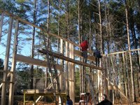

Monday - December 14, 2015
As I walked outside this morning we had already had a little rain making the building site pretty slick. The framing crew was at work.
The corners of the Lone Beech Garage were brought into a plumb condition and then secured.
The purpose of the chalk lines that had been snapped last week were now revealed. The blocking being placed on that chalk line is 8-feet from the floor and will allow the OSB sheathing to be secured properly.
At about 9:30 am, shortly after this picture was taken, we got a downpour and the framers left the area. We got about 3-tenths of rain and then, around noon, it cleared off. The framers returned early afternoon.
A container for construction debris was delivered to the building site.
The 7/16-inch OSB that should have been 5/8 OSB was removed from the building site.
Headers for the windows were built and placed.
Windows! It's looking more and more like a building.
I was hoping the framers would get the headers for the garage installed today but that didn't happen. It will be interesting to see what has been accomplished while I was in Buenos Aires when I return on Thursday.

Meanwhile the framing crew was building what would be the floor of the Mezzanine or Upper Room.
A Sill Beam was placed and secured.
A temporary support was constructed and the Mezzanine floor joists were added.
The 2x12's were cantilevered out the east wall to form the upper landing for the stairs to the Mezzanine.
