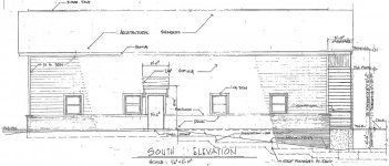

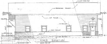

As to the dock area concept... I had a set of plans that had been drawn up by my Architecture-Student-Nephew in hand in February of 2014. These plans included a dock landing on the south side of the building. I had asked my nephew to do it that way. These plans also did not include an upper room.
Shortly after receiving these plans, I was back in Indiana visiting my folks. This rural area is a target-rich environment for outbuilding ideas so I was driving around looking at neighbor's structures more closely than normal.
...and then I drove past Dave Williams's place about 3 miles from my folks and I pulled off the road and took this picture.
As you can see, his Machine Shed had a loading dock integrated into the drive exiting the end of the building.
When I saw this I realized this feature - if I intended to have a loading dock - would be a superior solution to what I had asked my nephew to draw up. This, plus the realization that there was room in my building for an upper room, caused a dramatic change in the original building's concept.
These changes exceeded the ability for a few pencil marks on the old plans to adequately detail the new features. My nephew now had a job and a girlfriend.
I sought the services of a local semi-retired architect and started down the road towards getting upgraded plans.
