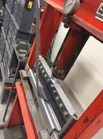

I was able to some work done on my son’s rear bumper last night. Week before last when I was working on it, I had a large center section tacked in place in which to build off of but when I walked into the shop yesterday afternoon and saw it for the first time in nearly a week I almost puked. It looked HORRIBLE. It looked too Mad Max~ish and NOT in a good way.
I cut the tacks and cut the receiver tube back out of the hitch and started over. The plate was just too tall and flat. The WJ already has a big booty and that big flat center section just magnified it.
After cutting the flat center section off and installing a new section of receiver tube that will slightly protrude I put a bend horizontally in the center section. Seeing as how I don’t have a brake large enough I had to get creative but it worked.
That looks much better having a 35-degree bend in the center in which to build off of.
Once deciding we were pleased with the overall lines and look we removed the assembly so I could final weld the center section including cutting thru holes in which to weld the D-ring mounts to then supports from the frame mounting out to the D-ring mounts so everything is tied back to the frame (unibody rails) properly. It bugs me when I see mass produced bumpers that don’t have the D-ring mounts properly placed. Some even state “do not use as recovery points”. Are you shitting me? Why put them on the bumper if they’re not to be used? Looks only I guess.
Here is everything being final welded so it can be reinstalled and fabrication continuing.
Installed back on the Jeep so we could continue fabrication.
Side view. Thus looks much better than version one, although it’s still going to be quite a large bumper.
We then got a little creative as we wanted to keep the actual bumper as tight to the rear as possible to keep the departure angle at least somewhat acceptable. The spindle mount for the tire carrier is actually sunk into the outer body of the bumper.
After standing back and looking at it I felt like it needed just a little more to make it flow. I cut a piece of DOM tubing to give the spindle a molded or “frenched” appearance.
There we go. A little more metal finishing and it will blend nicely.
Thanks for looking.
