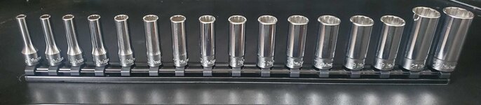

Thanks to @Catcher1984 for hooking me up with this Koken 3/8" 12 point deep wall socket set, 6 to 22mm skipping only 20.
Picked up one of Harbor Freight's excellent US General magnetic backed aluminum socket rails to store them on, and it worked out perfectly, filling out all 16 of the clips the rail comes with. Socket rail is made in Taiwan. Oh and the ball detents on the clips are strong enough to easily hold even the 22mm socket in place, even when the rail is mounted upside down. :)

Most of this year's purchases from Japan. Koken 3/8 nut grip and fractional sockets, and a bit adaptor. Nepros 3/8 t-handle things, and 3/8 standard and compact quick spinners. KTC cutters, a Vessel chisel screwdriver, a Mokuba mini prybar, and Vessel and Anex thin shaft bits.
I think I've picked up most of the recent "Japan-only" PB Swiss screwdrivers, and both of the Zwilling scissors had Japanese packaging, even though one was purchased from Amazon USA.
