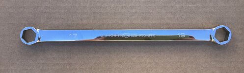

Has anyone ever purchased the Nepros combination (or other) wrenches? I see a lot of info on the ratchets, but none on the wrenches.
I use Nepros combination wrenches and recently got a couple of the long ones, which are basically the same length as standard Snap-on wrenches.
Nepros combination wrenches are pretty much identical in shape, feel, and function to Snap-on wrenches in my experience besides the length (American wrenches tend to be longer than European/Asian ones IME).
Strength wise they seem to be equal while, at least initially, the Nepros chrome finish is better as it borders on near perfection. Hard to say which chrome is better in the long run though as both hold up just fine.
Attached are a standard Snap-on combination wrench, a long Nepros combination wrench, and a "standard" Nepros combination.
I was looking to get some for a while but didn't find much in the way of reviews/photos. Ended up getting some other KTC and TOP wrenches instead because I just don't really like the feel of chrome in my hand (even if it is pretty!).
One thing I notice from pictures is that the Nepros stuff seems to have very low chamfer on the box end openings compared to just about everybody else.
Good eye, sir.
It looks unique though. I assume the quickness advantage the chamfer gives in regards to fastener engagement is as negligible as the grip or strength advantage of the non-chamfered edge.
Even KTC's Profit wrench has chamfered box ends.
I have the ring spanners (box end wrenches).
Utterly superb tools, flawless in every respect.
I bought them because Nepros were one of the few manufacturers offering hex / 6 point versions, but I would have bought them (and will probably buy more) for the quality alone.
Broaching is superb, on a par with (or possibly better than) the very best out there, as is the finish. Only time will tell if the steel and finishing outlast anything else, but early indications are that they might.
Not long after getting these wrenches I dropped one from the roof of a Land Rover (where I was installing a roof rack) onto a concrete floor. The wrench was unmarked!D53C58A4-2145-4038-83A6-D7161C111DB9.jpeg1FD06930-FAE7-4539-9665-D04EBBD5E051.jpeg

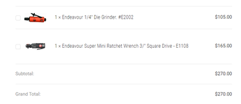

A tool store is closing down soon so they are discounting a lot of stuff. I ordered an endeavour air die grinder and an air ratchet at about 50% off which are rebranded Shinano tools. The Shinano model numbers are basically "SI" instead of "E", not sure if the B in the Shinano model means any difference or not.
I had been looking for used quality air tools like these and normally people want about these prices for used tools.
Endeavour E2002 - Shinano SI-2002
Endeavour E1108 - Shinano SI-1108B
Of course with my luck the die grinder box is missing the die grinder. I was wondering whether any air fitting was going to be included with the ratchet since the inlet is 1/8. What was included was a genuine Nitto fitting made in Japan (Nitto "style" are the most common fitting type here in Australia) at least one of the two Shinano distributors here normally includes knockoff made in Taiwan fittings.
I will sort out a hose whip to make it actually fit into tight spots.

A tool store is closing down soon so they are discounting a lot of stuff. I ordered an endeavour air die grinder and ratchet at about 50% off which are rebranded Shinano tools. Of course with my luck the die grinder box is missing the die grinder. I was wondering whether any air fitting was going to be included since the inlet is 1/8. What was included was a genuine Nitto fitting made in Japan (Nitto "style" are the most common fitting type here in Australia) at least one of the two Shinano distributors here normally includes knockoff made in Taiwan fittings.
Excuse my ignorance but isnt that an Air Ratchet with a 3/8" square drive anvil with ball detent for the sockets ? rather than an Air Die Grinder...
I ordered both a die grinder and an air ratchet, how I wrote it isn't the clearest it could be. going to fix it now.
Here are the model numbers as I didn't bother posting them before.
my bad, upon re re-reading it, it does sound like you bought the two different tools. didn't intend my previous reply to be a smartass comment. Nice air tools btw :) never seen a cordless ratchet with a wobble drive anvil before.
Here in the U.K. we haven’t, historically, seen a lot of Shinano tools. There are just too many other choices. But, Shinano do offer some unique tools.
They seem to be really good at compact tools, such as this polisher. I’m starting to see a few of these around, and I’m quite impressed with how neat they are!8799FCED-2435-4610-A7AC-FDDD176FFE8C.jpeg
