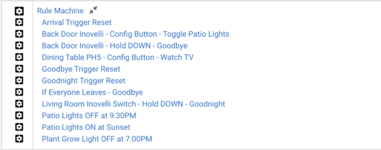

Hubitat has a number of built-in apps that run on its hub for automation. The most complex of these is called Rule Machine, and it is very powerful. Another one they recently adopted is called webCoRE (Web Community's Own Rules Engine) and is similarly powerful. webCoRE on Hubitat was ported from SmartThings, where it was originally developed by that community. Since I already have experience with it, that's what I'm predominantly going to use on Hubitat (for now). WebCoRE supports advanced conditional logic, variables, and expressions.
Here's a real example of a simple automation, using webCoRE, from my actual house.
