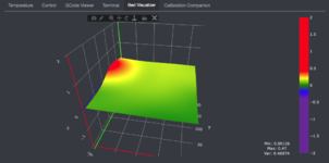

This one's for the 3d printing nerds. If you're not a 3d printing nerd — read at your own risk, you might get bored to death. Austin (@MadeByMiller ) , I'm going to just go ahead and give you permission to gloat about Prusa's superiority before even jumping in. :ROFLMAO:
To anyone following along with my 1st layer drama on the new S1 printer, I spent some time this weekend trying to troubleshoot it.
The peculiar thing is, with small prints I never noticed any issues, and certainly everything beyond the 1st layers was coming out great. With this larger socket tray I've been trying to print, I think the issues have been several things:
1/ Possibly bad or old filament. Both the white and black Overture PLA I've had for a long time, and didn't properly stored it, so maybe it had too much moisture, I don't know. It's pretty dry in my basement but it's a possibility.
2/ Incorrect Z-offset on some of my attempts (too squished)
3/ ABL Mesh not actually being used
4/ Warped build plate
Number one is self-explanatory, and thanks to @loganb 's encouragement I made a trip on my toboggan to Microcenter to get some new PLA filament, and a USB C cable to get Octoprint going.

Then I installed and configured the Octoprint Bed Visualizer plugin and tried to load a mesh. But the printer kept disconnecting the serial connection upon Auto Home and giving me this error:
Some Google Fu and another 30min lost, apparently it doesn't like it if there is no mesh already saved? Even though it's about to go through the process again? I don't really understand why, but I ran a Leveling on the printer and tried again, and sure enough now it let the Bed Visualizer plugin proceed to do it again.
And holy $h!t
I seem to have a high spot right where that corner of the print is oriented.
It's 0.47mm above the zero point, which seems like a TON to me?! This is my first time doing this, but it seems odd it's so pronounced and localized to that one area, when the rest of the plate seems fairly good.
I saved this latest mesh, and for the first time, uploaded and started my print from Octoprint instead of the SD card.
The perimeters went down better so far. And while it still struggled in that area of the print, the majority of it came out ok. And by the 2nd layer (depicted below) everything was looking excellent.
So I think this new filament is a good baseline. Obviously if layer 2 looks perfect it's not an extrusion issue in general.
I think for smaller models in the center of the build plate it's much less of an issue than a big tray like this that encompasses both the "bulge" and the lower areas.
Going forward I can think of a few possible ideas to make it better:
1/ Buy a replacement build plate (~$40-50 on Aliexpress) and hope it's flatter
2/ clip my glass Carborundum plate from the 3v2 on top of it, and either see how much it conforms to the base plate or possibly shim it withe some pieces of paper if necessary, hoping this is flatter overall (it was quite flat for my 3v2)
3/ Cura has "Intitial Layer Height" and "Initial Layer Flow" settings that I may try to use to compensate and make sure enough filament gets put down to create an even layer
4/ Chuck this POS in the trash and buy a Prusa! :ROFLMAO:
If anyone has any suggestions or comments I'm all ears.
Oh, hi there! You said it best...
That's quite an interesting Bed Visualizer result having that localized high spot. I don't know the construction of your printer, but is it possible that something was assembled incorrectly beneath the bed causing it to push up there? The first layer issues certainly are making sense now, I just did not expect your bed to be that bad, but I should have not ruled out that possibility from an Ender...
Do share how you finally resolve the issue, but for now it appears as though you would be just fine to slice whatever you're printing as much towards the front/right as possible for best results.

Now I am curious because it almost looks like the manual leveling screw in that corner is higher than the other, but no the bed most be warped. I would try with a known flat surface like glass just to see if bed is the problem.
Agreed. Although it lines up with what I'm physically seeing with the nozzle scraping that area if the rest is manually leveled ok. And obviously matches the biggest problem area of the print. So it seems the probe is accurate.
There is nothing in the assembly I can tell that would affect it. The Y-carriage is an H shape, and in each corner is a screw and leveling spring/wheel combo. It's the same on both sides. My guess is it's just a manufacturing defect.
Normally I never move anything from centered in Cura, but that's a great idea to use the front corner. I could have even rotated this 90° and used the right side of the bed with better results I'm sure. Kinda stupid that I have to do that but I bet I could accomplish most prints that way without issue. I will play with some of the other stuff I mentioned, too.
It's definitely warped, that's the only explanation I can see. Even the upper left corner right next to the bulge is noticeably lower. I have a glass bed plate I can use, part of me wonders if when clipped down it will bend and conform to the warped build plate a bit, but it might reduce the overall effect. I'll need to do some tests!
