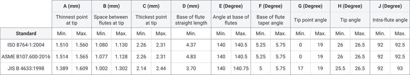

In the chart below, we show the standard dimensions for a Phillips #2 driver tip according to ASME, ISO, and JIS. In almost every dimension, the ASME or ISO driver requires a tighter range inside the JIS dimensions.
There are a few really minor differences:
First, the JIS standard allows shorter screwdriver tips (but doesn’t require them) compared to ASME or ISO. For example, on #2 Phillips, JIS says tips must be at least 3.70 mm, ISO says at least 4.37 mm, and ASME says at least 4.83 mm. In practice, what matters is that the tip of your driver end can reach into the screw recess. All of them can, and in fact JIS is the one that is limited in deep screw heads, if any are.
Second, ASME and ISO say that the angle at the very end of the tip can range from flat to slightly pointed (0–19 degrees), while JIS calls for a slightly pointed tip (17–19 degrees). Both standards should work in any normal cross-tip screw. In fact, what’s surprising here is that the standards refute the popular assumption that JIS specifies a flatter tip.

The tekton article talks about jis being worse as the standard doesn't reach as deep. IRL reaching deeper isn't necessarily better. To apply good torque you want better grip at the outside of the cross. If the cross section is too deep you only catch the center and not the outside.
Thats why the old horrible freight and craftsman screwdrivers **** iirc.
The "jis" being a fraction of a mm shorter have better bite because of this.
I've ground the tip off a few cross headed screwdrivers to fix this problem. In one case, the screws were ****, and the recesses too shallow. Others I wasn't sure about, but it was clearly the screwdriver bottoming out, so the grinder it was.
