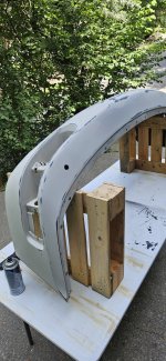

With renewed confidence I bought a couple 12oz cans (not too confident I guess) and rushed home. I had already taken the bumper off and carefully prepped the surface. Basically lightly sanded it down to the primer. Wasn't careful enough to not get down to plastic in a couple small spots apparently.
Light plastic prep and primer later I was ready to paint. About this time a set of brake ducts showed up. Thank you UPS....Prepped them as well and got to painting.
Don't mind the feet. I ran downstairs just to take this pic. I don't normally work barefooted. But when I do, it's Dos Equis.
A light wet sanding and a second coat. Then the final third coat.
That's more like it!
After letting it cure for a couple days I got my buffer and thought I F'd it up again...so much color on my pad. Stopped and finished by hand. I think my pad was way to aggressive even though it was the finest I had. Oh well. Maybe not enough days of curing?
picture below before buffing and with lots of dirty finger prints all over everything from installing it onto my dirty car...ugh
In the end it looked great. I was happy.

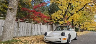

I went back to the shop and bought several more cans because I want to do my rear bumper and hood now. Likely next spring.
After a good washing.
In hind site I could have gone 4 or 5 coats. Maybe next time.
