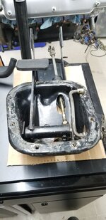

Hi all, not much has been happening to the garage. I think I've put a mental pause on doing anything until the new doors arrive. So I got back to working on the fuel injection parts for the 2002. Also got to sorting out the wiring harness...what a pain in the ****.
When I'd had enough of the harness, I moved on to greesier and dirtier things. Talking about the pedal box and brake booster.
Gunk, corrosion and just plain old, these needed some TLC. Here they are after a quick cleaning. I dismantled them and then put them back together loosly. I do this while working on systems that aren't ready yet for restoration. I lose less parts this way.
If you're familiar with 2002's you'll notice this is for an automatic. For some reason I catch flak for not having a 'real' transmission in there. To each his own and in this case, since it's Jo's car, to her own. Jo prefers an automatic. So there we have it.
Brake booster is pretty typical. Nothing special there. I'll get a new one and referbish the mount. I have a bunch of parts, incuding the front and rear subframes, that need to get powder coated. These are being added to the pile.
The pedel box is a bit of a weird thing. As far as designs go, I think this was a bad one. There is a sound deadener pad that was glued to the under side of it. Under the car like it is, it acts like a sponge and lets water in and allows rust to build. This one appears to have been replaced at some point. It had a newer pad, in sad shape when I got to it, and something akin to plumbers putty acting as a gasket. I've seen these totally rusted out. This one, not so bad.
There's also a hole, that's built in. Not kidding. I'm not sure what it was for except to allow more water in and to accelerate the need for a new carpet and floor pan. Dunno. It'll get welded shut and powder coated over.
For both components, new springs, bushings and fasteners are being sourced. My powder coating bill is going to be big!

As for the garage, I've been busy. I think I've got at least 3 or 4 projects going on at any given time. These last couple weeks I've been working on the 2002. The garage is a mess because of the remodel that's on hold and I have the other couple projects in there that I'll get to shortly.
First, Betty. In the middle of the mess.
I've torn down the brake peddel box and the vaccum booster/master cylinder. That's getting powder coated once I have it all rebuilt.

For now, I'm still tinkering in the garage. And since the 2002 restoration is still chugging along, here's what I've got:
The parts washer was a smash! I think I was cleaning things that really didn't need cleaning just because I could. It's made working in the garage nicer! Being able to see the parts that you're working with is essential. A car that's neglected for so many years, the amount of gunk that builds up is astonishing!
So, all of the foot pedel bits, brake components, trailing arms, manifolds, etc are all sparkling clean.
Much of it needs to be boxed up and sent to the powder coater or plater. Anything thing that just needs paint will be done by yours truely.
