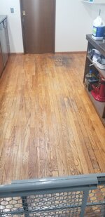

As for the garage, I've taken another detour. One of the biggest problems with having a small garage and lots of planned projects, is you don't have the space for it!
I ran into this again as I was getting tools out to refinish the floor in the kitchen. To get to my sanders, the shop vac, and hand tools I had to move the engine hoist, engine stand, welder, and the transmission of the 2002 out of the way just to get to these tools. Better organizing will happen soon, but first the floor.
When we moved in, the first thing we said needed to go was this cheap vinyl laminent that was put in the kitchen over oak hardwood flooring.
We were a little worried about the condition of the floor below. Why else would you cover it? Water damage?
Pressing on, we did find a little water damage. But all the floor would need is some refinishing! Guess it was easier to cover than refinish.
So, we spent a day removing the vinyl and then planned how to tackle the glue underneath. It looks like whoever installed the vinyl ran out of glue halfway through the job. One side of the floor has a ton of glue while the other is very light or didn’t have any at all!
Area blocked off because we have critters.
I found a low odor chemical remover and spent another day laying that on and scraping up the melted glue.
The wood under all of that didn’t look bad at all and just needed some TLC.
Kitty seems to approve!
The kitchen itself is pretty small so we hemmed and hawed on whether to rent a floor sander or do it by hand. Let me tell you, we should have rented a floor sander! On day two now of hand sanding it with an orbital is kind of a pain.
Denwood
Sep 22, 2014
4,204
Thunder Bay, Ontario, Canada
I feel your pain as I just refinished our kitchen maple floors. Doing it again, I'd 100% rent three sanders, even for a small floor:
1. Floor Drum sander
2. Floor Finishing sander (pad or orbital)
3. Edge sander.
I was quoted $150 a day or similar for all three and will do this 100% for the rest of the main floor this summer. It took about 8 hours using a random orbital floor sander, (large rotating head with three counter rotating 6" heads), that likely would have been 1-2 with the correct tools.
