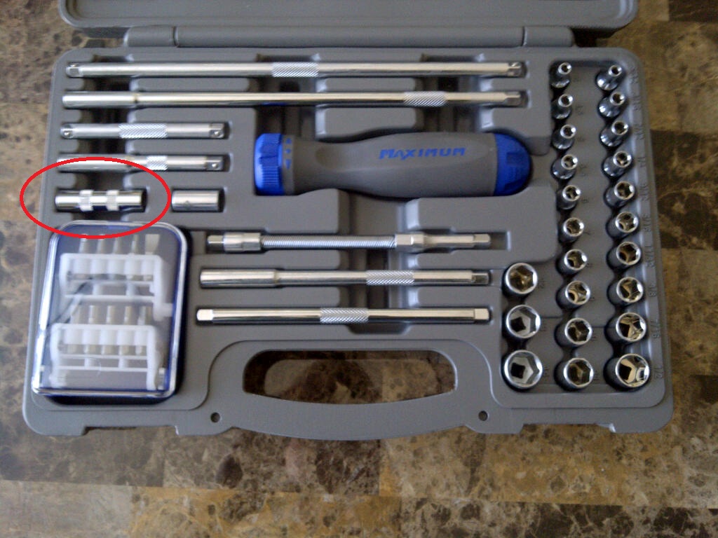

Out of curiosity, what is the application of this?
In my glovebox, I keep this little kit I made up.
Sockets and bits fit into the handle of the driver. 8,10,12mm. Flat and Phillips bits.
Not pictured, a ratchet that I also keep in the bag.
I could use the tm4 1/4" piece as an extension if I had an equally opposite female adapter to use on the ratchet.
I know it sounds complicated, but I just wouldn't feel right if it was easy. Lol
Thanks for the interest and suggestions so far, everyone!

I picked this mastercraft maximum ratchet handle set up a couple years ago, it has one in it, not sure if you'd be able to find something similar.
Gearwrench has the same piece, I had gotten a couple. The other thing you could use is a plain 1/4 drive extension, it does work.

Thanks, all. I feel this question has been well answered. I will be looking at Fastenal, at a Mastercraft or Gearwrench adapter.
And yes, I have had a need for it. I know I could just put an extension in the "kit" but I like the compact idea of the adapter.

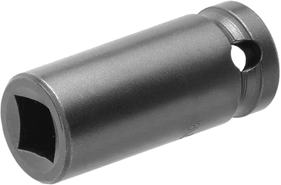

Not sure about inexpensive, but - Snap-on TQN139. It is a 1/4" F x 1/4" F torque tester adapter. It's likely that Precision Instruments and CDI make one as well and that the Snap-on version is one of those two.
The least expensive option is likely to be a 1/4" drive 8 point 1/4" socket, but it won't have any retention on the 8pt end.

Could you take a 1/4” hex bit socket and slide a matching socket in the other end? If you got a 6 mm hex bit socket 1/4 drive and then put a 6 mm 1/4 drive socket on the end now you got something you can use
I guess you could take two 1/4 impact sockets and weld them together if your going to do this alot and it doesn’t exist

Yea I was thinking the same thing. It wouldn't have the spot for his detent ball though.
Usually for stuff like this it is for a special application and one can jam in tape etc to make things retain well enough for a limited time. Similar can be done with square (female) type sockets. If you had the need now and then and wanted to be a bit more fancy, you could carefully grind some detents with a Dremel type tool.

The Gearwrench adaptor works really well because the sleeves work as stabilizers. It's out of stock on Amazon but that's not uncommon since they are inexpensive and move quick. The last one I got was like $3. The sleeves could easily be cut off to suit a need.

I have one of these. The square drive portion is recessed almost 1/2" on each end, presumably to support the extensions. They come with Gearwrench ratcheting screwdriver sets to provide a long drive extension.
You'd need a couple of short extensions; you couldn't connect, say, two ratchets.
Yes, or just cut the sleeves off.
