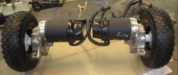

Well, my old fart cart project took a step forward over the weekend. I acquired a pair of Hoveround motors for $40. My understanding is the two heavy leads to each motor are for power, 2 addtional leads are for some kind of speed sensor, and 2 activate a brake when no power is applied and release the brake when power is applied. Supposedly when the voltage on the two heavy leads is reversed, the motor reverses.
Now, I need to acquire a wiring diagram. So far, I cannot locate one on the WWW. Supposedly the wiring diagram is on the carts. Does anyone out there have one of these they could take a picture of (the wiring diagram) and post on here? I would really appreciate the help.

The motors I acquired (when installed in a Hoveround MPV5) are rated at
300 lb cargo capacity
4 MPH
12 mi range
I think I would like to use 10 inch diameter tires instead of the 9" that come on the original scooter. This would increase top speed to about 4.5 MPH with some loss of torque.

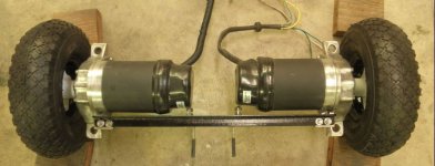

I have made some progress on my OFC. The rear hubs have been shortened, the front axles have been shortened, the front wheels have had the center hole diameter increased, and all the wheels have had the mounting holes extended toward the rim so they would fit on the hubs.
Here is a picture of the modified wheels and hubs.
This is a picture of the rear motor assembly with the wheels mounted.
A side view of the same.
I have continued researching the electronics issue and decided to order a Q4D Pro150 controller, plunge potentiometer, and battery gauge from Q4D in England. I hope this goes well, as it is my first time ordering from overseas.
Tomorrow, I start on the chassis.

After prepping the wheels, spindles, and hubs, I spent a couple of evenings drawing plans for the chassis (as far as I can at this time, as I will have to do some mock-up to finalize things).
I have now made some progress on the chassis.
The first thing I did was to make a new angle iron piece to tie the motors together, increasing the track to about 25.75 inches. Maximum design dimensions were determined by researching scooter carriers that mount on hitch receivers, as that is my planned way for transport.
