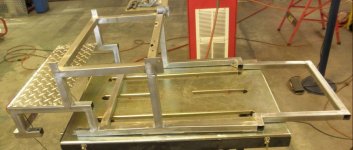

Today, I mated the front and rear chassis segments and added a couple of cross ties.
Then I started prototyping front wheel placement and seat supports. The entire area between the seat supports will be enclosed and used as the repository for the controller and batteries. The seat will be hinged at the front for access.

The latest progress consists of completing the seat frame.
The progress was slowed by the fact that, even though I thought I had things clamped up in alignment, once welded, one of the long arms was about 3/8 inch out of alignment in two directions. Fortunately my grinding skills are better than my welding skills, so I cut apart two of the welds, re-clamped, and then then re-welded, resulting in an aligned bracket. The alignment is important as I intend to have this bracket hinged for access to the area under the seat.
This shows the seat on its bracket sitting in the approximate final position.

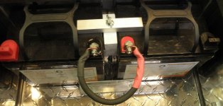

When I started the wiring, I ran into a temporary roadblock that required some additional research and decision making. The first issue was the battery and motor connections on the controller are 3/8 inch wide spade connectors (male). The motor wires (10 gauge) were terminated in 1/4 inch wide female spade connectors. Of course, my stockpile of parts did not include the needed connectors. Finally tracked them down at a NAPA store.
The second issue was battery cables. I had assumed I would use some #4 welding cable to make battery cables. However, I was unable to locate connectors to connect to the controller that would fit that wire size. After a bunch of research, I finally discovered a parts place selling an original Hoveround MPV5 battery wiring harness with integral 40 amp fuse. This told me the motor pair is not expected to exceed 40 amps and further research showed me 10 gauge wire would be more than adequate for the lengths I need. So that is what I will use.
This shot shows the batteries mounted with my fabricated hold-down. I used #4 cable to connect the 2 batteries.

So I had a no go issue with my Mobility scooter converted to a go kart which uses a similar motor to what you have. It's single motor only and wouldn't go one day after sitting for a week. Turns out the brake component of the motor had rusted up. Is it possible one of your motors did that, and the extra current needed to overcome the dragging caused some issues with the controller and pot?
J
Jeff Ivers
Apr 9, 2010
2,626
Oklahoma
In my case, I disassembled the cover to the end of the motor and found no signs of rust - just the melted wires to the brake controller where they were clamped to the controller with a zip tie. I have just heard back from 4QD and they disassembled the bad pot and discovered pitting on the contact track at the zero throttle position. They have speculated water intrusion or vibration. I have pretty much ruled out water intrusion. Vibration is unlikely as the unit would be at rest when the throttle is at zero. I am wondering if I am getting a slight sideways load as I start to press on the throttle, that might have caused the problem.

After playing with my OFC for a while, I decided it might be more comfortable if I raised my **** about 3", so, I fabbed some risers and installed them.
