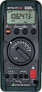

That being said, they aren't the only company making high safety high quality meters. Here are a list of other companies that make high quality safe meters:
  • Fluke
  • Agilent (now called Keysight as of Aug. 1)
  • Brymen (OEMs for some of Greenlee best multimeters)
  • Hioki
  • Yokigawa
  • Gossen
All of these companies make proper, high quality meters. There are others that are right on the edge of high quality.

  • Fluke 87V - This is one of the best out there, period.
  • Brymen BM257S - A highly safe budget meter. Goes for around $130. Also sold as the Greenlee DM-510A
  • Brymen BM869S - Higher CAT rating than the 87V, higher resolution and accuracy, dual display. Newer so it doesn't have the longevity. Also, sold as the Greelee DM-860A.
  • Fluke 27/FM - These can often be found for under $100 (used to be under $30 but the supply is drying up). They are safe and reliable miltary surplus. Often found with the high voltage probe rated up to 40kV. The 27/FM has TrueRMS the regular 27 does not.
  • Uni-T UT139C - A cheap $40 meter with 250V ceramic fuses.
  • Uni-T UT61E - A high resolution budget meter, high accuracy, so-so input protection. Comes with computer connectivity for data logging.
