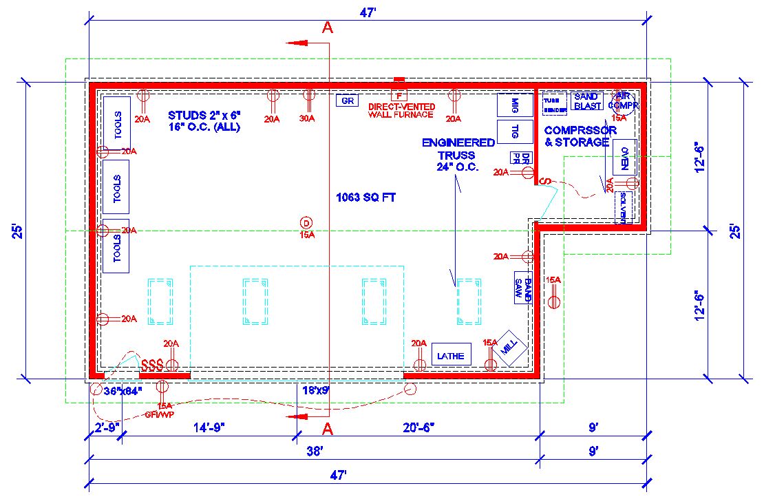

Planning to build this spring (2015). Certainly interested in tips and suggestions. I will be doing a lot more research within this site.
The plans (not entirely complete drawings - click pics to Biggie-Size them):
These drawings are not the latest.
[NOTE: CLICK FOR LATEST DRAWINGS (Feb 2015)]
May switch to 2x4 studs, with the garage wrapped in styrofoam insulation as well, to control noise & heat. Winters dip not much colder than -10°C/14°F, and summers usually around 35°C/95°F. Not much rain, LOTS of sun.
Old drawing showing only 3 skylights:
Workshop placement is restricted by septic field.
Tips? Suggestions? Thanks for having such an awesome forum!

***** of a property line ya got there. One thing that I don't like is the lathe and the mill out in the general shop where it is dirty. On my shop below you can see I went to pains to have the machine tools in a separate area that was easier to isolate from the dirt in the rest of the shop. I would suggest that you make the compressor room the machine shop and move the compressor out of there. Is your floor flat throughout the shop or is there a step up to the compressor room?

Will you be contracting out the work or doing the build on your own? Either way, looks like a great space. I will say, it looks like you've take a good look at the electrical layout in the shop and have a good amount of outlets planned. In the corner where the welders are listed there doesn't seem to be a dedicated outlet there. Will they be pulled out to another location in the shop for work or will they share that 20A outlet with the drill press or use that 20A near the furnace?

I originally envisioned the "room" being my "dirty" room, for sandblasting and solvent tank. I will ponder a "clean room" instead. Nothing set in stone as far as machine placement at the moment. If I keep it as is, I fully intend to make vinyl covers for the mill and lathe - keeps the **** off them when not in use (I have them for my welders).
The welders are positioned where they might be stored. The 30A at the back is intended for the welder, and I seem to have misplaced one at the front. I needed to plot out the footprint with respect to 1) a car being stored, as well as 2) a car to be stripped or repaired, as well as 3) a car being fabricated. Woodworking is under duress.
Shops I've worked in (I are a shop teacher, previously a mechanic) were already set up and I worked within their placement. Setting up my own shop has me second-guessing machine placement every step of the way. It has been suggested to have as many machines on wheels as possible.
I intend to build it myself. My back yard is a skiff of dirt on top of river rock, so I'll farm out the excavating and rock removal, but I plan to form/frame/roof/wire/insulate it myself.

Cool shop. That's going to be a great place to spend time. As I was looking over the layout and the other comment I did have a couple of thoughts.
Personally, I love skylights. For me the natural light more than makes up for their shortcomings.
Have you thought about where you're going to store stock, chemicals, parts and other materials? Long stock and sheet goods in particular can be difficult to store if you don't have a plan for it from the beginning.
I'd want a tooling cabinet closer to the machine tools than where you've got the tools now.
Speaking of machine tools, I like to keep the left hand end of the lathe open so that I can feed long stock into the headstock (properly supported, of course)

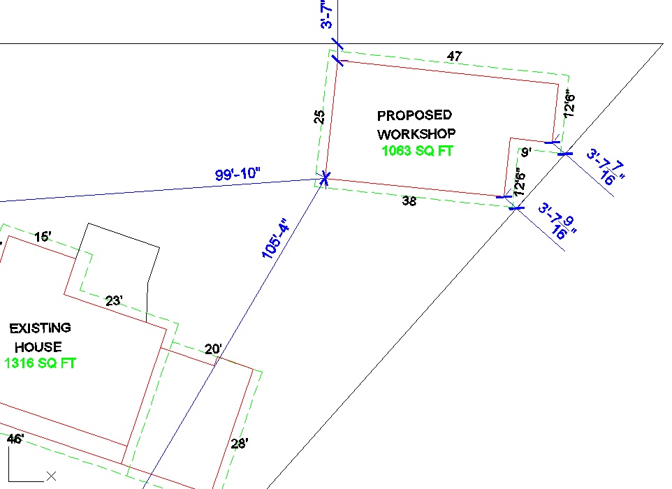

Can you rotate it so the side with the number 47 is parallel with that top property line?
I plan on some stock shelving above cupboards/cabinets which would store tools, chemicals, paint, etc.. Not drawn yet, as I haven't totally set anything in stone.
This is as large a shop as I am permitted to build. I have two vehicles currently that need to be stored there to a certain extent, and another I intend on building in the near future. I'm trying to make the most of what I am allowed.
I'd want a tooling cabinet closer to the machine tools.... keep the left hand end of the lathe open...
"Tools" on the left side are mechanics, and either benches or just rolling cabinets, for wrenching. I have another mechanics tool box just for machine tooling, which I may keep near the machines, or hang cabinets on the wall. I will relocate the lathe as that makes sense.
Initially I drew it like that, rectangular, with an access door into the corner of the yard. But marking it out in the yard and "driving" a vehicle too it makes the approach too sharp, so I angled it and it works much better.

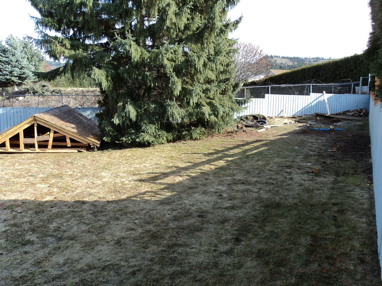

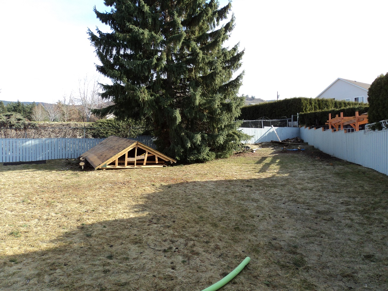

Click image to biggie-size:
View of the site so far, as viewed between the top left corner of the "existing house" garage (Plot Plan) and the fence.
.... and down the fence line.
With a rectangular 25x44 footprint, the corner of the shop would be at the middle of the three brown protrusions near the fence (used to be a grape arbor). With the angled dog-leg shop, the corner moves to the nearest of the four protrusions.
Tree will be felled in a couple weeks.

Shame to lose that beautiful tree. Plant 3 more to make up for it.
Where exactly is the septic?
How do you get access to the shop with cars? Is it through an existing garage on the right side of the house?
Can you make the garage parallel with the house?

Nobody knows where the septic is exactly; records weren't really done in 1977. I know where the tank is, but based on the lay of the land, how things may have settled, and the suggestion of growth over the field, it likely runs the full length of the house.
There is just enough access to get a vehicle in the back, between the house and the fence on the right.
Parallel to the house, eh? I don't think I've entertained that yet. Let me see what I can come up with....

Yes!
I like that much better. It relates to the house.
I like how the superimposed rectangle in the upper right corner
You can make it even deeper so tools and benches can be along the back wall, convenient to the hood and engine of cars. Move the man door around the corner into the left wall and eliminate the bench on that left wall, put it on the back wall. Slide the overhead door to the left.
Now, superimpose another, smaller rectangle, on the upper right, filling in a little more of the corner of the lot. That can be completely walled in from the rest of the garage, with a door for access. That room becomes mechanical, compressor, heat and water supply, utility sink, wash tank, storage, etc.
The bigger square that you have already defined, becomes the machine shop, with tools on both sides of the opening into the storage/utility/ compressor room.
Try it.....

OK,
But try out the 2 doors and putting the bench and toolboxes on the back wall.
And put the compressor room in the corner so it's side walls are end walls for equipment.
And locate the panel more centrally. And locate the man door on the side wall.
And don't forget a couple of windows.
This layout is far superior to the first one.

Rough elevation drawing.
G
gwellwood
May 31, 2011
223
Beautiful BC
I now have a deposit down on trusses.
Refining my structural drawing.
Question though - If I were to wrap the outside of the structure in extruded polystyrene, from footing to soffit, would I notice enough of an energy savings to counter the thousands that such an effort would cost?
I'm keeping in mind that it is merely a workshop, that I will not be using on a constant basis as I would a home or a business. I'm not sure the benefit would be there for the handful of hours every other day or less.
Click to biggie-size it
