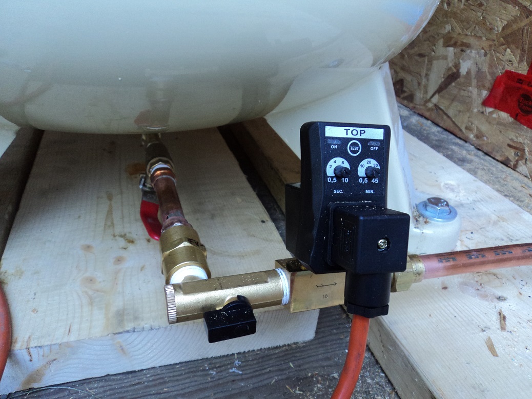

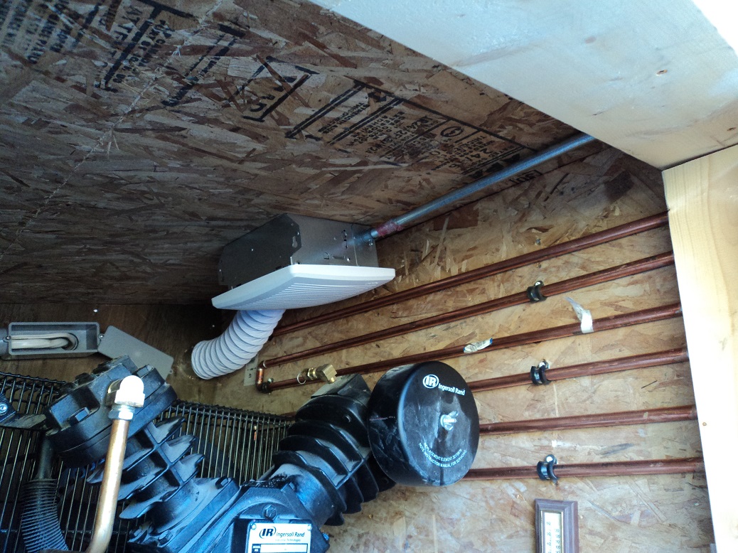

I've been building my Compressor Shed, and I kit you not, it is SO NICE to have the compressor out of the shop.
I ran 220V through 6/3 wire from the breaker into the shed, into a sub-panel. From there, I took 110V back into the shop, to a switch by the man door (I had this already wired before I drywalled), and to a light switch and wall socket in the shed.
The switch came back and split off to run a bathroom fan (vent near the floor to let make up air in), an outlet (for the auto tank drain), and a 220V Contactor to disconnect the compressor. This way I can hit the wall switch on the way out, and the compressor is off, the fan is off, and the blower-off-inator is off.
Shed is insulated on all 6 sides for sound, but I screwed up on the door, making it out of 2x4's and PT plywood, not thinking that your typical door knob is not designed for a 4.5" thick door. Took me the better part of the day cutting/welding/lengthening the guts of the door knob to make it work. But it works!

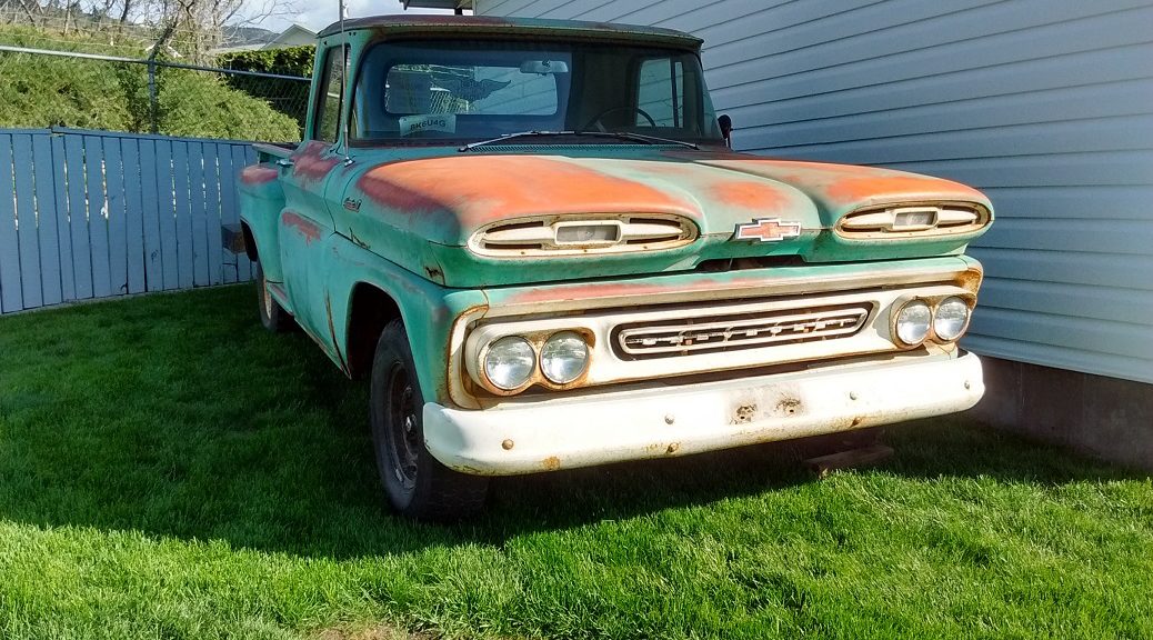

And then I bought another project:

Love the compressor shed and the 61' stepside. It has fantastic patina.

I'd -like- to keep the patina, but I can't stand the rust. If it was patina and rust-free, I'd totally Comet Wash it, and clear-coat it. But it's not at all rust free (though it's better than most you can find up here).
Since I want to drive it (as a daily, rain/snow/shine, from here on into retirement), I plan to blast everything, and do it proper with epoxy primers and powdercoating and whatnot. Make it last, and drive it. It's only a truck.

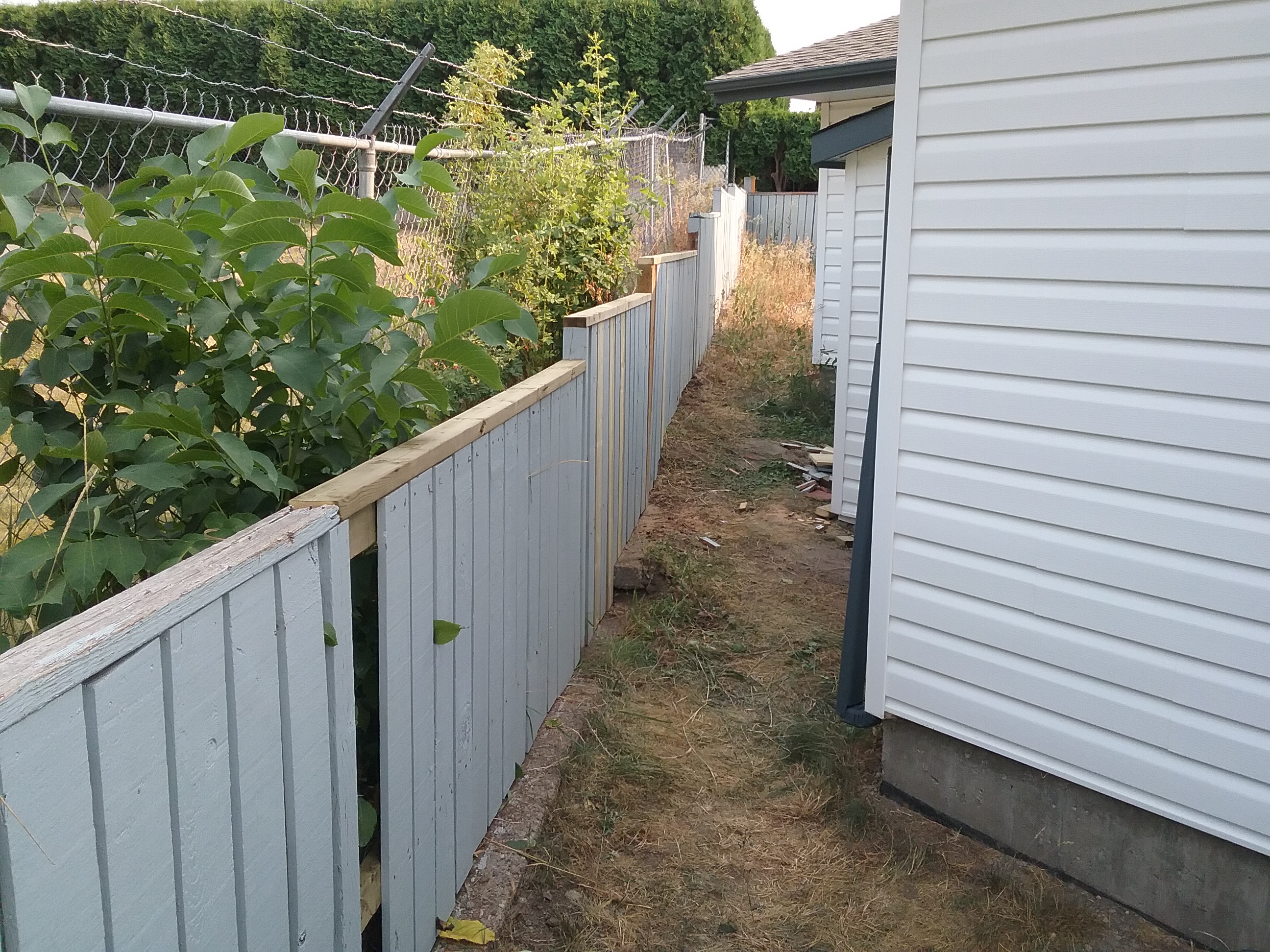

Got the fence put mostly back together. Three sections rebuilt. Need to buy two more boards.
The brown post is new - I had to dig the broken/rotter stub out of the 3.5" square in the concrete using a 6 foot wrecking bar, a 3.5" holesaw on a Makita Wrist-Breaker, and a shop vac. Shop vac for the win.

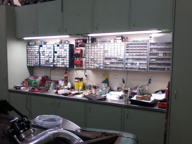

Trying to get the shop more organized and tidier (hahahahahahaha, yeah).
Princess Auto had a sale on 25' retractable hose reels at $60 CDN, so I bought two. They won't reach all the way across the shop, but I have a 50' one in the house garage that I'm going to bring over.
I merely cut the leg where I wanted the fitting to be, and flipped the leg over so the fitting was at the top instead of the bottom.
Presto! No more hoses tangled up and cluttering the floor.

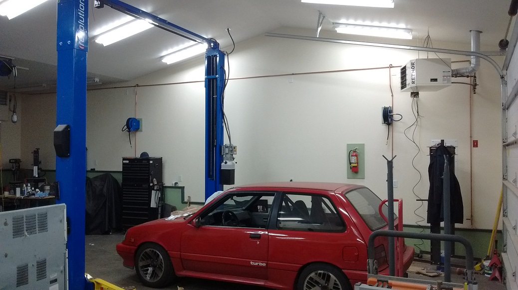

1066sqft, British Columbia.
Only it turned out to be 1065 once I finalized my design.
I was legally allowed to build up to 1076sqft, but I could not make that work without making a wall 33' 2-3/4" or something, and I decided it wasn't worth it. It is, essentially, the biggest I am legally allowed to build.
I love everything about the shop. It is the best layout and arrangement for where I wanted it. I especially love the colour - it's soothing; it's my creative world. I totally get lost in my world out there.
Wish I had put two power outlets in the ceiling for drop cords in the vehicle bay area. I have one in the fabrication area and wish I had more.
That's it.
