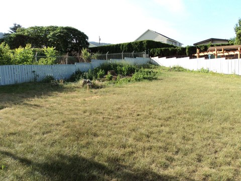

Met with excavator guy. Off-the-top-of-the-head numbers are much better than I feared. Says they can probably get to it in a couple of weeks.
Gas guy coming Wednesday, so I can know where to trench the gas lines from the house.

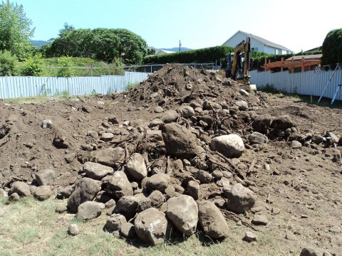

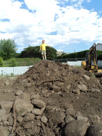

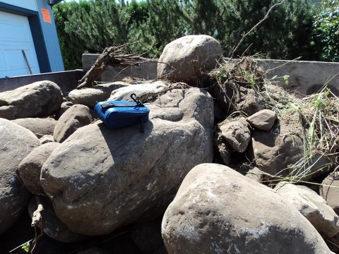

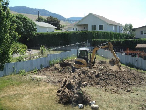

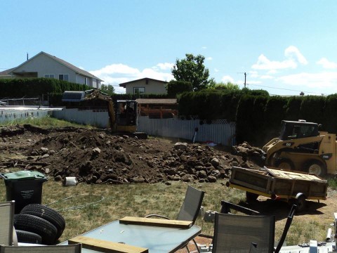

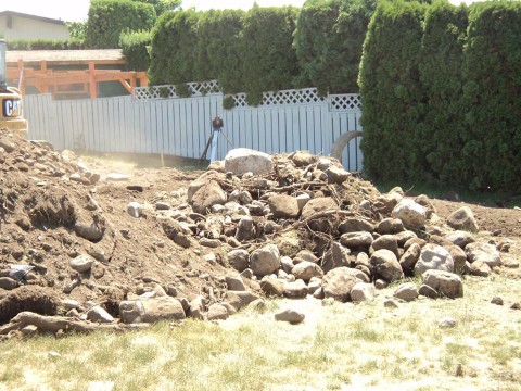

There are SO many rocks. I'm glad I'm "paying the man," because I can't lift these rocks, and it only takes about 10 or so to reach the max capacity of my truck. I'd be hauling rocks away for most of this year and next.
Digging of the foundation is done (three days). Surveyor coming out Monday to mark the foundation, and then I do the footing forming and await my first inspection.

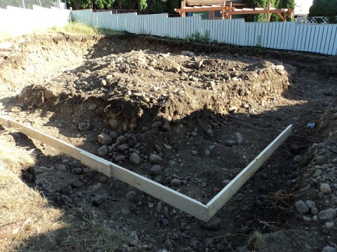

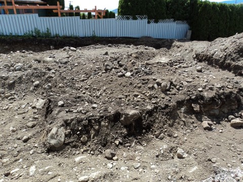

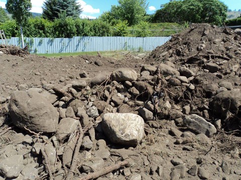

That photo with with the dump truck was Friday. They worked 7:30am to 11:00am, and hauled away FOUR dump truck loads of rock in that time. Friday was day three of digging. They left me the "small" rocks.
Back fence is further onto the property than I want. I'm allowed 1.0m setback, but I end up with much less space than that to the fence. I may move the building 6 forward to give me a bit more room to walk around.
Bought 2x8's for forming. Probably pick up rebar tomorrow.

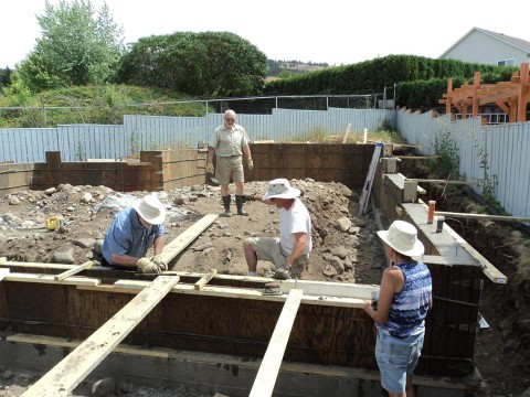

Starting the footing forms. 8" is required.
A workshop is never big enough. So.... I'm building as big as I can. That's me.... at the back.
Pops and me leveling the forms

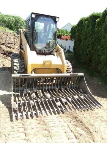

Excavators packed up their machines to head to another job, leaving me with a 5" crown to the "floor". Worker was pleased with how it turned out. I'm not.
Interesting to see how this pans out, but I am not impressed with that.

I had no reply from the excavators regarding the crown of the ground.
Started putting some walls up.
Slab guy came to view the site, saw the "crown" and said (and I paraphrase...) "Damn." He phoned the excavators, and they came back the next day.
Today I got a ton and a half of crush and spent the day leveling and compacting and leveling and I think we got it really good now.
Noticed that at some point the excavator wacked the foundation wall hard enough to crack it. Pure joy. Quite a few chips taken out of the stub wall door openings too. *sigh* Two fence posts got wacked (though one looks rotten - not really their fault). Overall, not really impressed.
