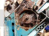

In early 2012 I got a good deal on a Craigs list CR 500. already had a 08 ktm roller in the garage. I had always wanted a cr500, and after doing two other bike engine swaps it seemed like a good idea.
The bike was a mess, had sat disassembled in a damp (and possibly flooded basement) for 10 years according to the owner.
When I got it home I dropped the cr5 engine into a 450sxf frame just to see how much work I had. other than some mount interference it wasn't too bad of a fit.
So at that point I cut the old mounts cut out and cleaned up the frame, then welded some back in positioned for the 500 engine
With the engine fitting in the frame I decided to tear it down for a full rebuild and long overdue cleaning. The head and cylinder were bead blasted. the cases were initially washed in my parts washer, then into a ultrasonic cleaner and finally media blasted using crushed walnut.
Because the cr5 engine is much narrower then the original KTM engine new rear case bushings were turned to position the swing arm (and thereby rear sprocket) in the correct location

I bought a home depot rental saw this past sept for $100 in non running condition. it was missing the handle and a coupe screws.
I got it home, disconnected the visibility broken kill switch and started it right up. Obviously the rental dept had qualified individuals working there.
I needed the saw for the next day, so I decided the only way it was going to function was to fabricate a handle. I also thought I should finally use by tubing bender that has been sitting unused in a box for 7 years.
I can say it worked well enough.
I found I really like the saw, but it had a couple issues.
1. It wasn't oiling the chain very well.
2. It marked its spot.
#1 was easy (or so i thought) it was a burned up pump drive
#2 Is a known issues with this model. The problem is there is no barb on the pump output. It relies on a compression to seal the pump to the line. So I added a barb.
That was all well and good but the more I researched, the less impressed i was with the pump design, it had some known flaws the limited the effective bar length to 28-32" depending on the individual pump. I set out to increase the output. It turned out it was relatively easy.
I machined a steeper 25 degree angle on the pump rotor for more displacement (excuse the wonky setup) that gave me more travel
I also machined a new oil control "bolt" to match the rotor. This should also solve the problem of the original plastic bolt wearing down / compressing.
and wile i'm in there I might as well add a larger bore.
and maybe port it
Though you should watch out as they tend to multiply
so far the modifications seem to work well
