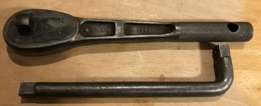

Here are 2, one reversible and one female DP. I'm also interested in knowing the origin of the pretzel mark on the 3/8 rats....I have some that have it and some dont, same exact style.26843c50137fa958641dd3166b3e8ef3.jpg7ff51b60b7cb2315fcce2df27e0a0fd2.jpg218f5d6cf36b7dd390e7199d6b4df909.jpg5236b7d2d49250a1fe3f022268565c37.jpg

I have a Husky H3183 unplated NR female marked J-S FORGED 11-44
Edit; Ill have to dig to confirm if it is an s or an 8. Done
31,055
Thanks, Slew. I'm betting that's a "J-S". Todd has the same ratchet with identical markings. And if I'm not mistaken, yours looks like it has a sheen of residue from the preservative we were discussing on the Long C thread.
