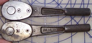

These are the only two I have with codes. Both are non-reversing female ratchets.
- Craftsman Circle-H ratchet. J-S 11-44
- Husky H318. T-S 10-46
Brian

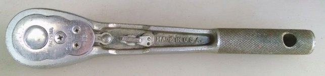

I've got these
Husky H3183 T-S 9-46
Craftsman circle H J-S 11-44
Craftsman BE Pat. Pend. no date

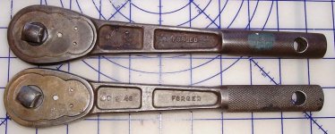

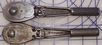

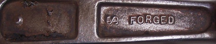

Lugz, I put a pointer to your new date code survey, in Post one for new visitors, and here are my 1/2 and 3/8's
Only one had a date code, of T 2 46, and interestingly, it was in the case with the heritage logo when I got it...
Also oddly, the NB 1/2 and the 2 Craftsman 3/8 had the drive on the side with the switch. The 1/2 Craftsman had the switch on the opposite side.
On the above Craftsman 1/2's Date code is T 2 46
The "non date code" has either a sideways "S" of a "69"; in the pic it looks like an S, but to the naked eye/magnifier looks far more like 69... :dunno:
