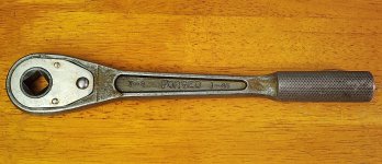

I feel Alloy Artifacts should present the Storms Drop Forge trademark with as thousands of their ratchets were produced and used during this World War 2 industrial period with the Serifs S vs the loopy Japanese S

The micro ball bearing selector definitely shows that the 1940 & on ratchets were derived off the Costello patent. If you look at the pictures all that was changed to go from the “franky” bolt version was remove the bolt and drop the sides for the thumb. I do believe they kept Pat. Pend. To keep the production running. And yes I think things were lax during once bombs dropped on US soil in 1941. I have several Sears ads with all kinds of bogus ratchets at the time. I honestly don’t think that they can be used as a credible timeline source. I thing my approach using engineering changes to the tool may not set a timeline but set a chronological order. The gist of my ratchets article was New Britain was using forges it didn’t own and they (Storms Drop Forge) did such a good job and Moore promised to continue using his forges and dedicate them to craftsman. No one has brought this up to my knowledge.

No I don’t - just the design of the vertical selector is a VLCHECK design and the handle looks like the early new Husky factory female ratchet thick handle designs. So from a “speculative” viewpoint that ratchet was a vlchek design made in a New Britain owned Husky factory. There was a level of cooperation between the 2 until then then New Britain could finally design their own ratchet to go with their own sockets not use or subcontract someone else. Enter the Costello Franky ratchet. Only two frankys I can find Circle H and Husky. Both made at the Kenosha Wisconsin factory. They kept toying with design, then New Britain sub contracted with Moore (Moore Forges-Pun intended) so they continued this sub contracting policy to handle the tremendous forging required. It backfired on them as Moore took over the contract and had built up his capacity so he didn’t have to sub contract out. Single source but also single name and distinct.

I think a lot of forgers sub contracted. Way more than we want to admit. I wish more would have put their forge mark regardless (Williams did a good job of this - others did not) so it’s hard to compartmentalize who made what. I think I’ve provided hard (tool) proof that the circle H and HUSKY ratchets were not made exclusively at the Husky factory and that New Britain sub contracted to Moore / Storms Drop Forge.
