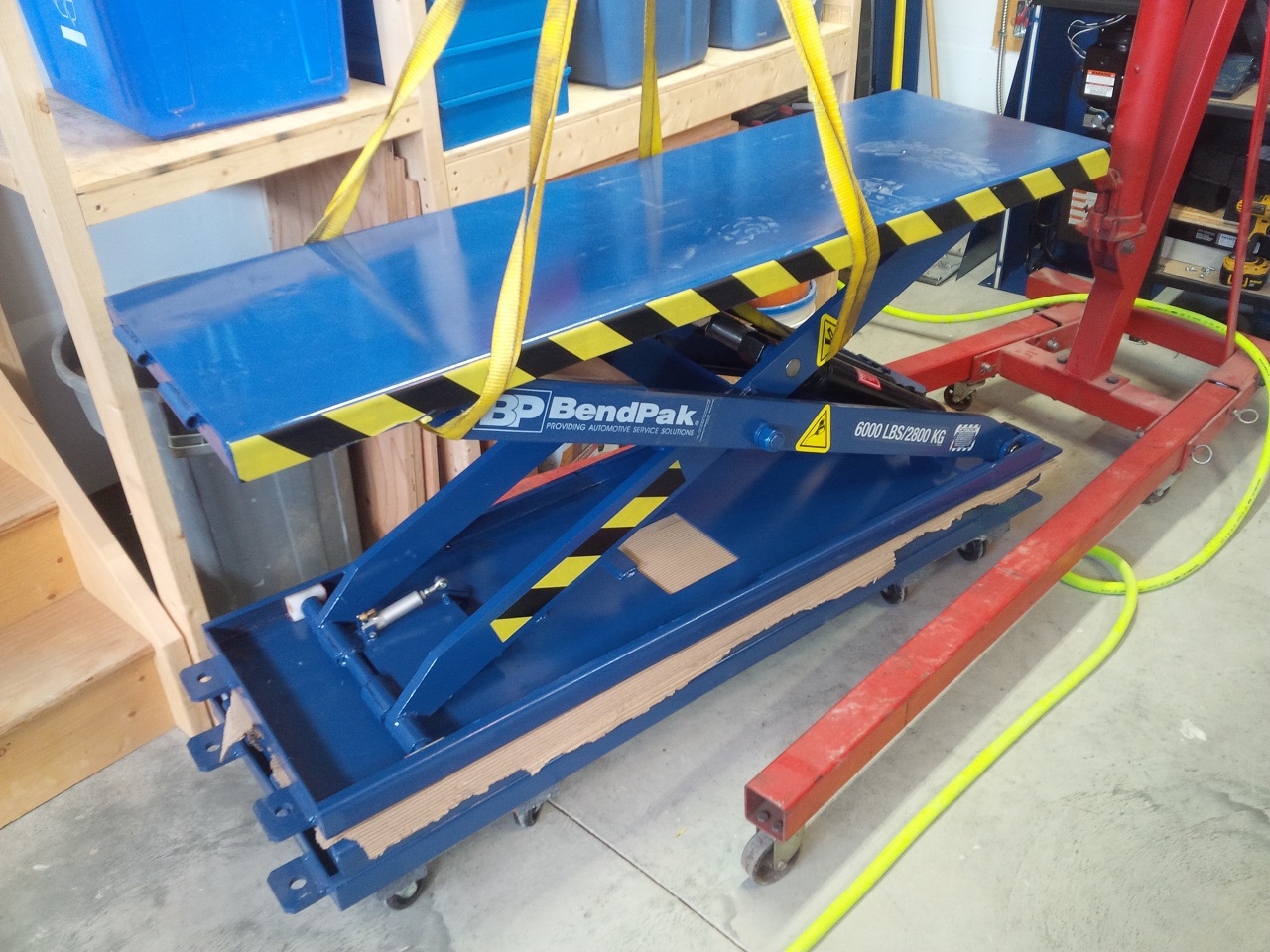

Well...it's here. Ignore the messy picture, I quickly ripped open the packaging so I could inspect the lift before the driver left.
Few scuffs in the paint, but no major damage. They sent floor pans which aren't needed on the 6KF but at least sent the right end caps and not the end ramps like the 6K, so all parts accounted for.
What a pain in the *** getting it off the truck though. It wouldn't fit on the liftgate with the pallet jack he had, so had to use the engine hoist and floor jack to wiggle it off. Took a half hour to unload it, should have taken 5 minutes...and I paid an extra fee to have residential delivery that I shouldn't have had to do squat to get it off the truck.
Oh well, the long wait is over.

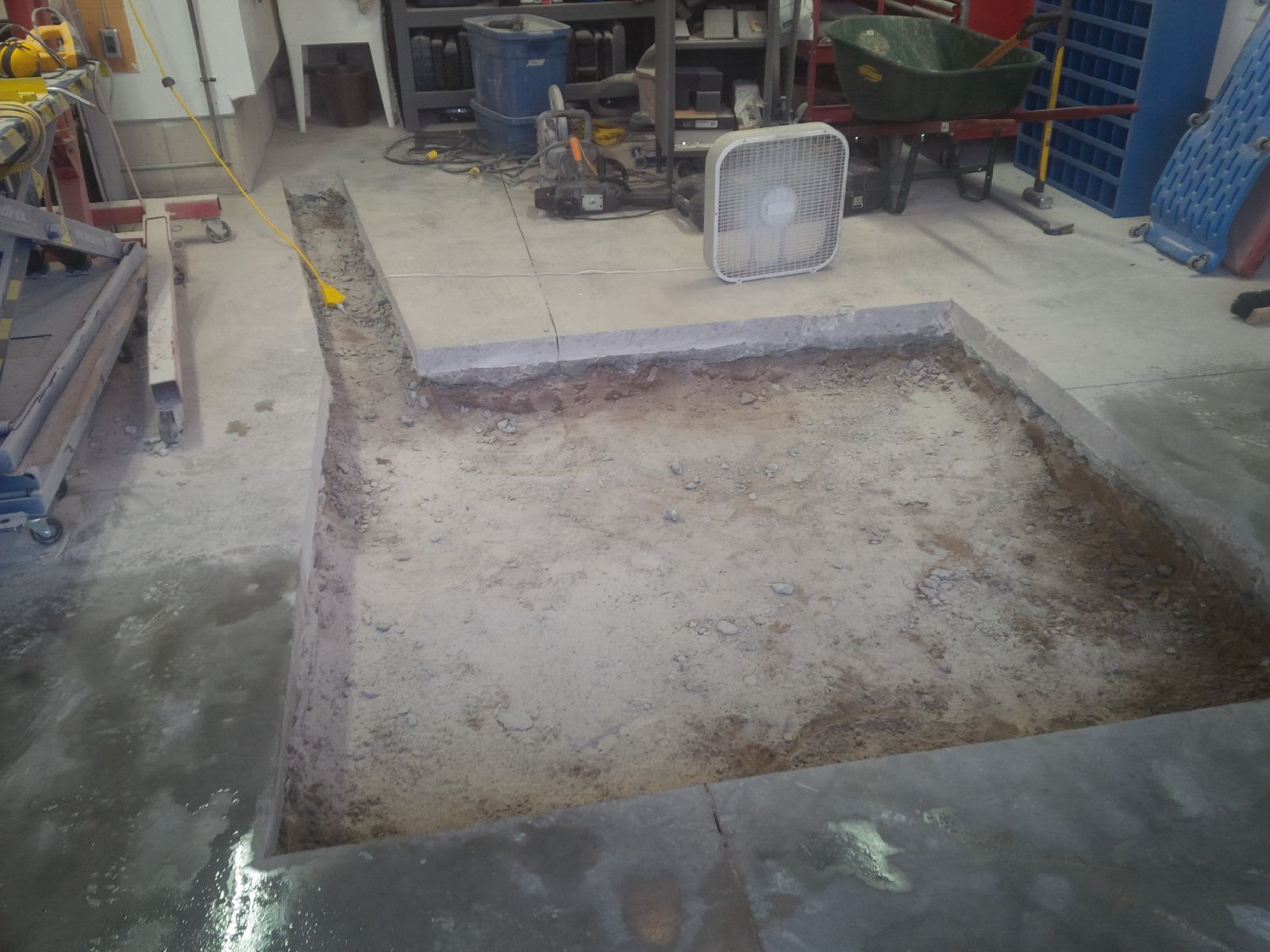

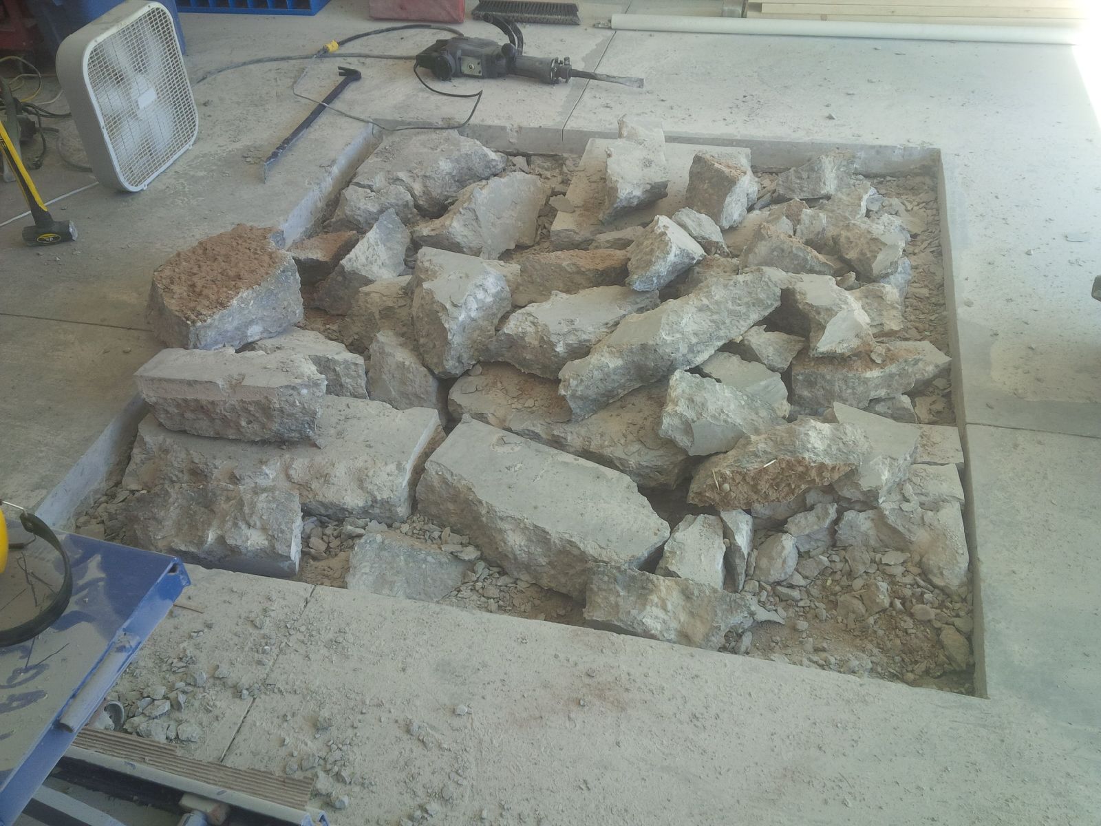

Started destroying concrete today. Opening up an 80" long, by 84" wide spot to work with. Could maybe have gone a few inches less but will make the sides thicker/stronger between the pits and the old slab. The diagrams from Bendpak for the lift pit size are accurate, maybe a smidge generous but I'm going to roll with their sizes.
When the house was built I had the builder put a 6" slab of 32mpa concrete in the garage. The idea was to put a small two post in originally, however they went ahead and saw cut control cuts right where the lift posts would go. So since I'd have to do concrete work either way, the mid rise scissor became an option and it's less in the way, it made a lot of sense. Anyway, the slab is ****** tough to jack hammer out...spent a few hours and probably only got a quarter of the way through. Luckily was picking up the pace once I got it all the way across, bigger chunks coming out at once.
Hopefully finish jackhammering tomorrow.

Do you have a concrete saw? Rent one it'll cut the time in half
Sent from my SCH-I545 using Tapatalk
ItsNemo
Mar 5, 2016
4,805
Canada

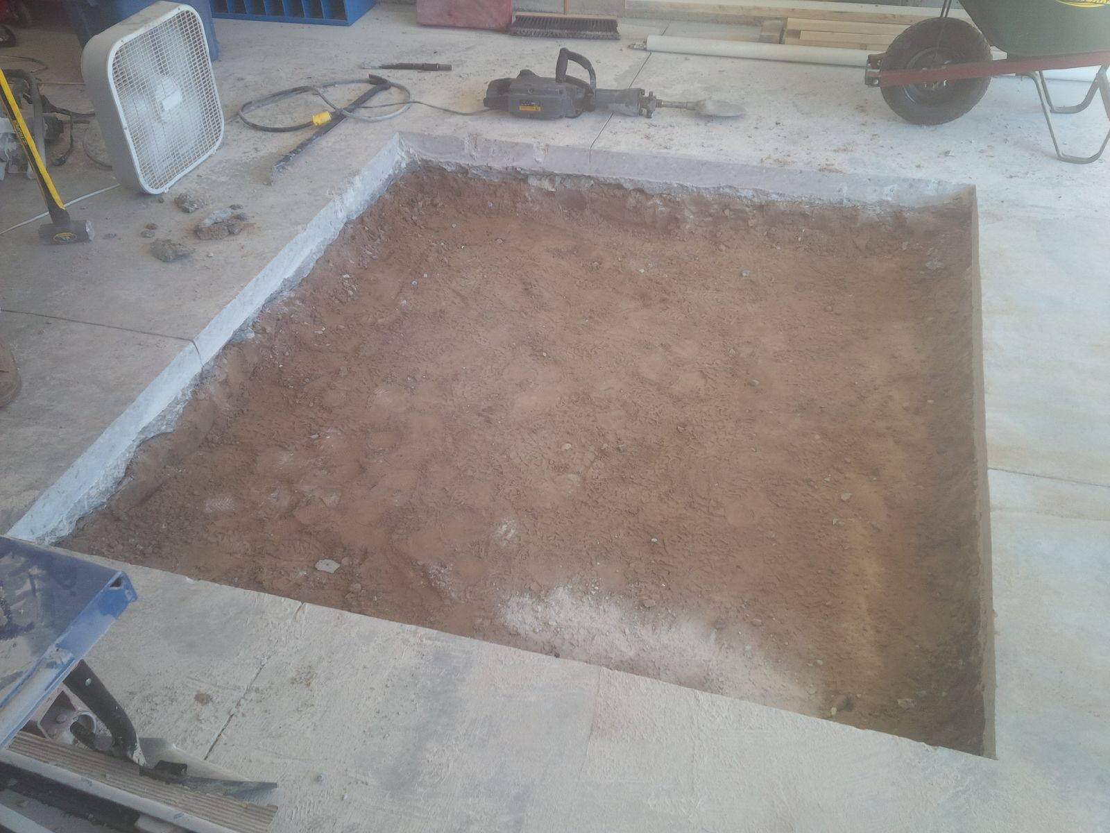

Yes, I cut the perimeter before jack hammering anything. It's only a 12" concrete saw though, so I get roughly 4" of cut depth, so doesn't make it all the way through.
Either way, got through the rest of it today.
Tomorrow going to clean everything up, get the depth level, and put some gravel down and if I'm really ambitious start on forms/rebar.
