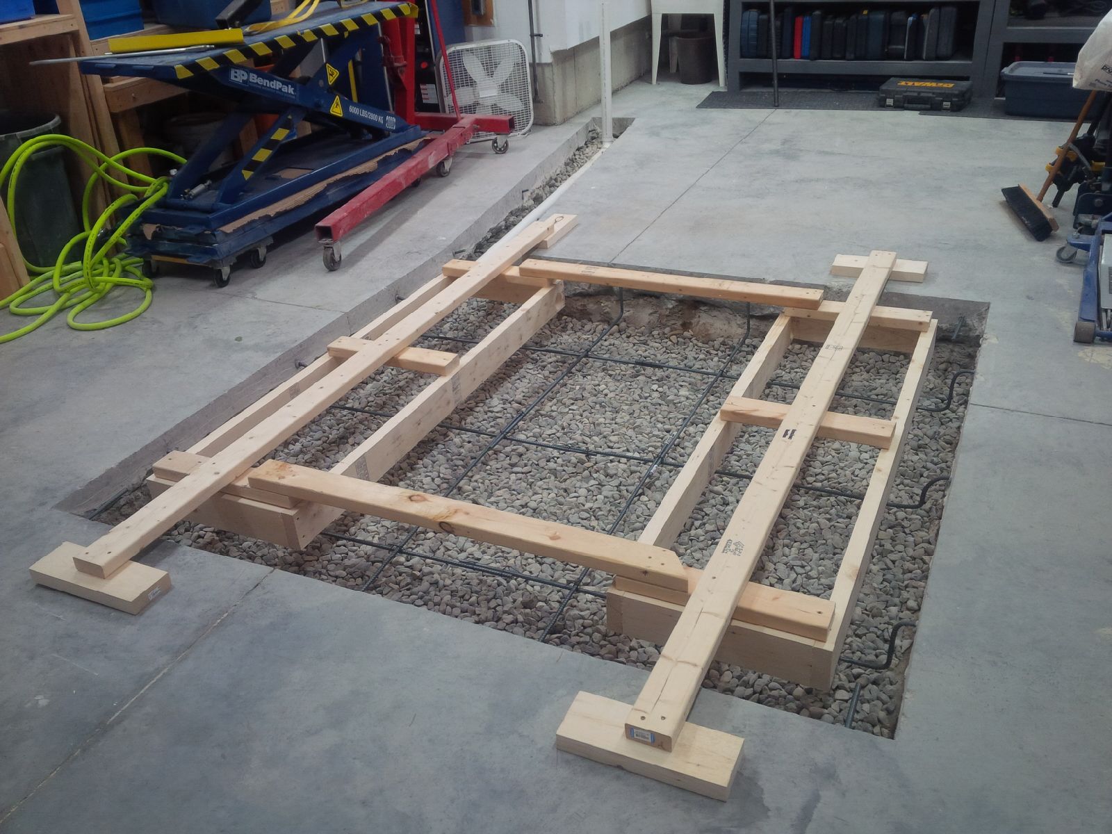

After measuring it all out, I put it dead center in the open space. Garage is 18' wide, there's 2' of shelving against the left wall, so it's centered in the remaining 16' of width. Depth wise, centered as well, 19.5' deep in the main area so 9.75' front and rear. I have an additional 6.5' at the back of the garage that has my work benches and box and such, so I end up with a nice space there to work under hood and room enough to pull my engine hoist clear.
My overhead door is an 8' to begin with and the tracks slope upward towards the ceiling and tuck in just above the height of a support beam that sticks down. It's basically a non-issue in the way of height. I have 4.5' clearance above my car and the lift is 42" on the top lock, minus 4 3/8" for sub floor height plus 1.5" for blocks and I will have no problem going right up to the top locks.
And yeah, stupidly dusty...but I wore a 3m N100 half face mask, goggles, and muffs, wasn't hard on me from the dust standpoint. Just sore muscles from cutting/jack hammering. Then just blew the entire thing out with compressed air when I was done.
ItsNemo
Mar 5, 2016
4,810
Canada
Couple little odds and ends left to do, but nearly ready to pour:
Need to get an extra chunk of pvc for between the two lifts, the one 10' piece I had wasn't long enough. Then I need to 100% center it up and screw down the form so it doesn't shift.
Anyone see any issues?

That looks like an awful tight elbow to shove hydraulic lines through. Have you tried stuffing your line(s) through it in advance? Just to be sure.
ItsNemo
Mar 5, 2016
4,810
Canada
I tried with just the elbow out on the bench, haven't tried the entire length...will give it a try today. Thanks for the suggestion, way easier to fix it now than when it's in the concrete :)

couple of questions:
do you plan on lifting the forms straight up and out once the pour is done?
Why the holes in the forms far corner about the same size as the PVC?
But now after looking at yours, I think I may have F'd up my forms by using 2x6s instead of 2x4s.
Once the pour is done and it's cured, up and out yup...if I have to cut them out tediously in pieces, so be it.
The single 10' piece of PVC I had didn't end up being enough to do between the two pits, I picked up another chunk yesterday and there is now a pipe going between the forms via those holes.
I used 2x6 for my forms as well, however I cut them down on the table saw to 4 3/8" as specified in the specs (gives 1/8" extra clearance from actual). This way the troweling is flat to the top of the 2x and hence why those cross braces are slightly smaller, so that it's easier to trowel all the way around the forms right up to the edge. I hope it works out :) I'm definitely no expert on this, first time for me, so I'm just kinda going with what makes sense.

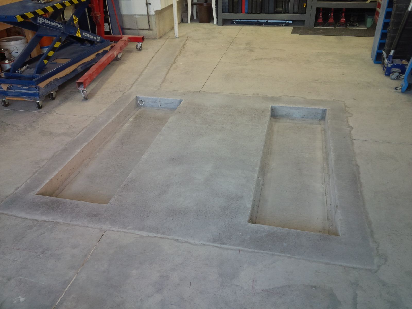

Concrete got poured yesterday morning, pulled the forms tonight. Turned out fairly decent, just need to do a bit of grinding to tidy up under where the forms were.

hopefully that hard 90 wont be a pain to shove the hoses through.
Should be fine, I pushed four lines through the elbow without much trouble. It's also only a couple inches below the surface so I will be able to grab the ends of the hoses with a pair of long pliers if I'm pushing the hoses in from the lift side.
I think I'm going to get custom hoses made up though, I need extensions anyway given the length. I was thinking I'm going to do a single long hose to each lift from the flow diverter and split at the cylinders. The bendpak hoses you split in the console and run four lines down to each cylinder individually which just seems silly.
NEMO any concern with the concrete cracking above the 2" pvc line?
My contractor was over this early am and had questioned me about it.

Nemo said Bendpak is sending him new hoses and air lock cylinders. I just had my concrete poured on Tuesday. So may be just a few more days before I have anything installed. (by days, I mean weeks or months. The way my build is going)
Got the new air lock cylinders and button...they actually have threads in the fittings, so that's a start.
The new hydraulic hoses I'm still waiting for. The new ones from what I understand are going to go male pipe thread directly into the hydraulic cylinders. The old ones I have now have a male pipe thread to male JIC adapter, which then gets a female JIC connection from the hoses. The length of the solid fittings/adapters causes the hoses to bend hard against the floor when at full rise, so the shorter fittings should allow the flexible part of the hose to do it's job.
So far I have no issues with cracking anywhere. The surface between the pits did get a little scuffed rolling the engine hoist over it roughly a week after the pour though. I might surface grind the entire part down smooth as I'm roughly 1/8" high in the middle anyway.
