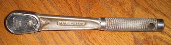

I bought this ratchet today at the swap meet for $3. It has no marking what so ever except for a patent number underneath the lever switch. I check the patent number and it belong to Duro ratchet. I check Alloy Artifact and they show the same exact ratchet, but it has company and other markings on it. Does anybody know anything about this ratchet. If it does belong to Duro, why they don't mark it. Is this a prototype? Is this a fake?

just wondering.... the other manufacturer... is it indestro?.... if so, duro and indestro were made by the same manufacturers.... if you look deeper, you will find wrenches, sockets and other drive tools being the same with only slight varations being the part numbers and names stamped into them... so, i would say no fake, it is either indestro or duro....
read the following... copy and pasted from alloy artifacts.... highlighting the duro connection...
Indestro Super 3202R 1/2-Drive Reversible Pressed-Flange Ratchet
In later years Duro added a reversing mechanism to the pressed-flange ratchets, and then offered them in both male and female drive. The next figure shows an example of a female drive reversible ratchet.
Fig. 147. Indestro Super 3202R 1/2-Drive Pressed-Flange Ratchet, with Insets for Side View and Reverse Detail, ca. 1945+. Fig. 147 at the left shows a 1/2-drive Indestro 3202R reversible female drive ratchet, marked "Pat. No. 1,902,878" under the shift lever, with "Indestro-Super" and the model number on the reverse.
The overall length is 9.4 inches, and the finish is chrome plating.
The ratchet mechanism uses an 18-tooth drive gear, slightly finer than the previous example but still relatively coarse.
Eddie Hudson
Sep 16, 2008
26
Duro also made tools for other companies, that's why it's not marked. It's real, and it is not a prototype.

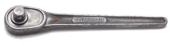

Thanks. The picture you posted does have the manufacturer on it. Mine has absolutely nothing other than the patent number. That is why the guy selling it so cheap ($3 for 1/2 drive) to me because he think it is an imitation. I took a chance.
30,015
The Indestro ratchet would be a model 3202R with the reverse lever (or a 3202 if it did not have the reverse lever.) both were 1/2" square female drive ratchets.
The drive adapter ("ratchet adapter plug") was a #3215 (with knurled knob), as shown on page 8 of 1948 Indestro Catalog No. 16
The 1959 Indestro Catalog No. 22 shows the 3202R ratchet on page 8, but not the 3202. The drive adapter is still a #3215, OR the #3205 square 1-1/4" extension could be used.
The 1935 Duro-Chrome catalog (page 25) shows the reversible model as a model 678D, but, like the photograph at AlloyArtifacts.org, the catalog shows it as having 'DURO-CHROME' clearly emblazoned on the handle, whereas the Indestro catalog illustrations of the Indestro model 3202R show no manufacturer's name. (Early Duro-Chrome catalogs available at ToolArchives.com)
US Patent: 1,902,878 - Duro Metal Products Co. 1933
http://www.datamp.org/patents/displayPatent.php?id=10709

photos of different samples of both the 3202 and 3202R ratchet from Ebay.
note that some have the part number and/or patent number stamped on them, some do not. one is stamped "Indestro Super":

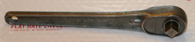

Indestro Super 2889 1/4" drive ratchet (missing drive adapter plug) recently listed on Ebay. For comparison purposes:
Indestro 2889 3.8 ratchet (Ebay2.1).jpg Indestro 2889 3.8 ratchet (Ebay2.2).jpg Indestro 2889 3.8 ratchet (Ebay2.3).jpg
The unit does NOT have a patent number or manufacturer's name stamped on it.
It is shown on page 2 of the 1948 Indestro Tool Catalog (No. 16) as a “Midget Reversible Ratchet”. The catalog says it is a 1/4” square female drive, not 3/8” drive.
The little widget that pops into the end of it so you can attach a 1/4” drive socket onto it would be a #2831 “Midget 3/4” short adaptor”, according to the catalog.
Its mate - the 2888 NON-reversible model, is shown in a photo posted above.

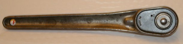

Indestro 3202 1/2" square female drive non-reversible ratchet with drive adapter - patent no. 1902878 - (photos Ebay 291695422911)
Indestro 3202 1.2 dr ratchet (Ebay1.1).jpg Indestro 3202 1.2 dr ratchet (Ebay 1.2).jpg Indestro 3202 1.2 dr ratchet (Ebay 1.3).jpg
note stamping "Chicago, U.S.A."
30,015
Indestro 3202 1/2" square female drive non-reversible ratchet with 3215 adapter - patent no. 1902878 - (photos Ebay) (as above, note stamping "Chicago USA")
Indestro 3202 1.2 ratchet (Ebay1.1).jpg Indestro 3202 1.2 ratchet (Ebay1.2).jpg
Indestro 3202 1.2 ratchet (Ebay1.3).jpg Indestro 3202 1.2 ratchet (Ebay1.4.jpg
Indestro 3202 1.2 ratchet (Ebay1.5).jpg Indestro 3202 1.2 ratchet (Ebay1.6).jpg
