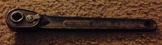

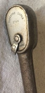

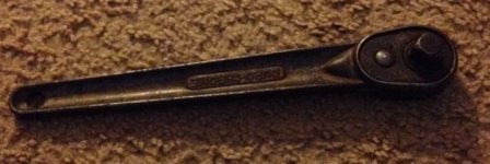

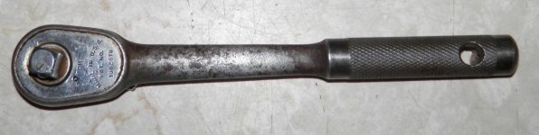

another Indestro Super 2789 3/8" square male drive reversible ratchet (patent no. 1902878) (photos Ebay)
Indestro Super 2789 3.8 dr ratchet (Ebay2.1).jpgIndestro Super 2789 3.8 dr ratchet (Ebay2.3).jpgIndestro Super 2789 3.8 dr ratchet (Ebay2.4).jpg
(* note the difference in the shank on this one and the one posted on the previous page in post #39 *)
30,038

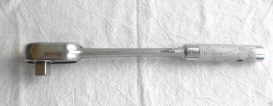

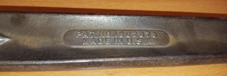

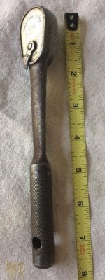

2278 Indestro Super 3/4" square male drive reversible ratchet (patent no. 1902878) (photos Ebay)
Indestro Super 2278 3.4 drive reversible ratchet (Ebay1.1).jpgIndestro Super 2278 3.4 drive reversible ratchet (Ebay1.2).jpgIndestro Super 2278 3.4 drive reversible ratchet (Ebay1.3).jpg
(* The 2278 model does not appear in either the 1948 or 1959 Indestro catalogs, nor is it listed on either the 1948 or 1959 price list. The 1948 catalog shows a 2276 non-reversible model only. I believe it is reasonable to assume that this model was manufactured at some point between 1948 and 1959.)

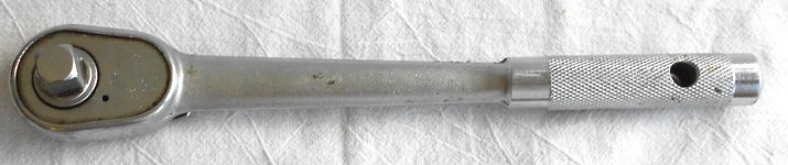

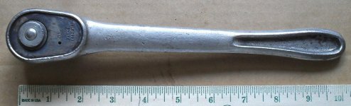

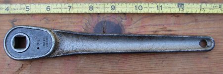

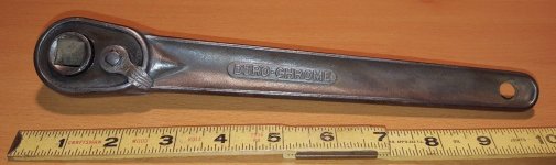

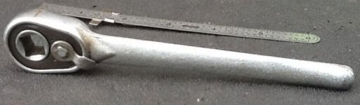

Let's begin with what I believe to be a Duro Chrome 679D 1/2" square female drive reversible ratchet - with the equivalent of the 692D Duro Chrome drive adapter - or is that really a 3215 Indestro drive adapter? (patent number 1902878) (photos Ebay)
Note the "depressed" handle, and NO manufacturer's name or part number.
Duro Chrome? or Indestro? Private label model, perhaps?
Duro Chrome (possibly 679D) 1.2 drive reversible ratchet (Ebay1.01).jpgDuro Chrome (possibly 679D) 1.2 drive reversible ratchet (Ebay1.02).jpgDuro Chrome (possibly 679D) 1.2 drive reversible ratchet (Ebay1.03).jpg
Duro Chrome (possibly 679D) 1.2 drive reversible ratchet (Ebay1.04).jpgDuro Chrome (possibly 679D) 1.2 drive reversible ratchet (Ebay1.05).jpgDuro Chrome (possibly 679D) 1.2 drive reversible ratchet (Ebay1.06).jpg

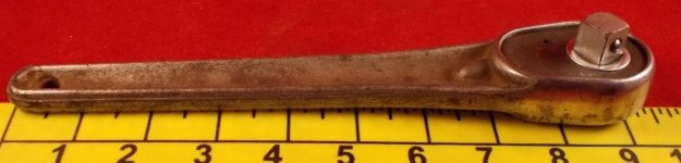

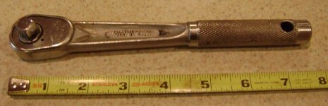

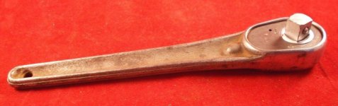

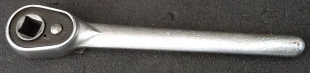

Here's what's believed to be a model 677 Duro Chrome 1/2" square female drive non-reversible ratchet. (patent number 1902878) (photos Ebay)
As above, note the "depressed" handle, lack of manufacturer's name or model number.
Duro Chrome? Indestro? Private label model, perhaps?
Duro Chrome 677D 1.2 dr non-reversible ratchet (Ebay1.1).jpgDuro Chrome 677D 1.2 dr non-reversible ratchet (Ebay1.2).jpgDuro Chrome 677D 1.2 dr non-reversible ratchet (Ebay1.3).jpg
* note as in the example above as well, the drive adapter more closely resembles the 3215 Indestro than the 692D Duro Chrome adapter as it appears in the 1935 Duro Chrome catalog.

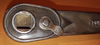

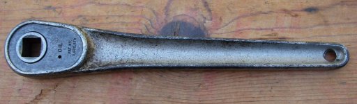

This one appears to be a 677D Duro Chrome 1/2" square female drive non-reversible ratchet. As in both example above, it lacks any manufacturer's name or model number, but is stamped with the patent number. (patent number 1902878) (Photos Ebay)

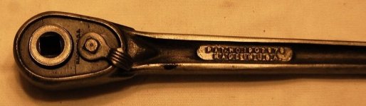

Duro Chrome model 678D 1/2" square female drive reversible ratchet marked with model number, patent number and manufacturer's name. (patent 1902878) (photos Ebay)

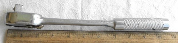

Duro Chrome model 4487 3/8" square female drive reversible ratchet. (patent number 1902878) (photos Ebay)
Duro Chrome 4487 3.8 dr ratchet (Ebay6.1).jpg Duro Chrome 4487 3.8 dr ratchet (Ebay6.2).jpg
Duro Chrome 4487 3.8 dr ratchet (Ebay6.3).jpg Duro Chrome 4487 3.8 dr ratchet (Ebay6.4).jpg
( see also posts #36 and #64 in this thread )
1935 Duro Chrome catalog page 22 shows two different models of "Cub" adaptors:
4493 - 3/8" x 1/4" reducing adaptor
693D - 3/8" x 1/2" increasing adaptor
So depending upon WHICH drive adaptor is in the unit, that 4487 can be 1/4”, or 3/8”, or 1/2” drive.

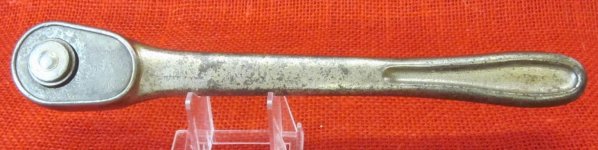

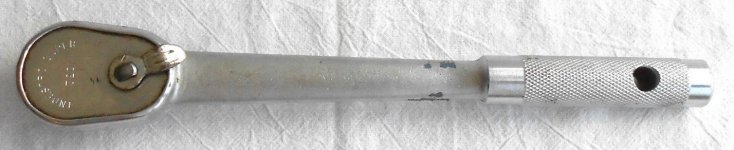

Indestro model 2889 3/8" square female drive reversible ratchet. Note difference in design of handle shape compared to the above samples. (patent number 1902878) (photos Ebay)
Indestro 2889 3.8 dr ratchet (Ebay2.1).jpg Indestro 2889 3.8 dr ratchet (Ebay2.2).jpg

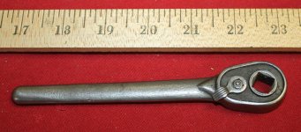

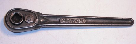

Indestro model 3202 1/2" square female drive non-reversible ratchet with 3215 drive adapter.
Note unit is stamped with model number, patent number, and "Chicago U.S.A.", but not the manufacturer's name.
Indestro 3202 1.2 dr non-reversible ratchet with 3215 adapter (Ebay1.1).jpgIndestro 3202 1.2 dr non-reversible ratchet with 3215 adapter (Ebay1.2).jpgIndestro 3202 1.2 dr non-reversible ratchet with 3215 adapter (Ebay1.4).jpg
Indestro 3202 1.2 dr non-reversible ratchet with 3215 adapter (Ebay1.6).jpgIndestro 3202 1.2 dr non-reversible ratchet with 3215 adapter (Ebay1.8).jpgIndestro 3202 1.2 dr non-reversible ratchet with 3215 adapter (Ebay1.9).jpg
Indestro 3202 1.2 dr non-reversible ratchet with 3215 adapter (Ebay1.10).jpg

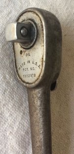

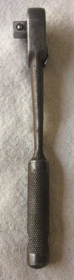

A model 3201 Indestro Super 1/2" square male drive reversible ratchet. (patent number 1902878) (photos Ebay)
Note unit is stamped with model number, patent number, manufacturer's name, and "Made in U.S.A."
Indestro Super 3201 1.2 dr ratchet (Ebay2.1).jpg Indestro Super 3201 1.2 dr ratchet (Ebay2.2).jpg
Indestro Super 3201 1.2 dr ratchet (Ebay2.3).jpg Indestro Super 3201 1.2 dr ratchet (Ebay2.4).jpg

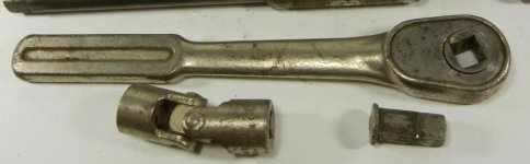

and yet another member of the family -
appears to be a model 3202 Indestro 1/2" square female drive non-reversible ratchet (with the 3215 knurled mushroom-head drive adapter.) (patent number 1902878) (photos Ebay)
note the flat handle with depressed center - a possible forerunner of the later "Select" series ratchets and breaker bars?
Indestro 3202 1.2 dr non-reversible ratchet (Ebay  5.01).jpg Indestro 3202 1.2 dr non-reversible ratchet (Ebay  5.02).jpg Indestro 3202 1.2 dr non-reversible ratchet (Ebay  5.03).jpg
(* universal joint in third photo is not a Duro or Indestro product - it's a Walden Worcester. the ratchet somehow found its way into a Walden socket set. *)

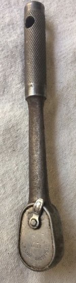

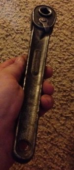

Here is what looks like the Duro Chrome 677P non reversible ratchet 1/2 drive that is noted in an erlier post that I have in my shop.

Thank you and welcome to the site, bogies! :thumbup:
I still think that one just above (post #57 - the one you currently have listed on Ebay) is one of the more interesting specimens of this "family".
As I noted in the email, I'm thinking it's possibly a unit made for one of Indestro's many private label accounts.

My Indestro Super model 2889 reversible 1/4 inch ratchet is male drive.
Edit edit: not that weird. I just saw the one you posted on page 3
It is very weird. (see post #60 in this thread)
Did Indestro run out of part numbers?
Or was it simply a design change (going from female to male drive) occurring some time between 1948 and 1959?
And then go up and check post #62 in this thread: two model 2889 ratchets, one is 1/4" female drive and one is 3/8" female drive, and neither appears to have been modified.
Maybe an early 1950's and an early 1960's catalog would help to answer some questions. In the meantime, I remain baffled. :dunno:

Indestro 2789 3/8" square male drive reversible ratchet (pressed-flange design) (patent 1902878) (photos Ebay)
note oval-shaped shank on handle. see also posts #39, #41, and #78
Indestro 2789 3.8 dr reversible ratchet (Ebay 182306199995 01).jpgIndestro 2789 3.8 dr reversible ratchet (Ebay 182306199995 02).jpgIndestro 2789 3.8 dr reversible ratchet (Ebay 182306199995 04).jpg
Indestro 2789 3.8 dr reversible ratchet (Ebay 182306199995 05).jpgIndestro 2789 3.8 dr reversible ratchet (Ebay 182306199995 06).jpgIndestro 2789 3.8 dr reversible ratchet (Ebay 182306199995 07).jpg
30,038
note depressed panels on handle. see also posts #39, #41, and #77
Indestro 2789 3.8 dr reversible ratchet (Ebay 302130452959 01).jpgIndestro 2789 3.8 dr reversible ratchet (Ebay 302130452959 02).jpgIndestro 2789 3.8 dr reversible ratchet (Ebay 302130452959 03).jpg
Indestro 2789 3.8 dr reversible ratchet (Ebay 302130452959 05).jpgIndestro 2789 3.8 dr reversible ratchet (Ebay 302130452959 06).jpgIndestro 2789 3.8 dr reversible ratchet (Ebay 302130452959 07).jpg

Some more pics for your thread here. I have several of these Duro Metal made ratchets. Here is a pair of the small ones. The unmarked ratchet has a 3/8" female drive with no plug. But when I bought it from the flea, it had some type of push driver attached, made by Dill Manufacturing. Making it some kind of early ratcheting screwdriver. So, there were other uses for these types, I'm sure.
I believe the handle on the unbranded ratchet just went without a final forging process to give it the Duro and patent stamps. The drivers are virtually identical.
