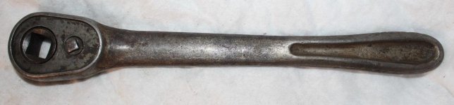

A rather anomalous 3202R 1/2" square female drive reversible model with a "paddle" handle.
Stamped with the Indestro model number, but no manufacturer's name or brand. (patent 1902878) (photos Ebay) (see also post 98)
Indestro 3202R 1.2 dr reversible ratchet (Ebay 322335744857 01).jpg Indestro 3202R 1.2 dr reversible ratchet (Ebay 322335744857 02).jpg
Indestro 3202R 1.2 dr reversible ratchet (Ebay 322335744857 03).jpg Indestro 3202R 1.2 dr reversible ratchet (Ebay 322335744857 04).jpg

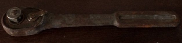

An Indestro-made 1/2" square female drive non-reversible model, equivalent to the Indestro 3202, but lacking any markings. (patent 1902878) (photos Ebay)
Indestro 1.2 dr non-reversible ratchet (Ebay 371792574728 01).jpgIndestro 1.2 dr non-reversible ratchet (Ebay 371792574728 02).jpgIndestro 1.2 dr non-reversible ratchet (Ebay 371792574728 03).jpg
Indestro 1.2 dr non-reversible ratchet (Ebay 371792574728 04).jpgIndestro 1.2 dr non-reversible ratchet (Ebay 371792574728 05).jpg

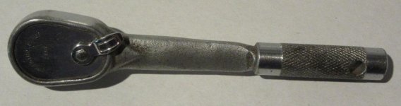

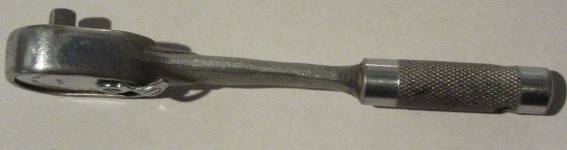

Indestro model 2889 1/4" square male drive reversible pressed-flange ratchet (patent 1902878) (photos Ebay) (see also posts #60 and #99)
Indestro 2889 1.4 dr reversible ratchet (Ebay 292007517996 01).jpgIndestro 2889 1.4 dr reversible ratchet (Ebay 292007517996 03).jpgIndestro 2889 1.4 dr reversible ratchet (Ebay 292007517996 04).jpg
Indestro 2889 1.4 dr reversible ratchet (Ebay 292007517996 05).jpgIndestro 2889 1.4 dr reversible ratchet (Ebay 292007517996 06).jpg

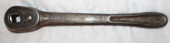

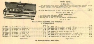

Indestro 2276 3/4" square female drive non-reversible pressed-flange ratchet (patent 1902878) (photos Ebay)
Indestro 2276 3.4 dr non-reversible ratchet (Ebay 112280278074 03).jpg Indestro 2276 3.4 dr non-reversible ratchet (Ebay 112280278074 02).jpg Indestro 2276 3.4 dr non-reversible ratchet (Ebay 112280278074 01).jpg
Made by Indestro Manufacturing Corp., located at 2649 No. Kildare Ave., Chicago, Illinois, USA.
The patent 1902878 was issued Mar. 28, 1933, but there is reason to believe ratchets using that design were made as early as 1932 (see http://www.datamp.org/patents/displayPatent.php?id=10709 )
I am unfortunately not able to find the item listed in the 1935 Indestro catalog, although it does appear in the 1935 Duro Chrome catalog as a part number 4276. (Duro Chrome was Indestro's "sister company", they both operated under the same roof, but as separate business entities, both making exactly the same tools, but using different part numbers in most cases.)
The earliest reference I can find for 3/4" drive being made available by Indestro is in the 1938 Jensen-Byrd catalog, where they advertise an Indestro 2210 3/4" drive "heavy duty" socket set.
It appears in the 1948 Indestro catalog No. 16 on page 22, and the August 27, 1948 price list shows it as having a suggested list price of $18.20 and a "mechanics net" price of $10.92.
It does not appear in the 1959 Indestro catalog No. 22.

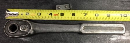

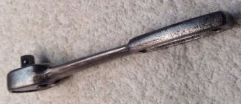

Another 3202R 1/2" square female drive reversible ratchet with flat "paddle" handle (see post 82) (patent 1902878) (photos Ebay)
As on the example in post 82, unit is stamped with model number and patent number, but no maker's name. Shown with model 3215 drive adapter plug.
Indestro 3202R 1.2 dr reversible ratchet (Ebay 332103487433 01).jpg Indestro 3202R 1.2 dr reversible ratchet (Ebay 332103487433 02).jpg Indestro 3202R 1.2 dr reversible ratchet (Ebay 332103487433 03).jpg
Indestro 3202R 1.2 dr reversible ratchet (Ebay 332103487433 04).jpg Indestro 3202R 1.2 dr reversible ratchet (Ebay 332103487433 05).jpg Indestro 3202R 1.2 dr reversible ratchet (Ebay 332103487433 06).jpg

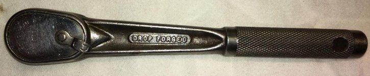

Duro Chrome 4587 1/4" square male drive pressed-flange reversible ratchet (patent 1902878) (photos Ebay) (equivalent to Indestro 2889) (see also posts #60 and #85)
Duro Chrome 4587 1.4 dr reversible ratchet (Ebay 272535611688 01).jpg Duro Chrome 4587 1.4 dr reversible ratchet (Ebay 272535611688 02).jpg
Duro Chrome 4587 1.4 dr reversible ratchet (Ebay 272535611688 03).jpg Duro Chrome 4587 1.4 dr reversible ratchet (Ebay 272535611688 04).jpg

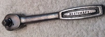

Westcraft (Western Auto private label) 1/4" square male drive reversible pressed-flange ratchet (patent 1902878) (photos Ebay) (equivalent to 4587 Duro Chrome or Indestro 2889, but with flat handle.) (see posts #99 and #60 )
Westcraft 1.4 dr reversible ratchet (Ebay 282351970612 01).jpg Westcraft 1.4 dr reversible ratchet (Ebay 282351970612 02).jpg Westcraft 1.4 dr reversible ratchet (Ebay 282351970612 03).jpg
Westcraft 1.4 dr reversible ratchet (Ebay 282351970612 04).jpg Westcraft 1.4 dr reversible ratchet (Ebay 282351970612 05).jpg
