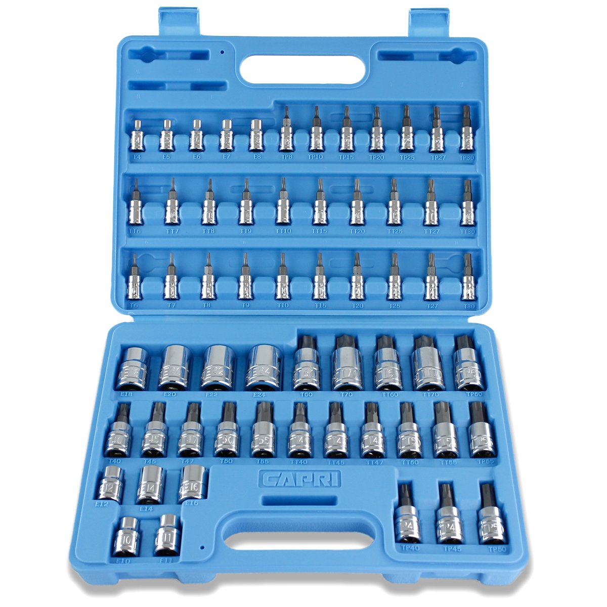

Capri Tools Torx Socket Set, 60-pieces, $45.

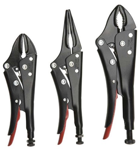

Stanley Proto Locking Pliers Set, 3-piece, $45.

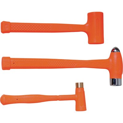

Ironton Hammer Set, 3-piece, $15.
Stanley Fatmax 3# Drilling Hammer, $16.
Stanley 1# Rubber Mallet, $6.

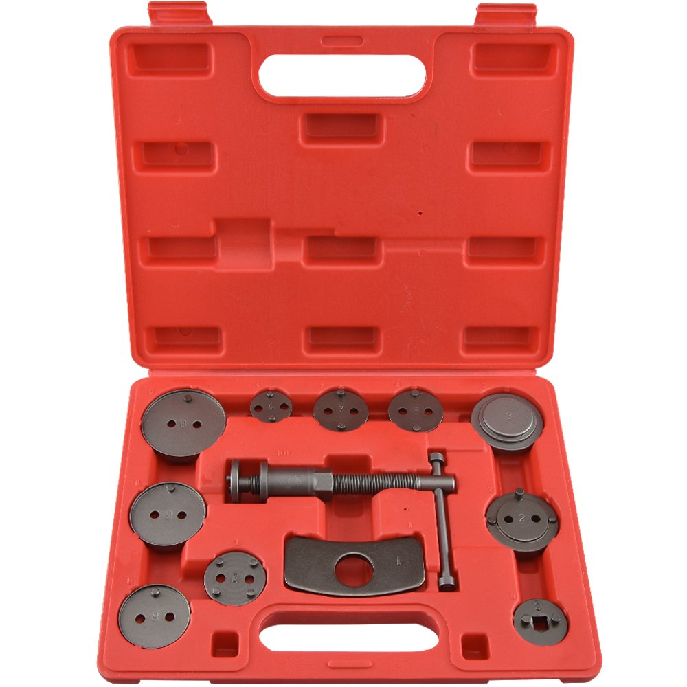

Astro Brake Caliper Wind Back Set, 18-piece, $30

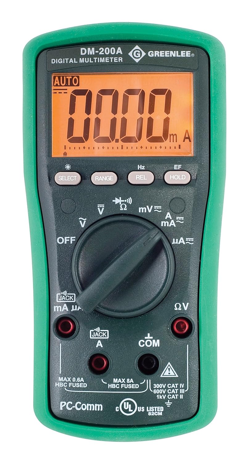

Greenlee DM-200A Multimeter, $96.
I'm sure that it is a nice unit, but wow is it short on functionality. Hooking up to a PC is a nice feature, but not really useful for automotive work, and I've got a nice bench DMM.
The Innova has some useful features, like a tachometer, that would be VERY useful, so I'm sticking with it for now.

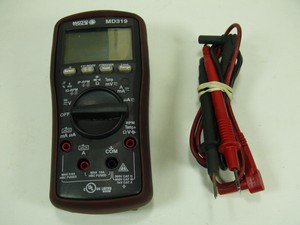

Matco MD319 Multi-Meter, used, $100.

OK, the pliers situation has really been ticking me off. I originally had Irwins picked out, because I've had good luck with them, only to be told that they were cheap junk. So I spec'd out the high end Stanleys, and got the same reaction. Apparently, if you aren't using Knipex, Channellock or a truck brand, you aren't worthy to actually use your tools professionally.
Well, that's an attitude that I am sick of, so these are going on the list as alternates to the Stanleys:
RWIN VISE-GRIP GrooveLock Pliers Set, 8 Piece, $80.

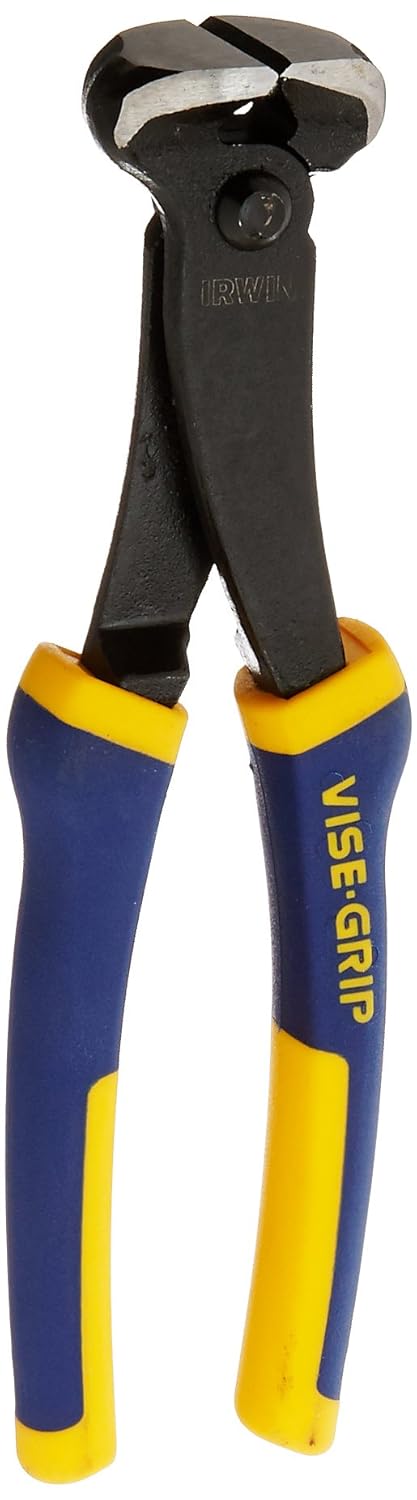

IRWIN Tools VISE-GRIP End Cutting Pliers, $14.

Also look at Owon for budget priced meters that are heavy on features. The Innova is probably fine but you get a lot with an Owon, and most models have Bluetooth which comes in amazingly handy at times. 6331526b88437c3dfe5d21502e78b07d.jpg

Personally I'd replace all the Irwin with channellock for a comparable price, but you did say you're a fan of Irwin so I wouldn't try to convince you otherwise.
Agreed, I love my channellock tools. I'd throw another larger size channel locks on your list also, regardless of brand choice.

Personally I'd replace all the Irwin with channellock for a comparable price, but you did say you're a fan of Irwin so I wouldn't try to convince you otherwise. That Irwin stripper though, ditch that and get the auto version. I use mine heavily on a wide range of wire sizes and it beats every other stripper I've tried. Its the only Irwin tool I'd buy other than my NWS rebrands which I love.
I have some Channellocks, and they are pretty good, but I like the thicker grips that Irwins come with.
Like I said, I've got some Channellocks, and they work well (even if they do rust like bastards...), but I prefer thicker grips. I have big hands.
I could easily upgrade to this set:

I'd spend twice the money and get a better wind back tool for calipers. The cube is a bit wonky to use and the kits with specific adapters aren't much more. The long gearwrench wrenches are very nice. I have the smaller set that only goes to 19mm-1". Just don't do what I did and buy the six point version. More trouble than its worth.
Lol, and that was an upgrade to my usual technique of wedging a flat-head screwdriver in there and levering them around... :)
They are cheap enough to grab a big set, though, you are right.

Dump the junk Innova multimeter and get a Greenlee DM200a. It's about the same price and a much better meter. Even better is get the DM210a or a Matco DM257. All of the above are variations of the same Brymen based meters. If course you can do even better if you are wrong to look used.
It's so weird to look at expensive meters with so few functions.
Here's my current DMM:
Bear in mind, it cost $80 20 years ago.

2) Skip the cube and get an actual brake caliper set. HF actually sells a nice one and it will save you a lot of time and frustration.
Both of those changes and you'll still have money left.
Thanks,
Robert
Well, the HF set is stupid expensive; $50!
Neiko makes a set for $20:
https://www.amazon.com/dp/B000IB40L6/?tag=atomicindus08-20

I use that Greenlee daily at work, it's a good DMM and I personally like it better than the Flukes.

I got the previous version of that innova on sale $50 thinking I'd replace it with a Fluke when needed. My 2 gripes were no ACV, and a funny special order fuse for the 10amp lead.
Oh, and its needed batteries every year or two, so I've bought at least 10 of those.
Well, I shouldn't need ACV working on cars... :)
Beyond that, if you have had it for 10 years, then that is a pretty solid recommendation.
Edit: This model has ACV, so there is that. I still wouldn't use it for my bench DMM, though, because it doesn't have inductance or capacitance meters. Neither does the Greenlee.
I briefly had a lower end Innova. It had some nice features but was generally junk. That was OK when it was $20. This is $75 and I'm just not willing to accept some of the flaws given the number of good meters that can be bought for the same money (new and used)
I don't like meters that don't have a fuse on the high current range. I fixed a Matco meter that was blown because someone replaced the high current fuse with a screw then decided to measure something high current. I'm not sure that automotive meters need buss fuses but they should NEVER have no fuses on the current range given your average car battery can source well over 100 amps.
I also just found the Innova to be cheaply constructed and the probes were low quality. For $75, why go with something cheap?
For similar money I would really suggest used based on a quick ebay search these would rise to the top of my list (no connection with the sellers! )
Matco (Brymen) automotive meter
http://www.ebay.com/itm/Matco-MD319...318835?hash=item465ede0333:g:fhAAAOSw4CFYt2Xe
Matco's version of the Brymen 257 meter. I'm guessing this will sell for under $80
http://www.ebay.com/itm/Matco-Tools...639098?hash=item4d63033fba:g:1vAAAOSwLQpZswiF
This is a very good meter "untested is always a risk so I would probably pass but if you knew it was good this one is a great value (also Brymen based)
http://www.ebay.com/itm/Amprobe-AM-...060493?hash=item4400415fcd:g:ELAAAOSwuxFY0BAH
This and the identical 270 are are new around $110. Under the skin they are the same as the Greenlee DM-820 (not 820a).
Here are some Greenlee 820s. I've seen these for about half this price from time to time.
http://www.ebay.com/itm/GREENLEE-HO...518419?hash=item2129a3c113:g:CK0AAOSw9~5ZWBBF
http://www.ebay.com/itm/GREENLEE-DM...167478?hash=item283e7e77f6:g:eMIAAOSwzPdZqPRr
Greenlee 820A. This is the replacement model for the one above. Big but very nice. It has all the features you need (you can calculate RPM, dwell etc from the frequency and duty cycle fuctions. I bought one of these in serviceable shape for $60 off ebay.
http://www.ebay.com/itm/GREENLEE-Tr...785428?hash=item5d7559ea14:g:OVwAAOSwbURZsx7V
I'm not actually a Brymen fanboy but it's hard to argue they produce a great meter for the money. I've found some killer Fluke deals as well (the old tank Fluke 27 can be had for under $40 quite often and they have the GREAT Touchhold feature (not Hold, Touchhold)) but the Greenlee and Amprobe Brymens just seem like the most consistent deals.
The China Fluke are also good options. They range from the 101 for around $50 to the 17B for a bit over $100. They might be Flukes for the Chinese markets but they live up to the Fluke name.

The Capri Hex set is bigger for just a little more money. Sold.
Made by Grip-On in Spain. Same price as the Irwins basically and much better.
