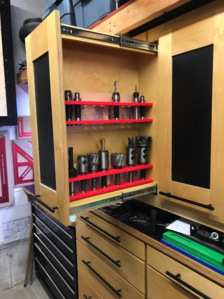

The cabinets above the lathe are the result of a wild hair I had back when I did the first attempt on shop organization. They’re telescoping cabinets which allow me to pull them towards me before opening the doors. Idea was to be able to get stuff out of the cabinets without getting grease or oil off of the lathe on my clothes. These are no shabby cabinets. They’re glued, stapled, and screwed running on dual 100lb slides.
The one doing the most work is my lathe tooling cabinet. Within that cabinet alone is 19 Aloris CA tool holders, some really big chucks, and a few big boy routers.
They were designed to make it all the way out over the lathe. This may give a better perspective. At full extension these hinges are straining just a little (but hanging in there).
There’s three of these telescoping cabinets that I’ve struggled to fill with stuff. Not because I don’t ave stuff to put in them, but because the size I arbitrarily made them isn’t conducive to much stuff. Their either too deep or not deep enough or too narrow. Neat idea, kinda fail.

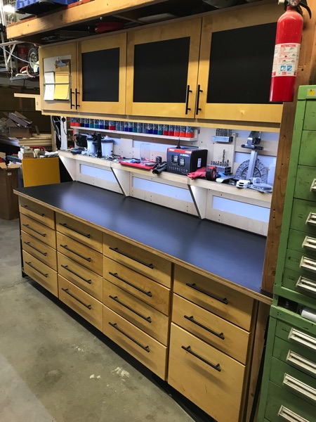

This cabinet is/was the perfect segway to the next section.

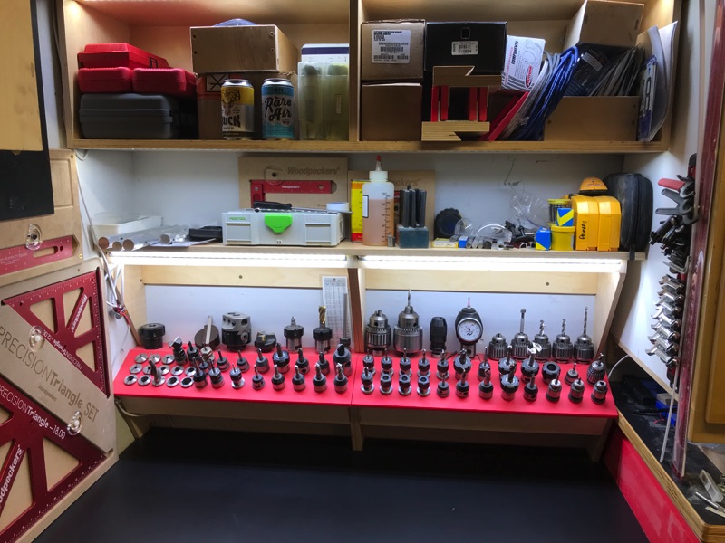

This tooling cabinets will be going away. The original goal of this and the cordless drill cabinets was to keep my tools stored out of sight. After a few years of use, I found that the tools I use most frequently were often stored outside of the cabinet to make them more accessible. An example of this is my R8 tooling. When I’m machining something, it’s kinda a pain to have to go into the cabinet multiple times and, as my collection of tools increased, it’s also limited in how many it can hold. I also didn't like that the bench top below them was so close that I couldn't really leverage it as work surface. It was perfect as a catch-all storage space...thus the reason it needs to go.

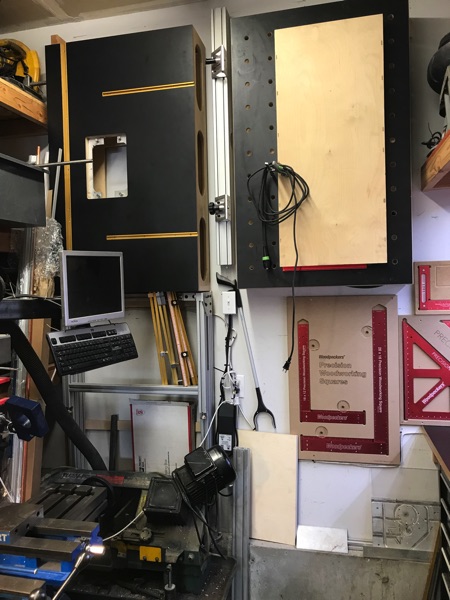

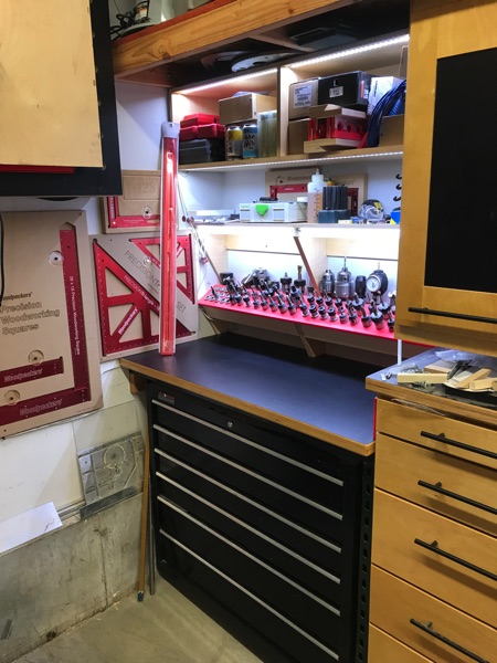

This tool bench was documented in the previous thread. It's in the back corner and a perfect swivel from the mill which makes it a perfect and well lit area to set up my tooling and store all of it in an easily accessible way. Unfortunately I build it to fit the tooling I have and left no room for expansion. My new setup should allow for a little more tooling capacity.
What you see isn’t fully finished but it’s finished enough to be fully functional so progress has stalled (more appropriately is “I’ve focused efforts elsewhere”). I’ve yet to build the frame for the cabinet or the shelf which will conceal the visible LED light strips. These are the tools that I most frequently use when machining and the red material is 1/2-inch thick cutting board.

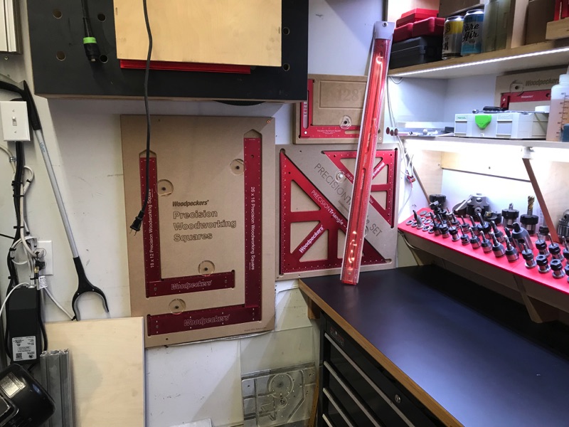

To the left is my make-shift woodpeckers measuring wall shrine. What’s great about having such large measuring tools is that larger layouts becomes much easier and more exact/consistent. Sure a tape measure works but remember, I’m a machinist that woodworks. The accuracy of “the same” is very different between metal and woodworking. Given their size, about the only place I have to store them is the wall. No drawer or cabinet I have will fit the bigger ones...which totally ***** (I'll be solving this).

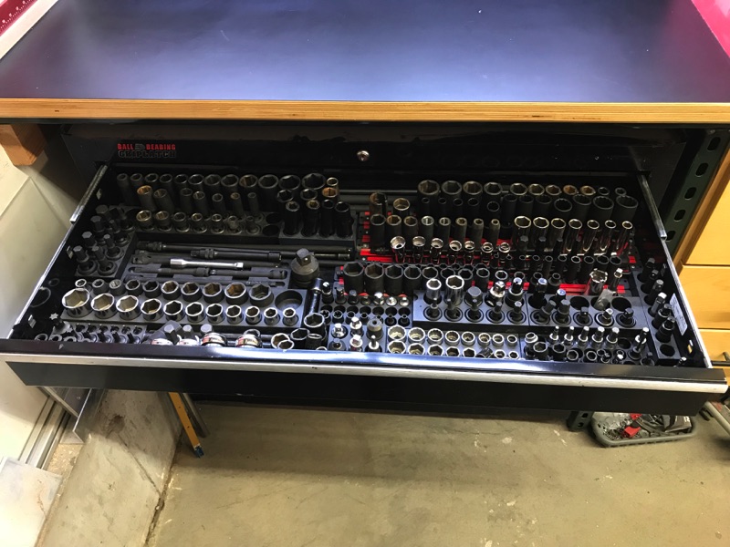

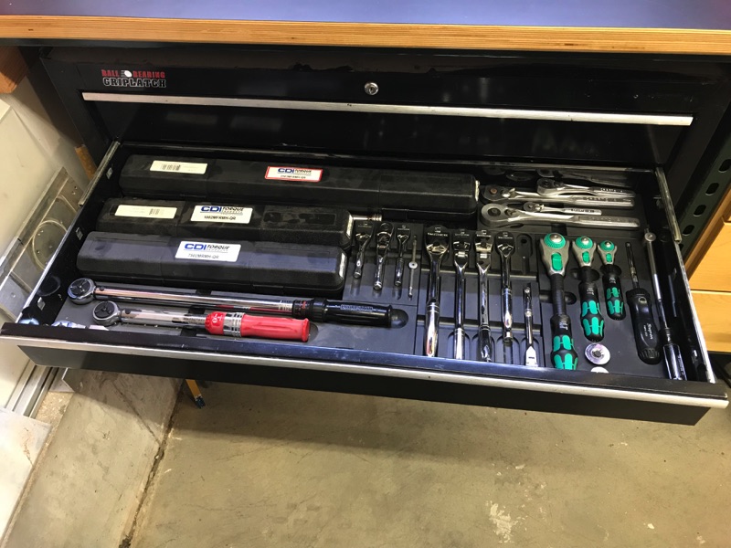

Below the tool bench is a craftsman 41” base that’s mounted into a uni-strut frame (like many GJ members are doing with the HF cabinets). This cabinet is where I keep most of my wrenches, sockets, ratchets, etc. Here are a few of the more organized drawers that I also documented in my old thread. First one is thicker HDPE (cutting board material) that I machined into tooling holders. The drawer is organized semi-ok. The socket trays aren't organized in such a way that it's easy to find tools. Usually people organize by drive size or type of socket...this drawer is organized by organizer size. The HDPE organizers I cut fit really only one way if you want everything to fit in the drawer and, even when you do get it right, there's absolutely no room for expansion. Both of these situations are gonna get fixed.
Second is the drawer that I have all my ratchets stored in HDPE trays. this is one of few drawers that I feel is really done. The only thing I don't like about it is I'd really also like to put my impacts and other drive tools in this drawer so all of the same tools are in the same place. Add that to the list of changes to come.
The other drawers look like everyone else’s. Mechanic time saver rails and wrench rails. I'll leave those out of this tour but note that I also want each of those drawers to have more room for expansion.

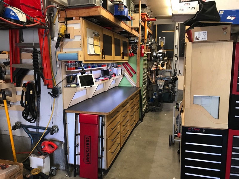

Now to the opposing wall. Kinda difficult to see the entire thing but there’s a bench, actual tooling cabinets, and my CNC Knee Mill.

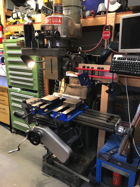

I’ll work from the furthest back out…so the Knee Mill. It’s a 9 x 24 Kent USA Knee that I retro fitted with a Centroid CNC system. I've built more things with this tool than with any other. If I lost everything today, I'd get another CNC almost immediately. Back when I had the machine shop I added a second vise so I could machine multiples and/or machine second ops. Having multiple vises is so handy that id promise this - if the table on the mill was a little bigger I'd probably have a third vise.

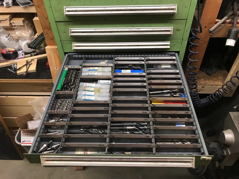

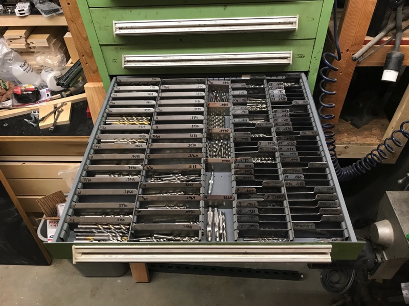

Next to it is a pair of Lista tool cabinets stacked. Only 6 of the drawers have tools in them and the rest are stuffed with nuts, bolts, consumables, materials, etc. Great cabinets, drawer slides are super strong but not very smooth, and the drawers are the size they are. If it were up to me, the deeper ones would be less deep. Here’s some of the more recognizable drawers from my earlier thread. First is my end-mill drawer with HDPE trays.

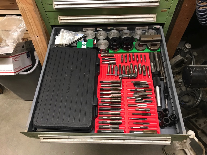

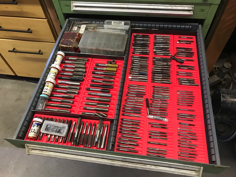

Using HDPE to keep the drawer of taps organized. Note the orientation of the trays. If the tap grooves are parallel to the drawer slides (like they are in the end mill trays above), the open and closing motion will actually make the tools work their way out of the grooves. If you run them perpendicular, they stay put exactly where you leave them. I'm sure some of you have noticed that in the picture above I don’t take my own advice on the end-mills…that’s because the size I cut the trays isn’t conducive to rotating them and getting everything back in the drawer.
Large taps, dimple dies, and some parts for my mill. I can't tell you how long it's been since I've not had the tap I've needed while doing something. I can't say I have every size but...I might be able to say I have most every size I could ever need.

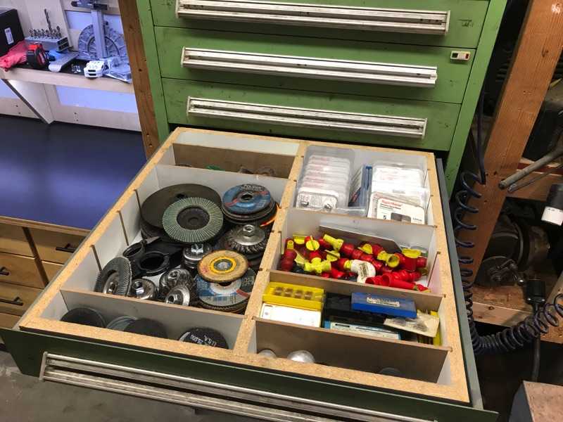

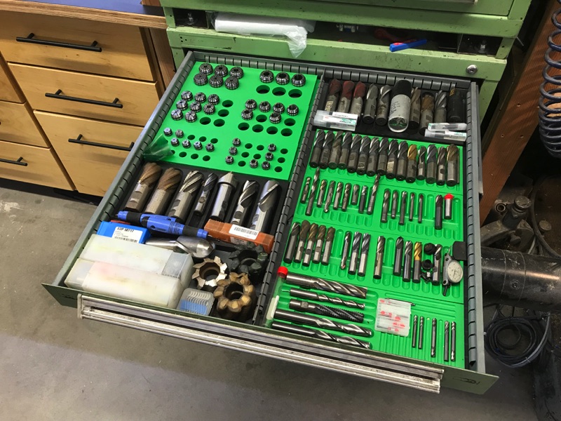

The Lista cabinets I got only came with the main divider rails but didn't include any of the divider cards. I made them out of 16ga steel on my plasma table about 14 years ago so I could divide all my drills by size. Sizes range from dental floss sized to 1 1/2-inch big-ins.
For some of the drawers I made inserts out of scrap left over from the drawer bases to help better organize the contents. Worked but isn't flashy at all but gets the job done. The reason I resorted to this franked-box is that I didn't have any main drawer dividers left after completing the drill drawers. Someday I might look for more on eBay but, to be honest, what i have works fine so i might not.
If I had it my way I'd have much more of the shallow depth drawers in the lista cabinet so I could store more tools in them. At some point I might just sell them off and build my own tooling cabinet so I can have exactly what I want. Since it's not on the up coming list, it's gonna have to wait 'till later.
