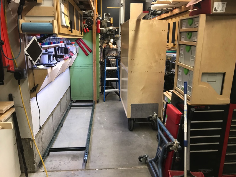

New Workbench Build

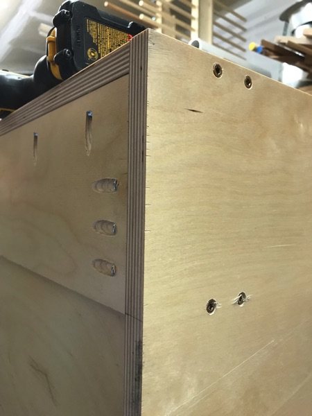

In the past 4 years I’ve learned a thing or two about building cabinets. Even though melamine has been good to me (meaning it hasn’t yet failed me), It’s not the strongest for cabinet assemblies. The previous bench utilized unfinished baltic birch for the face frames and the drawers. To finish, it took me about a month to apply 3 coats of poly (spray, scuff, spray, stuff, spray) on both sides of the drawers and a single side of the face frame spraying sometimes 2-3 times per day and many times per day on the weekends.
This go around I'm going to apply what I've learned and build the boxes out of pre-finished baltic birch. This pre-finished material comes from the supplier with a fairly durable UV stable clear coat that has a much nicer finish that what I'm able to spray myself in the garage and it only costs $10-$20 more per sheet depending on where you get it and if you get a break on quantity. I've only been able to find 2 places that sell it in town but they regularly have on hand so there's no need to order it in advance. The only downside to using it is it requires careful handling during machining (or it looks like junk when you're done). For the price difference, I have no issue slowing down to go MUCH faster.

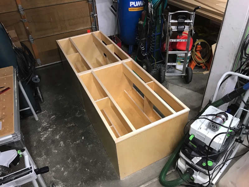

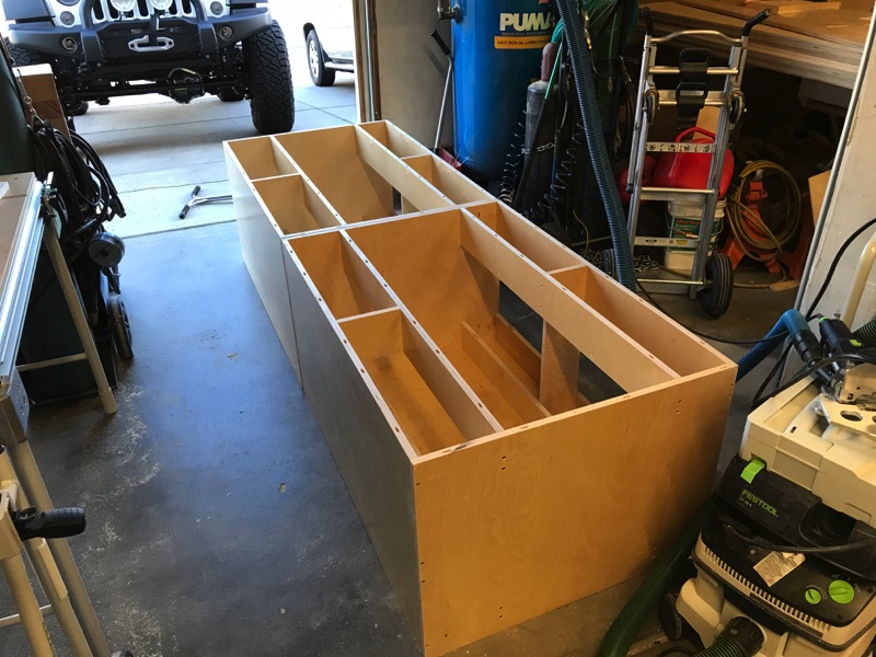

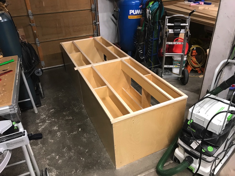

I really really wanted to get the main boxes built this weekend so I didn't slow down to take pictures until I had the main assemblies pieced together. I apologize however I promise that once you've seen me break down a sheet of ply, you've seen it...fast forward...the two boxes, a total of 8'2" long, are laying on their back machined and ready for the face frames.
Orientation-wise, you can see the bottom in this picture. These assemblies are designed to have some fairly wide drawers so they can hold tools that I never had a dream of storing in my old bench (e.g. 36" long impact extensions).
On the old bench I used remnant pieces of the baltic birch cut into thin strips for the face frames and attached them using brad nails. This cause me to spend time patching holes and sanding before I could finish. Since I have a few dozen feet of white maple left over from the kids closet builds I decided I'd use that up. It being hardwood makes it a better choice for shop cabinets anyway because it can take more abuse.
The face frames are hall hand fitted pieces. I cut the verticals so they run a little long top and bottom and then hand fit the rest by measuring and cutting the smaller pieces one at a time. I'll do a more comprehensive breakdown when I feel like I have more time, like when I build the uppers.
Once i have everything fit, I mark and trim the verticals to be flush top and bottom. I do it this way because it allows me to hide slight imperfections in the boards (like if one is 1/16th narrower) by cutting them point to point instead of 90* to length...if that makes sense.
The conventional face frame would be held together as a single assembly using pocket screws which would require me to mark all of the intersections and pocket hole screw the thing together on a large assembly table. I did that for my first two cabinets but, since then, have done it a little differently. I, instead, leave all individual pieces floating so I can remove them, refinish them, and/or replace them later individually if necessary. Then I attach each one using pocket screws which, along with the dominos, prevents it from moving. This allows me to color change or repair my cabinets easily down the road. The cabinetmaker probably cringes...I’ve had no issues to date so no evidence that the face frames actually need to be one assembly. Again I'll go into better detail when I build the uppers.

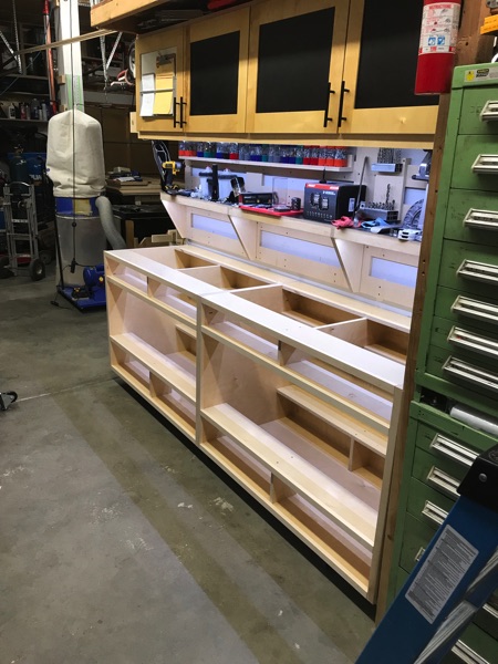

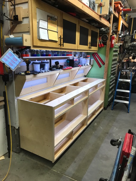

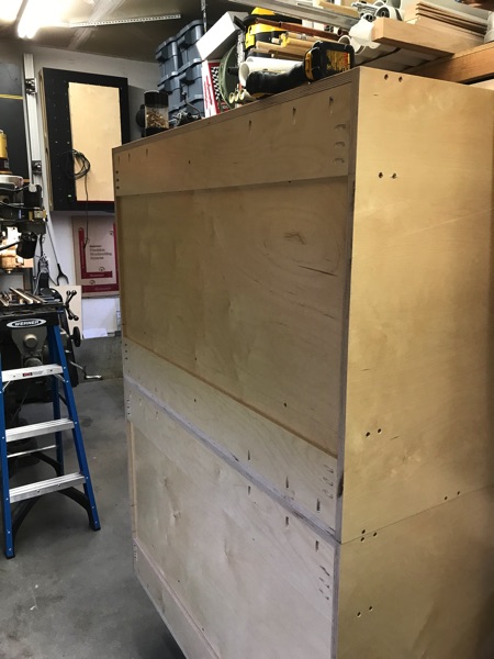

With the face frames complete, I then moved the cabinet assemblies over to the new location in preparation for install using this conversion hand truck/dolly.

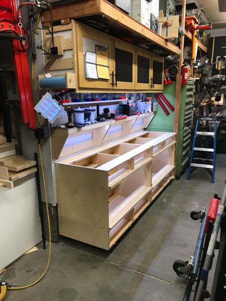

Before installing them, I need to add rear nailer boards. Here’s another notable difference in these cabinets over the old ones. The back have a 1/4-inch thick back panel and I add 5 1/2-inch wide nailers to the top and the bottom. When attached with pocket screws, these nailers serve three purposes - (1) they add a substantial amount of strength to the cabinet. (2) They provide a strong way to attach the cabinet to the wall. (3) they push the back panel forward solidly into the groove so, from the inside, the panel appears to have zero reveal.
Took me all weekend to get to this point...dropping them in place.
It's fun to see a pile of ply turn into something like this in a weekend and to think that all of the flat surfaces already have clear coat on them! I'd bet I build this one in 10th the time. Kinda wished I'd timed myself on the previous one.

Sawdustmaker said:
Dovetails in front of drawers for strength. Was told that staples in back are OK as there isn't as much stress there. Watch Norm Abrams make a set that way once on TV. He actually used a finish nailer and glue on the back.If it's good enough for him, then I'm OK with it.
Was this how the rear of the drawer looked? The bottom gets inserted form the rear and them stapled flush to the back?
Yup, that's how he did it. What I've done in the past (using pocket holes) is install the back so that it also captures the bottom of the drawer, and install screws from the side. When I built my pullouts in the kitchen my pocket holes were on the sides. Screws went into front and back. The holes do show, but the slide pretty much covers them, so nobody has noticed. Built them 8 years ago. Three of them are carrying quite a bit of weight and are holding up well. Used 100 lb full extension slides for the pantry and the lighter weight Blum slides for the others (pots & pans, etc).
If I get a chance later today, I'll get a pic and attach. Busy around the house today. On a short break right now.:)
Got a chance to snap some pics. The material is 5/8" baltic birch. Drawer bottom in the pantry is 1/4" ply, drawer bottom for pots & pans is 1/4" hardboard. Yes, I know they are unfinished and probably should have put the pocket holes on the inside. This was my first project with pocket holes (10 years ago now that I recall). I was under the gun with the wife "urging" me on and with a daughter's wedding coming up (in Hawaii). When I installed them my wife even commented, "They aren't finished". I said, "I'll do it later". Well later is now, so another facet to the kitched project. Doors are done, now drawers, then paint and finish.

Drawers for the New Bench
With the main bench box assembly completed, it’s time to move on to the drawers but first I slide the top back on the cabinets so I can use the space for assembly. The drawers take much longer to machine and assemble than the main cabinet boxes. The drawers are multi-process and, in many cases, I have to switch between setups to build a complete one. As a result, it’s fairly easy for me to screw up by simply referencing of the wrong edge on one of the operations thus making a bunch of firewood quickly.
Here’s my process for building drawers: Rip sheets to width on the table saw, Machine the dado for the drawer bottom, cut them to length on the miter saw, cut domino (mortise and tenons to aid in assembly), cut the pocket hole screws, rip the bottom on the table saw, cut the bottom to final length with the track saw, and then assemble. Once all the machines are setup, the process goes fairly quickly. Here’s some of the drawer fronts and the backs.
The trick is to not get things backwards between operations. After a few screw ups I decided to make some fixtures to help make sure that I have reference marks to help me keep things straight.
First drawer sometimes requires a little tweaking to get all of the parts to fit right but after all of the measurements are dialed in, all can be slammed together, drawer slides installed in the bases, and drawers loaded in place. This gives you an idea of what a 24-inch deep drawer projects like into the shop.
Now l have a place to keep my tools during the remainder of the build process. It’s nice being able to put things away in between operations.
4 drawers down and what feels like 100 to go. This is how I decided to leave it Saturday night. Felt kinda deflated but it was nice to have a few drawers that are actually usable. Before I went inside I rummaged through my cabinet materials and found a couple more sets of slides but that leaves me about 15 pairs short for this cabinet. Guess Installation will have to wait until next week.
Sunday was a rough day. I knew I had a mess of drawers to build and it's really cold here right now so I feel kinda slow (my hands especially). Yesterday I was only able to build 4 drawers and pre-cut another few. I stood there looking at the mountain before me without interest until the coffee kicked in. It was then that I noticed something I hadn't seen before in the drawing or all of the times I've walked past the cabinet since it was installed. I realized that if I had full width drawers on the left side of the base I’d have to build complex dividers in the drawers themselves to enable the kind of organization that I wanted to have. Since many of my organizers were coming from a 26x18 craftsman box, I realized I had an opportunity to make things easy on myself if I were to make drawers that were close in size so the organizers could damn near be a drop-in fit. After pulling the tape on the craftsman boxes I realized that the insides of the drawers were nearly exactly the same width-wise as the drawers I was building depth-wise. That mean that I needed to add a divider to the mid-section of this box that allowed me to have drawers that were ~16 1/2-inches wide (inside dimensions). If the internal dimensions need to be 16 1/2 inches then, to figure the width of the hole I need to add to that 2 x the drawer slides and 2 x the drawer sides.
