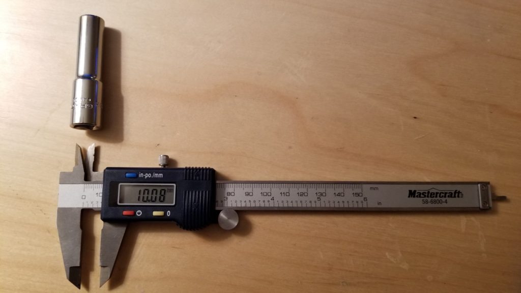

I thought it would be fun if we used our digital calipers to check the tolerance of different socket brands. Using 10mm as the baseline as its a very common size.
I'll start:

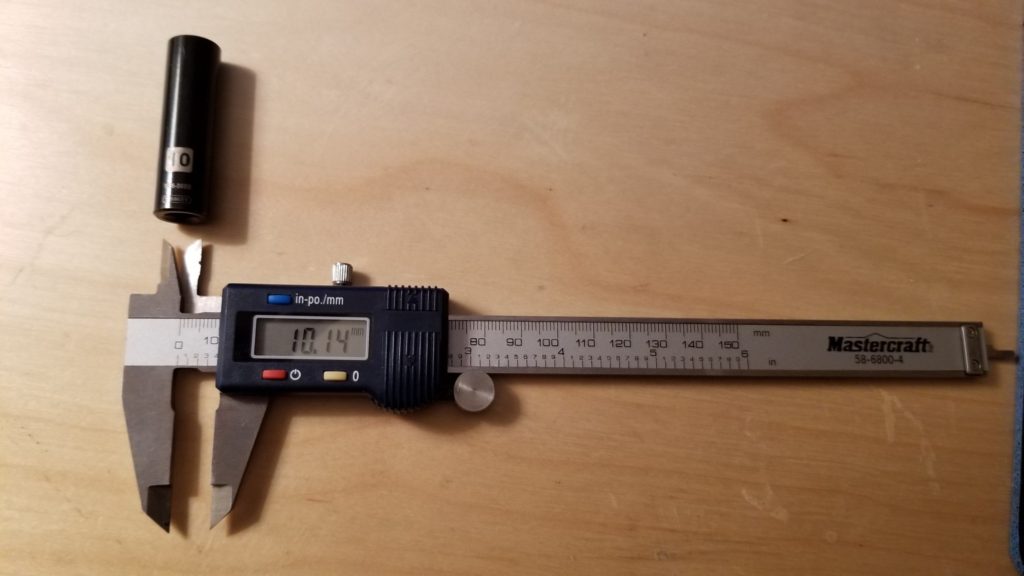

Stanley W86-098B: 10.14mm Measured by Noid
Gray (Canada) MTL10H: 10.08mm Measured by Noid
Koken 3800MZ: 10.04mm Measured by Negen
Koken 3400MZ: 10.04mm Measured by Negen

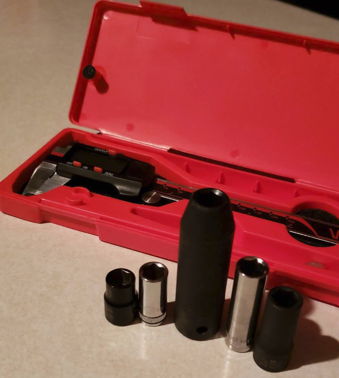

Results without pictures:
Astro Pneumatic 10mm Brake bleeder socket 12pt - 10.31mm Measured by Negen

Gray (Canada) 3/8" MTL10H - 10.08mm Measured by Noid

Stanley W86-098B 1/4" - 10.14mm Measured by Noid

If you see your sockets in the list, please still measure them so we have a bigger data set!
I will add in Koken and Blue point at a later time from my collection.
To keep things consistent remember to use the inside measurement arms, measure middle of flat to flat and measure then slide the arms out to record the number as to stay consistent for pressure. If the number changes as you're sliding it out, measure again.
