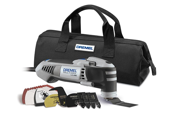

So I have a project coming up that requires a multi-tool. Whenever I need a new tool, my first thought is to just buy the best. And in this case, I think most folks consi...

I don't do a lot of home improvement repair stuff... and it seems like most of the utility for this thing is there? Hell if I know... I've never owned one.
If I get to where this thing is used a **** load and it doesn't perform, I'll go with a Bosch or Fein. I just really didn't want to spend that dough.
Stuey, where are you finding the German offerings for $150? I would have jumped on that prolly...
Still, I'm REALLY surprised about how nice this Dremel is. Have they been stepping up their game lately or is this just a one hit wonder of sorts?

I have had this same Dremel MM45 for the past 3 years and I am impressed so far. It’s lasted through 2 bathroom remodels with no issues.
