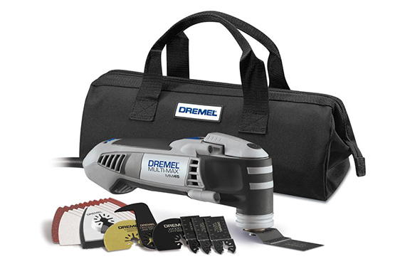

A Decent/Affordable Multi-Tool
So I have a project coming up that requires a multi-tool. Whenever I need a new tool, my first thought is to just buy the best. And in this case, I think most folks consider the Fein Supercut to be the best in the market. The thing is though, I don’t think a multi-tool is something I’m gonna use on the regular and spending $400 on an occasional is not something I’m prone to do.
So then, I went down the line… The Bosch uses the same starlock blades and gets good reviews, but again the price scared me away. I’m in the Milwaukee cordless ecosystem, so I checked out their offerings and heard mixed reviews about their performance and rumors of an upcoming tool update… and who wants to buy a new, old tool?
I got frustrated and decided to look at “one-time” tools – something I RARELY do and NEVER advise. Harbor Freight just isn’t an option to my sensibilities, so I just went down to Home Depot and bought the Dremel MM45 which was on special for $115.
To be honest, I’ve never been all that impressed with Dremel branded tools. I’ve had a number of their rotary offerings and none of them have ever struck me as being particularly well made. I didn’t expect the MM45 to be much different.
I was wrong. This thing is actually pretty great given it’s price. It feels as though it is made far better than any Dremel tool I’ve ever owned, fits nicely in the hand, cuts quick as hell, and isn’t all that loud.
I’m certainly not all that knowledgeable about the multi-tool market, but I recommend this thing for sure. It’s great for a guy that doesn’t want to spend a fortune on a tool he isn’t likely to use more than a couple of times a year, but still wants something that can be relied on past a single project.
I looked online for better pricing and couldn’t find anyone else selling the MM45. Given that, it must be a Home Depot exclusive? I dunno… But you can get yours here.

Hey Ryan, congrats on entering the oscillating multi tool club. You think it will be an occasional use thing, but you will quickly find out it will become your new favorite tool. I bought a refurbished Fein tool probably 10 years ago before everyone made one. I have used it on many wood working projects, plumbing jobs and find it works just as well working on the cars. You purchased the correct tool by choosing the more universal flat blade type. The manufacturers know the real money is in the consumables, so by bypassing the "star" style Fein tool you can use generic blades and cool specialized tools from other manufacturers.
Profile sander kit by Fein. It should work with your Dremel. Takes the tedium from sanding inset door trim, elaborate moldings or intricate car parts. The flat triangle sanding pad is super handy too.
Removing grout from your bath or kitchen floor? Purchase the many versions of diamond impregnated blades. Then build an enclosed sanding box with light from a plastic shoe box to attach to your shop vac. (details in this post https://www.garagejournal.com/forum/showthread.php?t=337292
Wear your ear protection. This is a noisy job!
Don't discount the scraper blade that comes with so many assortment kits. You will say to yourself "I am just going to use a regular putty knife, why would I get out my oscillating tool to scrape paint or putty". I use it most successfully when working in an older house wanting to re-wire or access something in the wall. Using the oscillating tool I cut the caulked baseboard joint with the putty knife attachment. 20 ft. can be completed in 2 minutes. Then switch blades to something long and metal nail compatible. Gently pry the baseboard and cut the nails. You create almost no dust and do not damage the walls requiring a repaint.
I could go on and on of the many unique uses I have used it for. My ideal setup would be small size, light weight. Off / on switch with speed control. 15 ft. long cord. LED light at cutting point when on. Hard case with cord wrap and large compartment to hold all the blades and accessories.
Enjoy your new purchase...

I think you made a good choice.
If you were asking, I would have recommended the Bosch or Fein StarLock tools, which are kitted for $150-200. But for the money, the Dremel is good.
There's also the MM40, which is a little less powerful than the MM45, which is only available at certain retailers (such as HD).

I don't do a lot of home improvement repair stuff... and it seems like most of the utility for this thing is there? Hell if I know... I've never owned one.
If I get to where this thing is used a **** load and it doesn't perform, I'll go with a Bosch or Fein. I just really didn't want to spend that dough.
Stuey, where are you finding the German offerings for $150? I would have jumped on that prolly...
Still, I'm REALLY surprised about how nice this Dremel is. Have they been stepping up their game lately or is this just a one hit wonder of sorts?

Dremel is owned by Bosch, so the engineering is certainly there. You got an excellent tool, and one that has a wider range of blade compatibility than most.
For my part, I don't use the multi-tool much, mainly because the noise offends me. But for some jobs, it is simply indispensable. Because mine sits in the drawer for sometimes over a year at a stretch, I chose corded.
BTW, yes, the scraper is one of the best uses of this tool.

I got to try the Dremel and the Fein side-by-side on one project. I decided that if I a going to use the tool for hour or more at one time or just prefer a high quality tool then the Fein is the choice. For a quick or dirty job, I often bring or use the Dremel in the shop.
Started with the same Dremel multi tool on a bathroom tile re-grout. Removing existing grout is very messy. The Dremel worked well and I wasn't concerned if the grout dust destroyed the inexpensive Dremel tool. Later, while at Home Depot I happened to find a like new FEIN muilt tool returned item for sale. It was about $150. Taking it home, I then used both tools at the same time and noted these differences:
1. Fein was a quieter tool. Some may not consider this a concern but it is when working in a small room and the noise is deafening and at least annoying with ear muffs. Also the occupants of the home appreciate not having to hear a very loud tool running for hours at a time. The tone of the noise is better as well. Not a high pitched whine like the Dremel.
2. Fein transfers a lot less vibration to the hand. Again it matters when holding and positioning the tool. The tool feels better and you feel you have greater control of the cuts and motion.
3. Tool blade changes were easier on the Fein with StarLock.
4. The Fein electrical cord was much longer so I didn't need a bulky extension cord.
5. Dremel blades and others that fit are less expensive and variety is better than Fein.
6. I can find Dremel blades anywhere. So if I break a blade and do not have a replacement with me, I can get a new Dremel blade nearby. Not so with the Fein starlock.

Bosch or Fein, with the Starlock blades.
Quieter.
Less vibration into your hands.
Tool-free, fast and easy blade changes. You don't even have to touch the old (possibly hot) blade, just flip the vlade change lever and the old blade pops right off of the blade holder/clamp. If you have the replacement blade sitting on a flat surface before you start, the whole process of ejecting the old blade and installing the new one is about 3-4 seconds without rushing at all.
Have a HF OMT. Single speed . IIRC, I got it 'on sale' for $10-$15. Super loud, vibrates your hands to the point of numbness with 10 minutes or so, blade seems to wiggle around (pivot around the center mounting screw), you need 3 hands AND a hex key to change blades. I almost never used it unless there was no other way to do the task.
Got a Bosch OMT STARLOCK-PLUS version. It is sooooo much nicer to use, that I actually do use it. :lol:
YMMV and all that.
