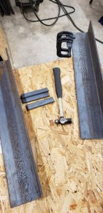

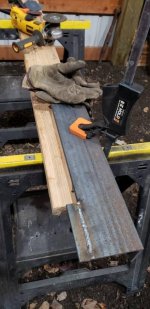

So, as I finished the first couple of sections of wall, I decided to finally get around to setting up some shelving that I acquired at a "bargain price". The reason it was a bargain was that there were some 4' long horizontal rails... and a metric ton of 8 footers. Perfect if I had room to build 4' x 8' shelving, but I dont have room for something that big! So, the solution was to cut the 8' rails into 2' long pieces and install "rivets" in the ends. Actually, we were going to build some shelving the same way at my previous job so I made a couple of pounds of the rivets on the cnc turning center. We ultimately decided against using the shelving at work so I bought it.
So, after cutting the rails to length, I had to cut 45° relief on the back of the rails to allow them to meet at the corners. Then, lay out and drill the clearance holes for the rivets.
I had also made a tool to set the rivets from 416 ss. It was heat treated and ready to go. But, before I really got to work on the shelving, I needed a stand for my anvil... so I didn't have to set all those rivets while kneeling on the floor... lol20190102_164515.jpg20190102_180725.jpg20190106_132222.jpg20190106_125940.jpg20190106_123457.jpg20190106_124013.jpg20190114_172127.jpg20190303_160055.jpg

The last time I was in the big city, I stopped by a metal supplier/fab shop and dropped off a print. I need a stand for my box/pan brake and, although I normally do everything the hardest way possible, I decided to have them shear and bend the parts I need to build the stand. Late Friday, they called and said my parts were ready. Long story short, tomorrow is the day I want to pick them up. Since it's a bit of a drive, I try to accomplish as much as possible when I make the trip.
While I was still working, our shop had a "parts washer"... which is a bit of a stretch... the pump was shot so it was essentially a tub on legs that held cleaning solvent. But, it was a nice tub. In a move that was completely out of character, one day, my boss decided that we needed an actual parts washer and went to H. F. and bought one. So, the tub needed to go away... I bought it for a very reasonable price. I've had no shortage of other things to do, so this job got put on the waaaay back burner. For a while now, I've wanted to get this thing up and running. And I've even watched a few you tube "experts", a few of which actually have some very good ideas for improving parts washers. One of the improvements is to add casters. I was somewhat on the fence with this initially but, after thinking about it, decided it could work.
I'm over 6' tall so one of my objections to most work benches, tables, blast cabinets, parts washers, etc is having to stay in a crouched over position for hours on end while I'm working on things. So, adding longer legs to the tub was definitely on the list. A while back, I had the same steel supplier cut and bend some longer legs from 10 gauge... which also solves the problem resulting from the original legs being made from metal almost as thick as a recycled beer can. Those have been on my shelf since I picked them up because I've been pondering the caster issue. I FINALLY came up with a plan. One reason I've been a bit hesitant with the caster issue is because of the somewhat smallish "wheel base". I could just imagine trying to wheel the washer filled with solvent somewhere and for reasons unknown, the thing topples over spilling gallons of solvent on the floor. After thinking about it for a while, I settled on a way to increase the footprint of the washer. So, I broke out the band saw and welder and started making parts. The push is to have them ready to take with me tomorrow... to drop off for powder coat. To allow the swiveling casters to rotate 360°, I needed to add a bit of steel. I got the parts cut, hot-glue together and cleaned up this evening... will get holes drilled in the morning.
Not a lot of in progress pics... not too exciting to see a hunk of steel on a band saw and I'm not nearly talented enough to snap a pic while I weld. Anyways, will have some assembly pics once I pick these parts up from powder coat.
I took the parts out to the "unfinished" bay of the garage to do the grinding and cleanup... don't need to be quite so concerned about where the sparks are flying.20200217_164452.jpg20200217_181723.jpg
