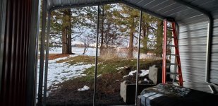

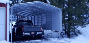

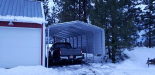

Finally, on Friday, got a bit more done on the carport.
The idea behind the VersaTube structure is that the metal wraps over the roof and some distance (depending on the width of the building) down the sides to provide rigidity to the structure. My building is 14' wide... the metal wraps about 3' or so down the sides. As my neighbor and I started installing the tin, it occurred to both of us that it would probably be a bad idea to run the tin 3' down the side adjacent to the garage... because it would trap ice and snow between the two walls and cause who-knows-what kinds of problems.
So, we agreed it was probably a better idea to omit the overhang on the garage side of the structure. The carport seems sturdy enough and is pretty much sheltered from prevailing breezes by the garage... and, we definitely don't get Wyoming type "breezes" here... I'm thinking everything will be fine.
As a result of our modified install, I ended up with three extra sheets of tin. My misses gave me a hand and we installed those sheets below the ones on the east side of the carport. As luck would have it, I can install one more course of tin on this wall and, without having to cut anything, the tin will cover the wall down to ground level.
And, as I mentioned earlier, I bought the kit to enclose the far end of the carport. As soon as it gets light this morning, I'll go out and get that framework installed and ready for tin.
