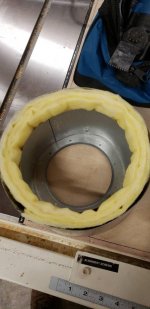

I made the improved version of the wall thimble from 20 ga. galvi so I'm not concerned about corrosion... the area where I cleaned up the weld was relatively minor... so I just cleaned the steel with acetone and sprayed. No primer. I've used the Rustoleum hammered paint both with primer (Rustoleum red oxide) and without and have had excellent results both ways. The paint is very durable. I apply it fairly heavy, I like the hammered effect.

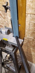

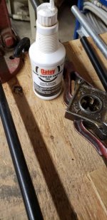

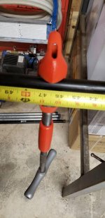

Here are the tools I use to cut and thread pipe. Yep, there are motorized versions but (a) they're expensive and I dont do enough of this to justify the expense and (b) I get a certain satisfaction from working with hand tools. Hmmm... sort of like machining... I ran cnc machines for years and they do have their place but, given the choice, I'll use manual machines any day. But, I digress...
I'll take a few minutes to explain the process for any of you who haven't worked with pipe. For those who have, feel free to skip ahead... lol.
The first thing I do is position a couple of fittings and measure between them to determine the length of pipe I need to cut. I measure to the outside of the raised "flanges" on the fittings. The pipe I'm using is commonly referred to as "black iron" pipe, although it's actually made of steel. Point being, you cant use galvanized pipe for gas lines. The line I'm running is 1/2" diameter. I take the dimension I've measured and add 1" to it to allow for the amount that threads into each fitting... approximately 1/2" per side with 1/2" pipe. Then, using the pipe cutter, cut the pipe to length. Once cut, I take the pipe to the belt sander (Kalamazoo 2" x 48") and slightly chamfer the end. This makes it easier for the die to grab hold. I like these "zero flute" countersinks... they give a nice clean cut with no chatter. Keep rpms low and use good feed pressure. We just need to remove the debris and any rough edges on the ID of the pipe by creating a slight chamfer. Now, the pipe is ready to thread.20200219_181856.jpg20200219_174831.jpg20200219_175825.jpg20200219_171347.jpg20200219_171547.jpg20200219_171612.jpg20200219_171706.jpg

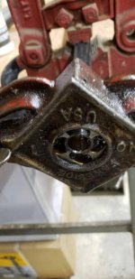

So, I grab my vintage die stock, complete with the new die I recently bought... and the OIL. When I first got into machining, an old machinist told me "people think these machines run on electricity and that's not entirely true... they run on oil." Same with thread cutting tools... they run on oil... lots of it. So... put a good amount of oil on each segment of the die... and a bit on the pipe for good measure. I'll just mention that it really helps to have something on the floor thats impervious to oil before you start this operation... it gets messy! Then, start turning the die stock... righty tighty... I normally stop after each half-turn and back the die stock off about a quarter turn to break the chip. Then, back to cutting... breaking the chip every half-turn. Once you've cut the thread about half way, it's a good idea to turn the die stock all the way off the pipe... to clear all the chips from the cutter and... to add more oil. Use care when restarting the die on the pipe... make sure you "pick up" the thread. Keep cutting until you can see the pipe/threads in the end of the die. You're done! I clean the threads with a wire brush and wipe the oil from the pipe and threads with a rag. Careful! The threads are SHARP! Next, I use a "store bought" fitting to check the threads. Then, coat the threads with pipe thread sealant and assemble. Tighten with a pipe wrench. Then, on to the next one.
Pipe "*******" under 12" in length are available in 1/2" increments and aren't terribly expensive. Saves a lot of work!
I think I only need to cut and thread one more length of pipe tomorrow to finish this portion of the install. Then, I'll connect the propane cylinders.

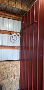

I actually finished with the gas supply line today! One thing I needed to figure out was how to locate the hole on the outside of the building for the gas line. So, I measured the center line (above the girt) of the fitting I needed to connect and drilled that dimension into a scrap of 2x material.
The idea is that the "guide block" would slip behind the post and into the corner while holding the pilot drill at the correct height above the girt. Worked like a charm!
Then, I took my hole saw outside and quickly cut the hole for the pipe.
A few minutes later and the final joint inside the building was complete.
Another quick cut and thread job and the supply line was complete outside the building where the propane cylinders will live.

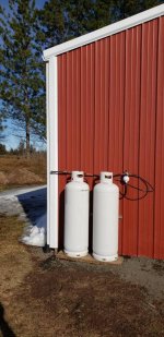

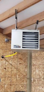

I actually didn't get to work in my shop yesterday. Had to go to the big city... my misses had been away visiting family and I had to pick her up at the airport. And, I was able pick up the remaining few odd bits I needed to FINALLY finish the install of the heater.
Busy day today. Ryan, one of the service techs from the local propane company, showed up this morning at 8:30. Ordinarily, this wouldn't have too big of a deal... but I had a few things to get done before he arrived. So, my day began at 5:30.
A couple days ago, after I finished running the iron pipe for the gas supply, I built a device to pressurize the line and installed a gauge. Pumped the pressure to 35 psi. Checked this morning, still at 35 psi... so I'm pretty sure we can call that good! So, I removed the gauge and pressure cap and installed the flexible supply line between the ridgid plumbing and the heater. Also, wired up the thermostat. And, although I had run the wiring to the service panel, I hadn't actually connected it. That done, I went outside and installed the supply line from the regulator to the ridgid line. Just as Ryan drove up, I was starting on the propane conversion on the heater. Ryan was actually at our place to replace the regulators on our home system. They were well beyond the recommended replacement date. As Ryan was working on replacing the regs, I completed the conversion. It was actually pretty straight forward. I had to remove and replace the orifices in the burner assembly and replace some parts in the gas valve. We both finished our respective tasks at about the same time. Ryan connected a manometer to the gas valve on the heater and we fired it up. Much to my surprise, the reading was very close to the manufacturer's recommendation... close enough that no adjustment was needed.
So, after about 3 hours of steadily running, the heater brought the shop from 34° to 62°... WE HAVE HEAT!!
My shop is a bit under 1,200 s/f but, I have a high ceiling/loft, so a lot of cubic feet... and, I have quite a bit of (cold) "iron" in my shop as well... a project truck, machinery, tools... etc... and, the concrete floor was cold as well. I thought 3 hours for that much of a temperature swing was actually pretty good. And, once everything inside warms up, I think it will be much more comfortable... today, I noticed "warm" and "cool" areas... depending on where I was standing. Humidity seemed pretty high as well. I'm sure, by morning, it will be very pleasant. As it was, a flannel shirt was comfortable... seemed nice not to need my Carhart and gloves while working... tomorrow should be even better!
Tomorrow's project will be to keep working on insulation and getting the walls closed up. Still have one light to wire in and need to run conduit for the 3 phase wiring for my lathe. Probably won't get all that done tomorrow but, should at least get more insulation... I'm liking this heat thing!20200227_141306.jpg20200227_132052.jpg20200227_141647.jpg20200227_141408.jpg20200227_175723.jpeg

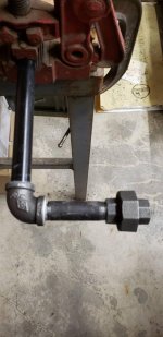

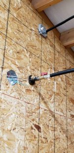

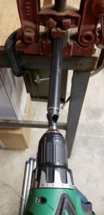

Hey Drives... I did get a few pics for you...
In the first pic, you can see the 1/2" line as it comes through the wall. The installation manual said to install a "T" with a 1/2" to 1/8" NPT reducing bushing to allow a manometer to be installed to check the gas flow. As it worked out, the maker of the gas valve inside the heater wanted the flow check to be done via a port on the valve itself... which made sense to me. But, I wasn't sure where the service tech would want to check it so, I installed the "T" and a 1/8" plug. (we actually ended up checking the flow at the valve) I then installed a ball valve to shut off the gas supply near the heater should the need ever arise. In the pic, the flexible gas line is installed into the valve. But, I did the pressure check before this line was installed...
In the second pic, you can see a "T" and the reducing bushing and plug. The space between that and the cap/valve stem assembly is where the shut off valve would be, with the cap/valve stem threaded into the valve.
In pics 3 and 4, you can see the way the bushing, plug and "pressurizing assembly" are configured. I had a pressure gauge (temporarily robbed from one of my air filter/regulators) with a 1/8" NPT thread so I removed the plug from the bushing and installed the gauge at that location. I used teflon tape to seal the threads on the brass fittings. After the test, I removed the gauge and reinstalled the plug.
The pressurizing assembly is just a black iron pipe cap drilled to accept a threaded valve stem. Since I was going into the female end of the shutoff valve, I needed a short pipe ****** to make up the connection. If you look closely, you'll see that the ****** is galvanized. This was used for the pressure test only and was removed from the system once the test was complete.
This set up worked really well... it was easy to use an air chuck and watch the gauge to achieve the desired pressure. Once the line was pressurized, I closed the shut off valve... effectively removing the valve stem from the equation. Because I got busy, this actually sat for 2 1/2 days... with not the slightest drop in pressure. As I mentioned, once I was satisfied the line was good, I removed the gauge and installed the plug in the bushing, then removed the "pressurization assembly" and installed the flexible line to the heater. I'll also mention that I had a second ball shut off valve installed outside the building near the propane cylinders. This allowed me to test the assembly from valve to valve. All the flexible connections are checked with a liquid "leak detector" under gas pressure only.
Installing the valve stem in the cap is pretty straight forward once the hole in the cap is drilled...
Drilling the hole was a minor adventure... the iron drills easily but, as the drill is breaking through, the iron gets a bit "grabby"... especially with the larger sized drills. I ended up holding the cap with Vise Grips... setting that on a scrap of wood on the floor... stepping on the 'grips to hold it with my foot and drilled it with a hand drill. Heck of a way to go about it, but it worked. I thought about different ways to clamp it onto my drill press but... expedience... decided I wasn't making a part to go on the space shuttle... let's just git 'r done!
I'm thinking you'll be using 3/4" pipe when you do your install (depending on the btu of your fireplace and the distance) but, if you want to borrow this pressure set up, I'll sure 'nuff send it to you!
HTH

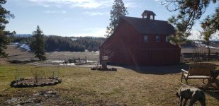

Couple more pics... if you're interested...
First one is coming home after checking the mail this afternoon
The rest are sunset pics off the back deck. Cant decide which one I like best. We dont often get a lot of "color" during sunrises/sets but, when we do, it can be spectacular.

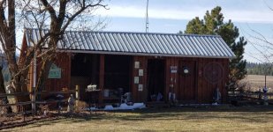

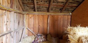

I'll do some barn pics tomorrow

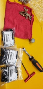

Today was the day! I grabbed an extension ladder and went for it. Things had melted enough that I didn't even have to set the base of the ladder on ice...
When I initially went up, I knew of a couple of screws that had been mis-driven because I could see them from inside. I quickly found them... driven at almost a 45° angle... because on the first try, they completely missed the purlin. The angle was necessary in hopes of hitting actual wood. I lucked out because, a while back, I mentioned I was doubling up my purlins out of concern for the heavy snows we usually get. I removed the screws, put dabs of 100% silicone in the screw hole and drove the screws straight down into new wood... got lucky on those two! The rest of the roof was a chore. I literally had the driver on every screw on the back side of the roof. About 3 hours worth. I didn't count but, pretty sure I replaced about 75 screws with longer ones to get purchase into the purlins. A few screws were never driven to the correct depth to begin with... which of course, leaked. Trying to tighten those screws only resulted them spinning in the holes. So, I removed them... applied the silicone and then drove in longer screws. That approach worked on all but a couple. For those, I siliconed and then had to "fish around" with the screw until I could find solid wood.
I found several screws from when the shop was first built that had missed going into a purlin... so, they just left those... and covered the errant screw with another one. Friggin brilliant... I've read things from others of you that share my sentiments... Whenever something needs attention, my misses usually says... "let's call someone" It's having to clean up shoddy workmanship like this that makes me never want to "call someone" again. To be fair, I had the propane guy out last week and he did a great job... had to have a guy out the next day to look at a room heater I know nothing about. Same thing... a great job at a fair price. But, I get really aggravated seeing the "work" done by a lot of the "pro's". When I would sight down the lines of screws in this roof the only thing that comes to mind is "S" curves. I dont really care if the screws line up perfectly straight but, when they veer off so far that a fairly significant number of them didn't even hit the purlin... inexcusable! I swear, I think the only thing on the minds of some of these guys as they're starting a new job is to HURRY UP and get this one finished so they can get paid and get on to the next (rush) job. I realize that if I was building for a living I'd probably starve to death but, there's just no way I could leave a job not done correctly. There was evidence that someone had been up there trying to fix leaks before... probably a call-back... but those efforts failed as well. Rant over...
I'm sure I solved all the leak issues for now... and that's a good thing. But, I'm sure I'll be back up there in a year or two trying to find the cure for some basic design flaws that will result in future leaks. But, I do have a plan!
All in all... a good day!

So, I thought I'd post a few pics from around our place. The original part of our house was built in 1911... the barns were probably built somewhere around that time frame as well. All are original timber framed buildings. At some point, this became a small cattle operation... I've cleaned a ton of manure and old, moldy feed from the oldest (looking) barn. There are remnants of an old milking parlor in the red barn and I think the smallest one may have been used for calves. There are still a few pieces of an alley way that led to a holding area but, we lose a bit more of that with each passing year.
The first pic, the oldest looking barn, is in fair condition... but, there are a couple of framing members that I will replace. Also, I will replace the roofing and siding but I haven't yet decided what I'll use. I like board and batten but some years, we have a heck of a time with wood peckers. This last summer wasn't so bad... just have to see.
The second pic is what I think was a calving shed... also timber framed. The previous owners did a complete renovation/addition to the house around 2004-2006... they did some resto work on this shed and the red barn at the same time. New board and batten siding (for some reason, the peckers dont seem to bother this one) and a "new" roof. The left side is a kennel... where we secure the dogs if we have to be gone for a bit... the center is where we store lawn/garden hand tools and the right side belongs to my misses... girl house don't ya know. Firewood around back... concrete floor, covered by the roof and enclosed by chain link. This was built as an outdoor run for the kennel but none of our dogs ever use it... it's perfect for firewood! We had 5 cords in it last fall... kindling and starting wood and still had room to move around.
The third pic, the red barn, is my favorite. It had extensive work done to it during the resto... the timber frame is in great shape, tongue and groove wooden floor in the main part of the barn. Two lofts and you can get into the crow's nest. The original track and hardware for a hoist is still in the peak of the roof... I've found enough hardware laying around to restore it completely... which I will do, once I find a lift to get me high enough in the ceiling to reach. The P.O.'s restored this to be "party central" and it would be well suited for that. My first thought was to put my wood shop in this barn but, the Commander in Chief thinks we should keep it as is for family gatherings... we're doing more and more of that. Also, thinking along the lines of Laine O's barn, I've thought about using it for weddings or functions... dunno... we'll see. We currently use it to store some excess machinery (woodworking... that I dont yet have a place for) the 4 wheeler, and lawn tractor and other power equipment.
Last pic is another view of our pond. The ice is finally starting to melt... we've been having some really nice weather... should have open water soon. And, that's a good thing... my misses wants ducks for her birthday. Should be interesting!

I forgot to mention... concerning the fastener order...
For sizes under 1/4", I have to buy the nuts from the fastener supplier. Sizes over 1/4", I buy by the pound from the farm store. I buy grade 5... have had good results with them. I'm not sure of the origins of theses"bulk" fastners... not sure I'd use them on anything really critical... but for most of what I do, HUGE savings! And, it makes it easy to have a supply in the drawer and ready when I need them.
